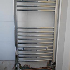

I am a woman with no knowledge of plumbing or tiling at all, but even I do realize that it is a messy job. And no matter how much I tried to live in denial I do realize that it is has to be started all over again.

He broke almost half a box of tiles and did not know how to fit it around the pipes. <br>Suddenly, he gave up and told me enough is enough. I can't handle it. I must go and you must pay me £250 from the £300 quoted.<br><br>His company is registered and is on google maps, as yet I did not write...
The angles, the dent in the copper pipe. Wondering how is he going to tile around it? Does the dent in the copper pipe makes it more fragile and may burst?
Towel radiator stages of fitting and unfinished job,<br><br>The plumber/tiler was contracted to do the pipes, fit the tiles and radiator.... <br><br>What is wrong with this scenario ?
