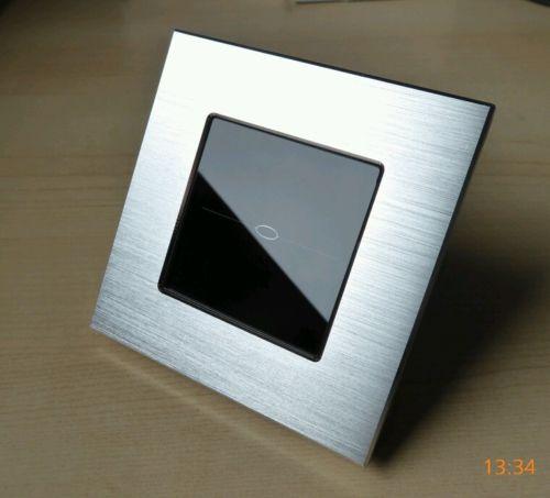

I'm thinking of buying a touch 1 gang 2 way dimmer switch with a normal rocker 2 way switch at the other end. I've asked the seller if it would work
but they said they're not electricians and don't know. Could anyone here tell me if this would work. Any info would be greatly appreciated because I really like these switches.
I've not purchased it yet, it's an Ebay sale, I would of thought a 2 way switch would work, no ??
Ask him to email you manufacturers instruction.
Not all dimmers are the same and some of the touch screen ones require neutrals connected at the switch.
Other sellers of that switch, such as this one state
Please note that I LumoS 2 Way Light Switches are only compatible with other I LumoS 2 Way Light Switches. They will not work when paired with a mechanical or non I LumoS 2 Way Light switches. I LumoS 2 Way Light switches can also be configured to work 3 Way.
If it is LUMOS, then the website says:
