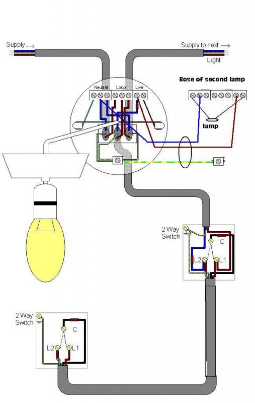

I cannot find the answer to this on the net, so I'm here bothering you guys. I am wiring a new lighting circuit from a new fuseboard (f/b) for a new apartment. I know how to wire a standard 'loop-in' lighting circuit with cables from the f/b to the ceiling rose, then from each rose down to individual switches. However I am unsure as to how the circuit works when it comes to introducing a 2-way landing light and hallway light both operated from a switch downstairs and another switch upstairs. This will be the start of the new circuit.
Any help most appreciated, a simple diagram would be brilliant.
Thank you.
S.

I cannot see a diagram with 2 lights operated from 2 different switches, I did check this first. Thank you for responding, maybe you could tell me which one?
S.
I am confused about two things:
1. What are you trying to do. Do you want to have a light in the hall another in the landing and for both of them can be switched from the hall or the landing. That means separate switches for each. (two gang, two way switches). or will both the hall and landing lights go on and off at the same time...??

Sorry I missed the bit about two lights.
The way I would wire it would be to wire one lamp as per the two way switching for single lamp and then using twin and earth connect the second lamp to the first lamp. Brown wire connects the switched live at the first lamp to the switched live at the second lamp, blue wire connecting the neutrals. Earth to earth terminals. No other connections or cables to the second lamp.
Confusion often happens when the ceiling rose for the second lamp has had live and neutral looped through it and then the connection is made to the ceiling rose of another lamp that also has the live and neutral looped through it.

Thank you that makes sense. I connect the additional ceiling rose (the one that only has one connection to it - as you describe) by connecting the neutral (brown sleeve) next to the pendant live on both ceiling roses. The live goes in the nearest 'loop' connection closest to the live neutral that i've just connected at both ends also. Connect earth at either end and DONE. Have I got the wires in the right holes?
S.
