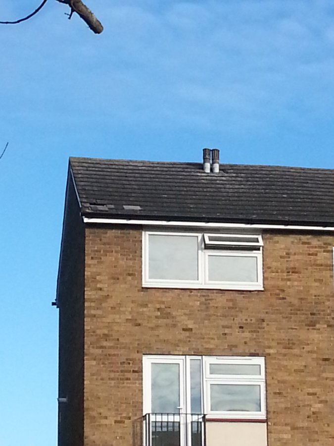

On slanting roof three tiles from gutter . I need a quick fix to prevent rain water coming in . It is directly over bedroom ceiling. I can access from inside of attic/roof . Rain is due before roof repairer. Tnx very much 4 any advice.

Tnx terry. Is the roof constructed in such a way that there is a waterproof layer below tiles then some internal layer facing lining the attic? Basically i am hoping water will not fall 90 degrees through missing tile area and onto bedroom ceiling below.
What tiles are they? Large or small or slate?
How old is the property and is the roof original?
If you have a relatively new roof then a layer of felt will be under the tile/slate and will hinder any ingress.
If there's no felt then there will be an ingress, how much depends on the type of tile/slate covering you have.
The worst place to have a broken tile/slate is at the bottom of a roof as the deluge is greater than higher up.
Tiles r small. 60s local authority property. Roof is original. Two storey high. Cannot see if there is felt or not. I hope so. Moved tile is close to gutter level. ( bad news)
If the tiles have moved into the gutter or are loose on the roof then its a matter of some urgency to at least have them removed - they could be picked up in a gust of wind and sail away.
Dont as a DIY'er go up in any wet or windy weather - pay an insured roofer.
Unless you have had exceptional conditions then what state is the rest of the roof in?
If you have a soffit, a missing tile by the gutter won't let any water into the bedroom
Terry tiles not the same. Cannot get pic just yet. I hope not too much ingress too. Council will send smeone round friday am. Pity rain will start thurs midnight.
Ree. Roof is in good overall condition. Tried best to inform council that tiles are dangerously positioned hence friday or else 1 week. Flat is private but ex local authority and service charge/ building ins is with them. Got kids living in flat below too and have to walk below too.

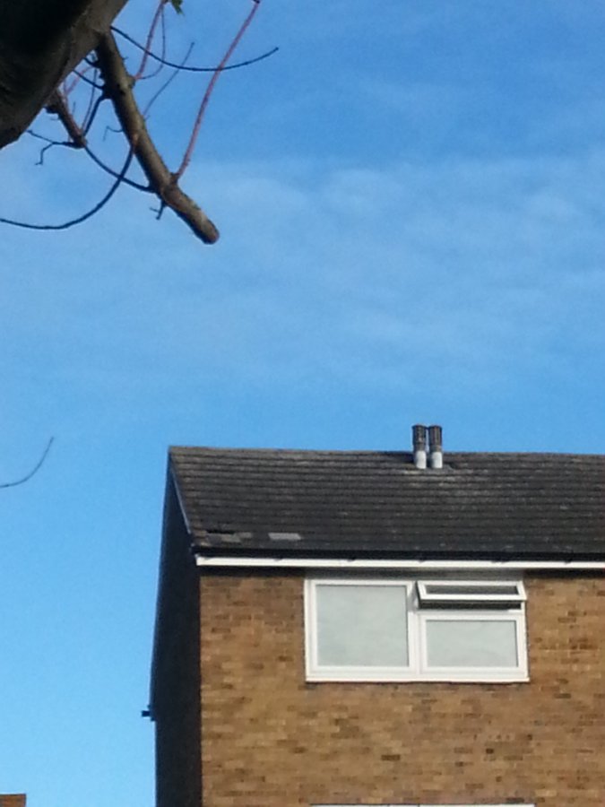

Pls see pics. It may even be 4 tiles missing. Worried.

Are you going to get up there and do the work? I'm not sure the point of this post if the work is the responsibility of the council.
It looks like it's a scaffold job in any case.
That's a quick repair, no scaffold needed If roofer will work without it(we would considering size of job and time needed)
I agree with woody, why are you concerned if council are doing it?
The council's method statement will say otherwise. No work on roof tiles off ladders - especially on what looks like a three or four storey.
Was thinking of doing something from the inside to limit water coming in until repair cud b done. Private contractor considered. Council sent smeone round after a lot of pressure after 2days. Was told need scaffolding that needed authorisation( told them that over phone). No dates for that nor when repair will be done. Praying for no rain or snow.
