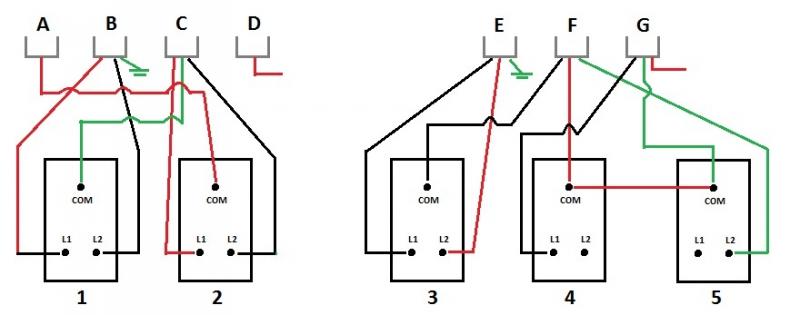

I am currently thinking about changing some lighting wiring (to implement some home automation). However, before I change anything, I want to make sure I know how everything works now. Most of the house wiring is self explanatory, but the 2-way wiring in the lounge is baffling to me (a mere mortal).
I have shown below the two light switches and their wiring below. As you will see the first switch is 2-gang and the second switch is 3-gang. For ease, I have numbered the switches. Switches 1 and 3 corrrectly control (in a 2-way pattern) one set of downlighters. Switches 2 and 4 correctly control (again in a 2-way pattern) another set of downlighters. Switch 5 corectly controls the conservatory light (just 1-way wiring).
Now, I am keen to understand if anyone can explain to me which of the lettered cables goes where (ie which cables(s) go to the consumer unit, which go to the lights, which wires are live, which are neutral and which go to the other switch).
You will see I have shown green wires. These (as far as I can tell) are the unsheathed earth wires in 2-core cable which has had red tape wrapped round it and used in the wiring of the switches. A new one on me!!! Where there are little red wires not attached to anything, these are just that - wires hanging around in the wall box with no connection.
Anyway, any help and pointers appreciated. Im hoping someone is looking forward to a little problem solving!!
Just to reiterate...these switches all do work correctly!!
Are you sure that you have drawn switch 4 correctly?
It's all a mess and using the cpc (earth) as live conductors is not allowed.
As nothing can be relied on to be as it should be without being there to test which wire is which I am not sure if it is worth deciphering.
It will need reconfiguring or rewiring.

Your wiring as it is looks extremely dangerous. CPC's (the bare earth wires) must NEVER be used as a live conductor.
The fact you have some wired as such, plus missing earth continuity plus wires floating around in the box adds up to a potential shock risk.
You need the lighting rewiring. Chances are if it's like this in the lounge, it might be the same around the house.

without being there to test, we cannot say what connects to where. We can make an educated guess based on standard wiring configurations for 2 way switching, but it appears as though your lighting wiring is possibly not standard and so to make an educated guess or advise you would be tantamount to negligence.
Switch 4 as already stated looks dodgy - it appears as though there are 2 wires in the common terminal, and im not quite sure which of these will be live.

Firstly, bhm1712 - there is absolutely no reason for me to deceive you and accusing me of lying is completely unnecessary. I have every intention of getting a professional to install my home automation modules. I have an electrician that has done many jobs for me and in fact is at my house, as I type, installing some outdoor christmas lights. If I deemed it in any way appropriate, I could post his name, his firm's name and his mobile, but what's the point!?
I am looking to spend significant sums of money on home automation equipment. Before I spend this money, I want to ensure it can do what I want. The modules in question are Fibaro FGD211 dimmer modules which sit between the wires to the light and the light switch. I am told it is possible to wire them to enable them to work with 2-way wired switches. In fact, I have been handed a wiring diagram by a vendor and wanted to check if the wiring behind my switches enables me to do this.
I *thought* this would be a simple confirmation and so decided to look myself. The reason for my post is because I didn't understand the wiring. But, I am not an electrician. For all I knew, it was a normal configuration but didnt make sense to me as I havent been trained. As it turns out, the situation is far more complex than I had any reason to believe it would be. What has become clear from everyone's posts is that this wiring is absolutely NOT standard and not only is not understandable but is potentially dangerous. As such, I will speak to my electrician this evening about doing an audit and rewiring when he is next available.

I perhaps worded several things incorrectly, I said possibly because i am unsure as to whether the diagram is concurrent with what is actually there, but as for the earths etc ....yes its wrong.
As for the switch 5 common having 2 cables i really shouldnt have commented because i really dont know whats going on. If switch 5 is operating a single lamp, then is the switch getting its permanent live from the green earth cable, or from the cable connected to switch 4 common? if this is the case, what is the green being used to feed?
