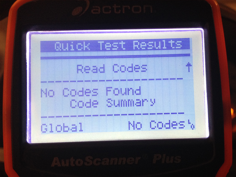

After a slight spray with WD-40 last night, it popped right out this morning. It was very dark and covered with varnish. I cleaned it and gently scuffed with 2000 grit sandpaper to polish it. Reinstalled and now the scanner shows now codes. Rav still won't start, however, the fuel pump is definitely running now. Made no sound at all before but clearly runs for a few seconds then goes quiet. May give the crank sensor a look as well before diving into the timing cover.

I ran the scanner again and it shows no codes.
What would get me back on the path to the problem? The fuel pump is fairly complex and holds the fuel filter and regulator...maybe I'll pull it and inspect for damage.

Seriously Mark, at this point I think I would bale out and call on the services of a good auto technician......the thing is, they may have seen all of this before, and have the experience to test each component rather than just replacing bit by bit.
Personally I would suspect the crank and cam sensors are out of sync but who knows.....
If the engine won't go, then any codes wouldn't necessarily show up. There's a world of difference between a DIY code reader and professional diagnostic gear - not least the cost!
