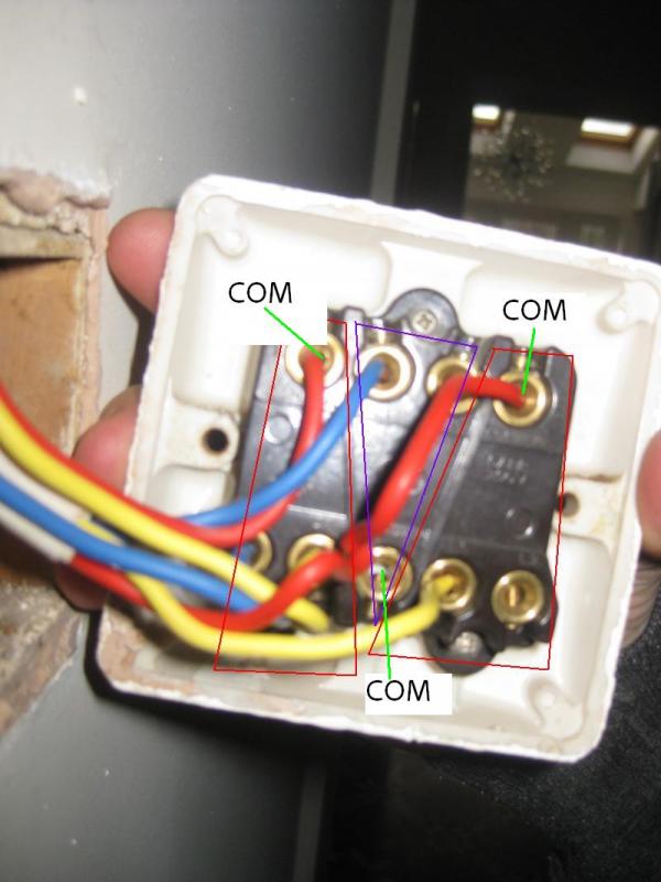

I need help rewiring a 3 gang 2 way light switch

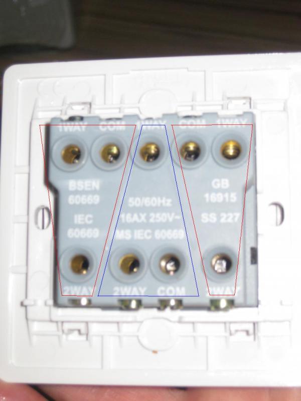

just got a new 3 gang 2 way switch from homebase and its nothing like the old one
there is 2 cables running into the old box as per below
top has 4 holes bottom has five holes
top is confgiured as ----------- botom is configured as
com L1 L2 com------------------ L1 L2 com L1 L2
cable 1- red top com left - blue L1 bottom left - yellow L2 bottom left
cable 2 - red com bottom linked to com top right - blue L2 top left - yellow L1 bottom
the new bow is completely different
top has 4 holes bottom has 5 holes
top is -----------------------------------bottom is
2way- 2way -com- 2way ----------1way-com-1way-com-1way
ive tried coping the wiring but the upstairs switch pops the fuse
I did take a couple of pics to show you the wring and the new box
study the back of both switches and you will see they are divided into three sections. each section is for each individual switch. each switch has three terminals.
each section has terminals 1, 2 and common.
com = com
L1 = 1 way
L2 = 2 way
i see the new switch has its com terminal in a different place to the old one. as long as you can determine how the back of the switch is divided into three separate switches just follow the above legend, and copy the connections. it should be very easy.
