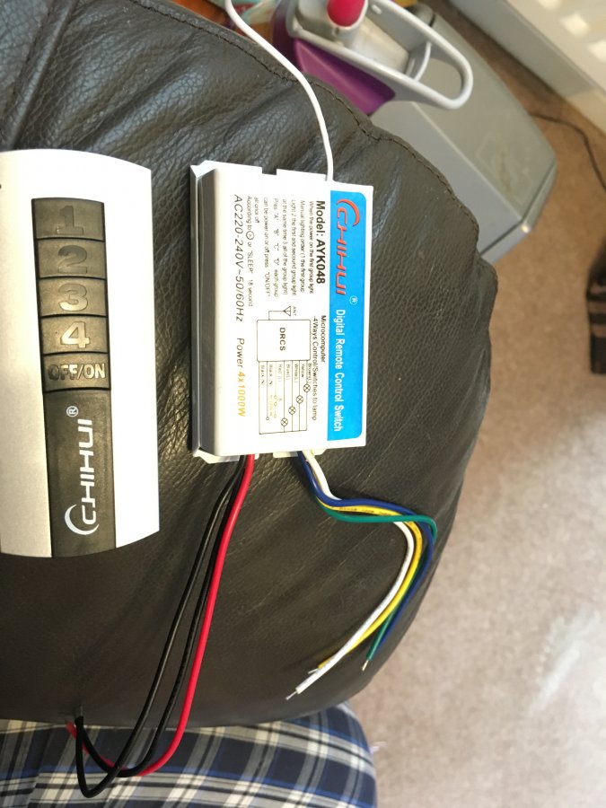

Morning all, long time moocher first time poster. I have a 4 input remote switch with 220v in, And 4 coloured outputs for the switched lives. How could I wire this so that I keep the on/off functionality of the wall switch? I am aiming to be able to use either the remote switch or wall switch independently.

This is the thing here, what I am looking to do is either be able to turn the ceiling light on with either the remote control or the wall switch. The 4 way bit just means it has the ability to switch on/off 4 devices.

To switch a light on and off from two positions, you would need to use 'two way' switches. But all 4 are 'one way' switches. The existing wall switch would also have to be a 'two way' switch and you would likely have to run an additional wire to it also.
I have had a look and a think. In answer to your basic question
The answer is not at all easily.
First of all, if you use that AYK048 device, to purely operate the light, it will need to be powered from the lighting circuit, not from a wall socket.
Secondly, I guess that, if the light is on (from the wall switch) you want to be able to turn it off from the bed? That box only has make contacts, and you would need changeover contacts, so you would need a mains relay that has changeover contacts.
Even if you could engineer and achieve that, you would then need a 3-core and earth cable running to the light switch from the AYK048 (or perhaps the light fiting, depending on how your wiring is done).
That seems like an awful lot of work, and wiring. Have you thought about having a bedside light?:D
More seriously, you could replace your wall switch with a remote control dimmer like this
there is a remote pad that you can buy for a fiver.
You can then operate the light either from the doorway, or from your cozy bed. AND you can get romantic by dimming the light!! Job done..
With the device you have - not possible. It also appears to have single insulated wires so even if it is used, it must be installed inside a suitable box / enclosure.
If you really want to do that, and the existing light is looped at the light rather than the switch, then
a. buy one of these: https://www.tlc-direct.co.uk/Products/LMESR1.html and install into the ceiling adjacent to the light
b. replace the cable from the light to the existing switch with 3 core and earth, connect to the item above together with the light and mains power.
c. buy one of these: https://www.tlc-direct.co.uk/Products/LMEST1.html and a suitable switch, install wherever you want.
d. pair the new switch and receiver.
If replacing the existing cable to the switch is too difficult, completely disconnect the cable to the existing switch at both ends, buy a second transmitter unit and install it behind the existing switch.
