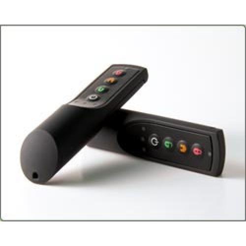

I am just in the process of installing a Tex Prem 88 system and I would like to use one of these.
What do I need to add the the system to work with this?
I guess I need some kind of Wireless extender?
Cheers,
Will
Ricochet expander 32way they do a 8 way but its been recalled so buy a 8 way at your own risk.
Perfect thank you.
I guess this connects to the network like any other extender? And I use Wintex to configure?
Cheers,
Will
If your just having the fobs yes, if adding other devices you are better installing the ricochet software on your laptop.
Great, it will only be the fobs.
All other devices will be hard wired.
Many Thanks
Hope your not wanting a lot of fobs, 2-3 year battery life on batteries that cant be changed could get expensive.
Only two fobs, didn't relise battery can't be changed, maybe I will be better going prox tag.
