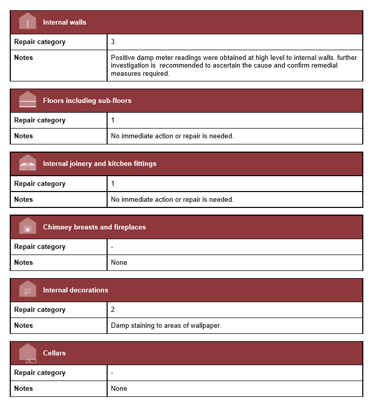

I am in the process of buying a flat-roof bungalow. It has been lying empty for 8 months so smelled quite "musty" when I viewed it last week. As per the rules in Scotland, the Home Report survey had to be refreshed to make sure there were no changes since the report was last prepared (which was a year ago). And the survey has flagged up a leak in the roof and high readings on a damp meter to the internal walls.
The seller has had a roofer out and he has given a quote to replace the roof. I have provisionally said that I am happy to still go ahead with the sale if this gets done. However, I am wondering if I should be doing more to check that simply replacing the flat felt roof will be enough to fix the problem? I was at the house again today, taking some measurements, and the smell of damp - particularly in the kitchen - was really horrible. I think it possibly seems more offensive to me now that I know it's caused by water ingress rather than just having not been lived in, heated or aired for so long.

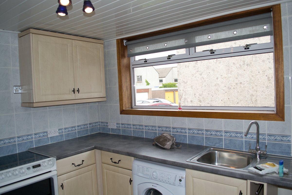

The ceilings in 3 of the rooms (including the kitchen) are white PVC tongue & groove paneling (which makes me worry about what is hiding above it). And the kitchen is also fully tiled anywhere above worktop level. So there is no way to check with a damp meter in the kitchen.
Can anyone please let me know what would normally happen in this kind of scenario? What I mean is, would it be sufficient to simply repair the leak (by whatever means), and wait for the walls to "dry out" and the smell of damp to disappear? Or would the damp smell still remain unless plaster walls and/or ceilings were replaced?

8 months is not long for a property to be void. However, its disgraceful for a surveyor not to diagnose the cause of any reported difficulties. There's no knowing the source of the pongs until the various defects have been remedied.

The PVC T&G will all have to be removed - you will probably find damaged surfaces behind.
When the roof is off is the time, if required, to re-arrange the wiring and lighting.

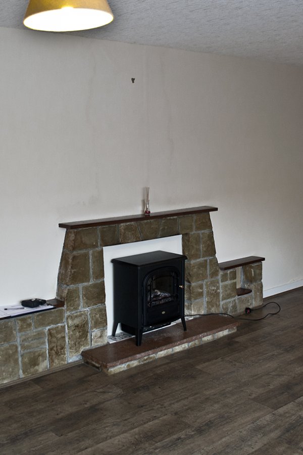

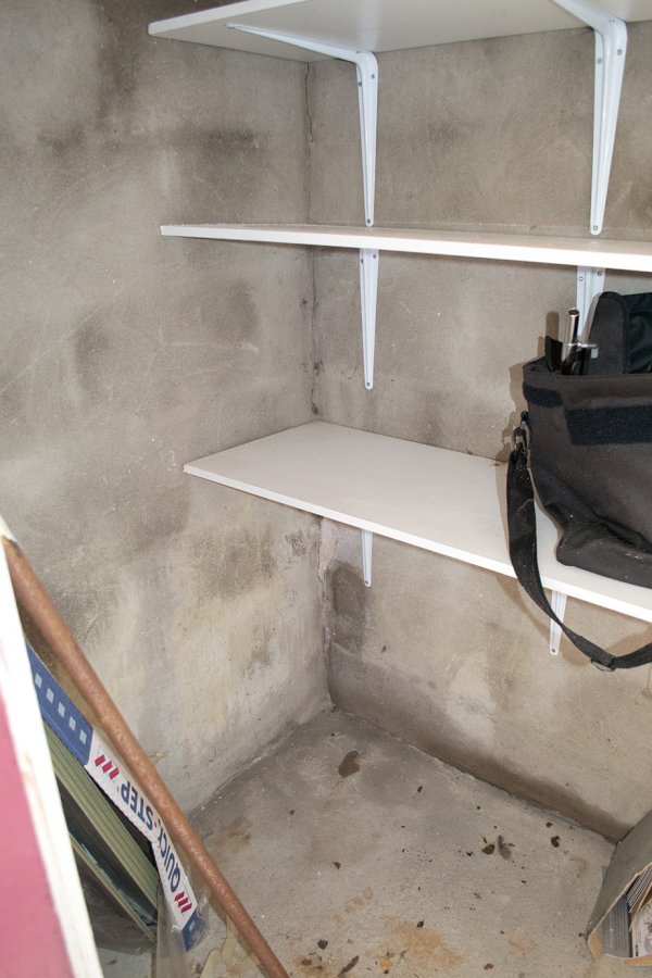

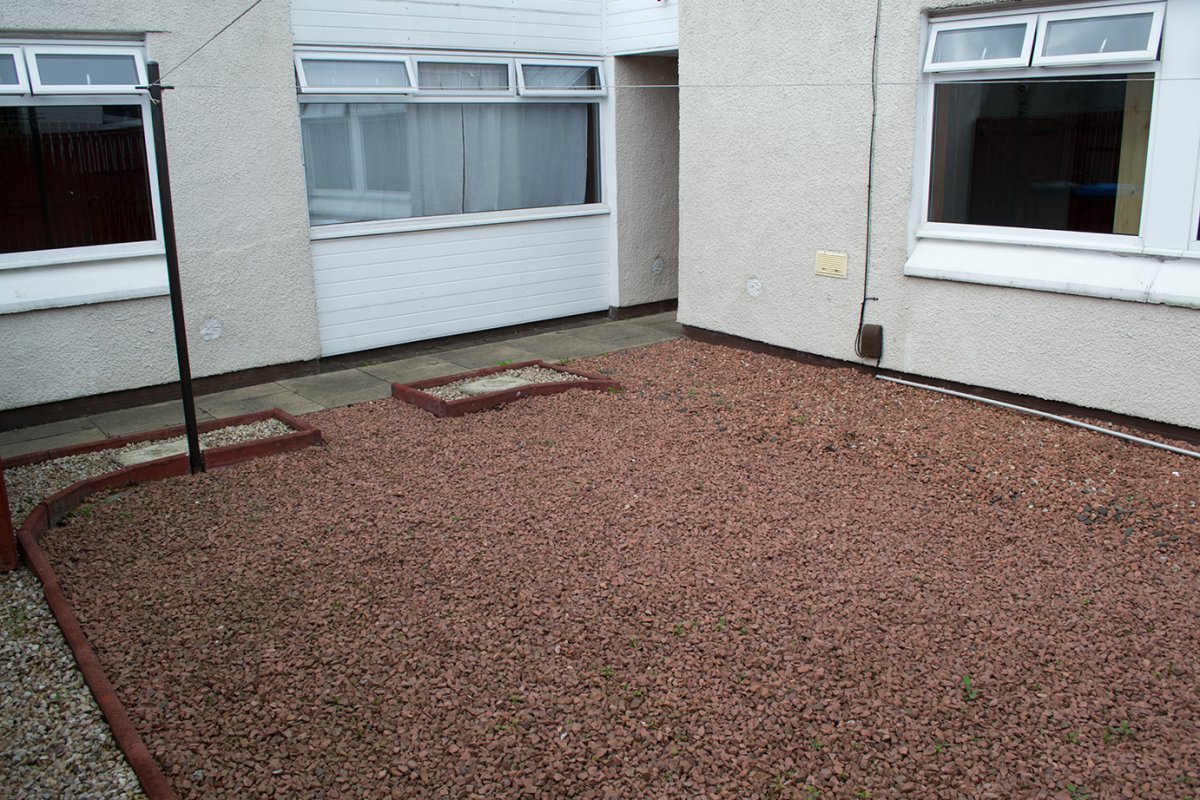

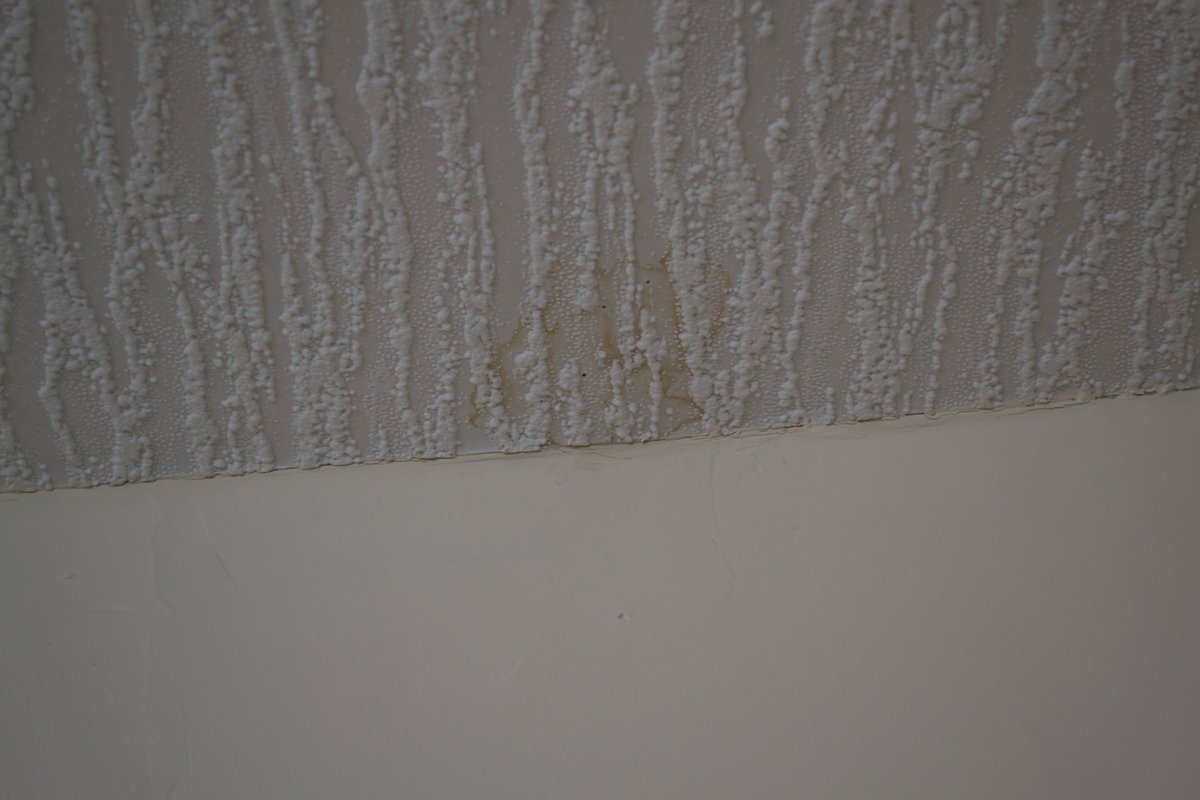

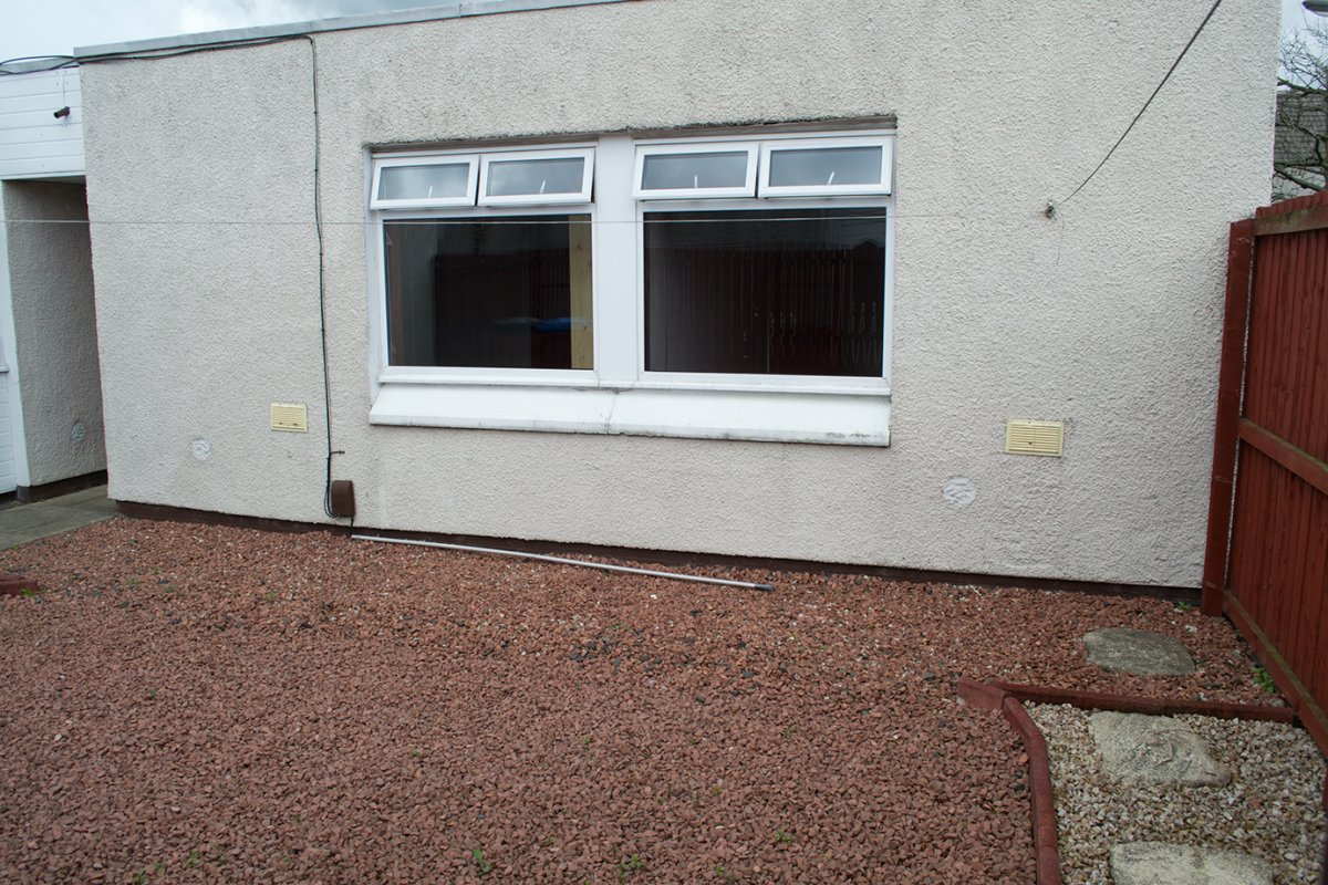

Thank you so so much for all of your replies so far! I took dozens of photos yesterday when I was at the house - but there are not any good ones of the roof. But I will upload a selection below to let you see if anything helps. For info - the living room is to the left of the kitchen in the photos; and the bungalow itself is an L-shaped building. By the way, when I looked closely at the photos, I spotted what I'm worried might be rising damp in the cellar (it's an outside cupboard on the same level as the rest of the bungalow). The surveyor did not check the cellar at all - in fact, he states in the report that there is no cellar. D'uh! Can any of you possibly confirm or deny for me whether this might be damp (just where the floor meets the wall on the rear wall of the cellar/cupboard)?
I read the first few posts and thought, "get a survey done". Then scrolled down to the post above and though "Oh she has".
But then thought "WTF, that's not a survey, it's a statement of the bleedin' obvious".
I'd get my money back.
A surveyor is not there to tell you that he has seen damp stains or roof ponding, or that he has recorded high damp readings and that further investigation is required. The surveyor should be telling you what is actually wrong. Duh!
Smells of damp don't tend to come from a small or one-off leaks, They come from persistent damp, and the smell is actually mould spores.
The issue might be the roof, or other water ingress, or it could just be condensation, or a bit of each. You really need it identifying by a proper surveyor.

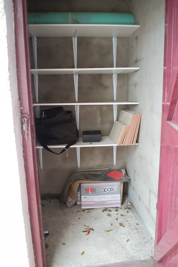

Its not a "cellar" (unless thats a local usage term) its a storage room.
There is a "tide mark" of rising damp visible in the store room.
There is also much evidence of condensation, & possible penetrating damp.
The heavy (stained) ceiling paper is possibly covering a damaged surface.

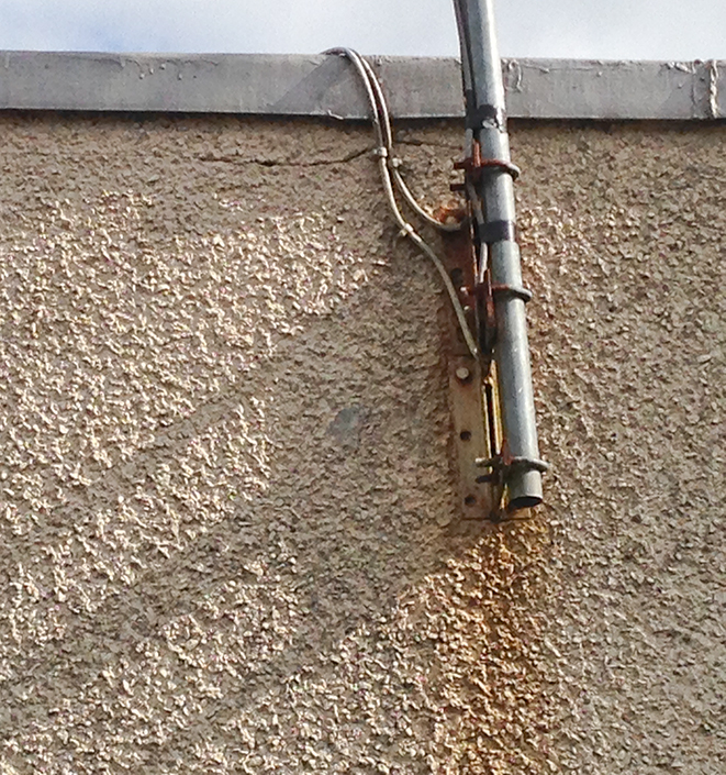

There is a stain outline grinning thro above the fire appliance - perhaps its staining coming down from the roof or thro the wall, or possibly the site of an old chimney flue?

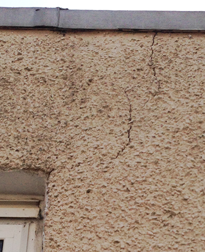

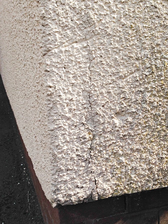

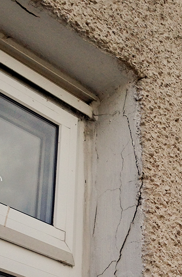

There are indications of previous repair patches to the external render.
Could the pattern of circular spots in the render be where "Knapen Tubes" have been removed? Knapen tubes were a "Dutch" scam claiming to eliminate rising damp - it was simply a scam. The Dutch company selling Schrijver inserts is also a similar scam in my opinion.
The property was a cheaply built slab, flat roof, and block and plastic panel effort from 50 - 60 yrs ago. Does it have a membrane below the concrete slab, or a DPC in the walls (if you have a DPC then is the render bridging it?) - things a surveyor should have determined.

Thank you again for all the hugely helpful replies! Yes, the survey report is ridiculously lacking in useful information, I totally agree. I'm not sure about the property market throughout the rest of the UK - but in Scotland, what happens is the seller arranges and pays for a "Home Report" when they put their property on the market. This is carried out by a qualified surveyor and includes an Energy Report and a Survey (extracts of which you've seen above) and Mortgage valuation report. This Home Report is intended to be totally unbiased and impartial. And it is made freely available to anyone expressing an interest in the property. This means that purchasers no longer need to arrange their own surveys. The cost to the seller of getting the Report done varies - but is several hundred pounds (the one I arranged for selling my own flat cost £540). So you would think that the surveyor would put some effort into making sure he provided reliable and useful information to purchasers. It's pretty damn frustrating to realise this is not the case.

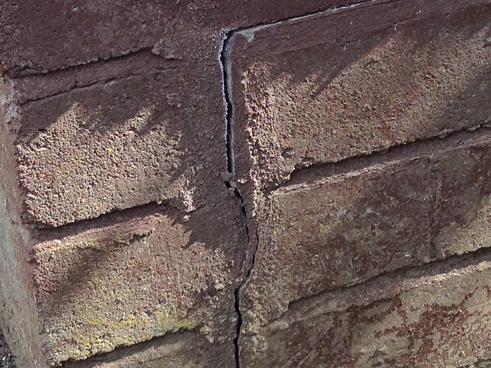

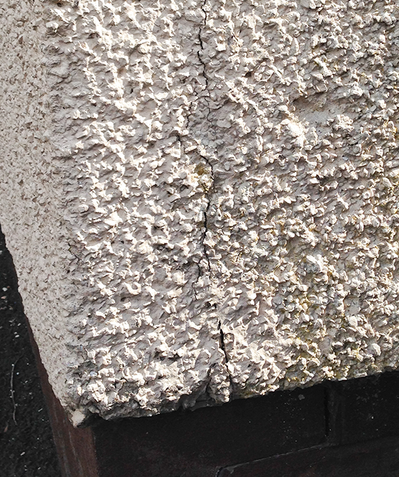

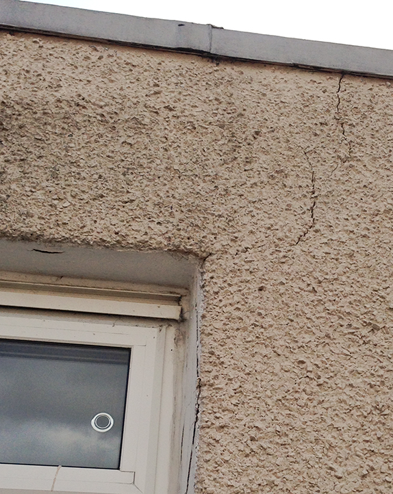

Just a wee follow-up. I went back to look at the house again the day after I last posted here (it was not an official viewing, so the house was unoccupied). And I realised that roofers had been there laying down a new layer of felt on top of the old yucky roof. So bang went any chance of getting a specialist out to look at the problem. I also did a closer inspection of the exterior of the house - and noticed several cracks in the bricks and the render. - especially in the vicinity of the kitchen (which is where I had noticed the worst of the damp/mouldy smell).
So I made the decision there and then to back out of the sale. It seems like the owner was overly keen to do a quick patch repair and get rid of the place - with no particular care whether there was a more troublesome damp problem throughout the building.

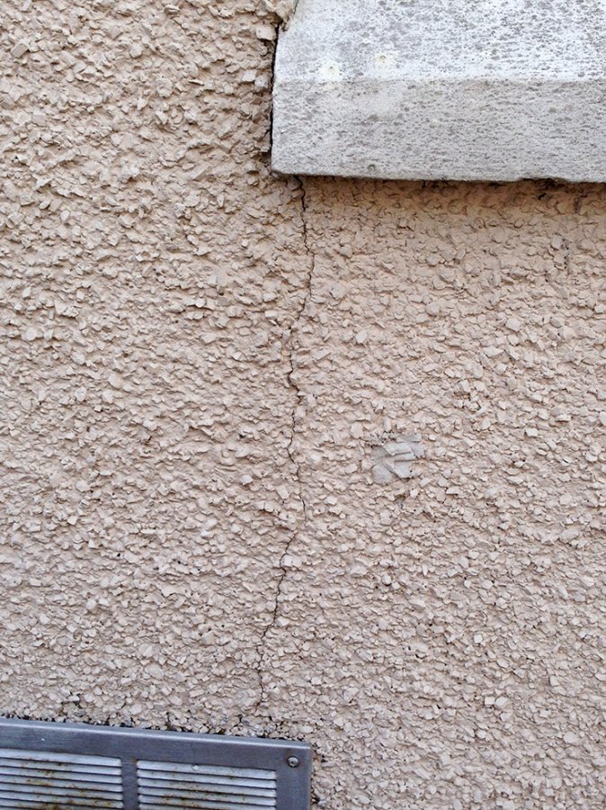

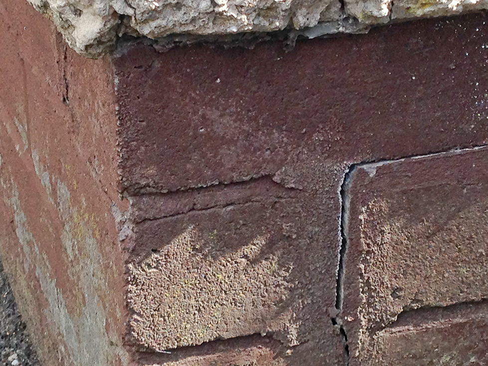

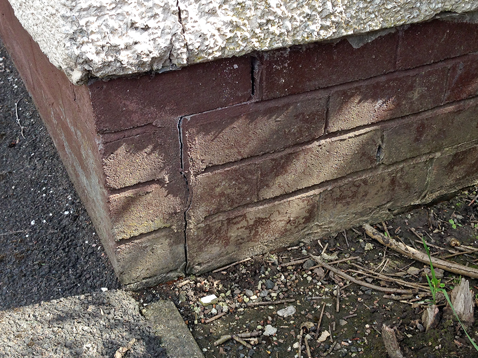

By the way, here are some photos I took of the cracks etc (none of which were even mentioned in the Home Report survey!):
Thank you so much for coming back and telling us what happened next and for the extra pics.
Just saying but if the new property appears doubtful you could always go back and present the previous seller with the info from here, and then go in with a ridiculously low offer, and wait and see what happens?
Good luck anyway.
