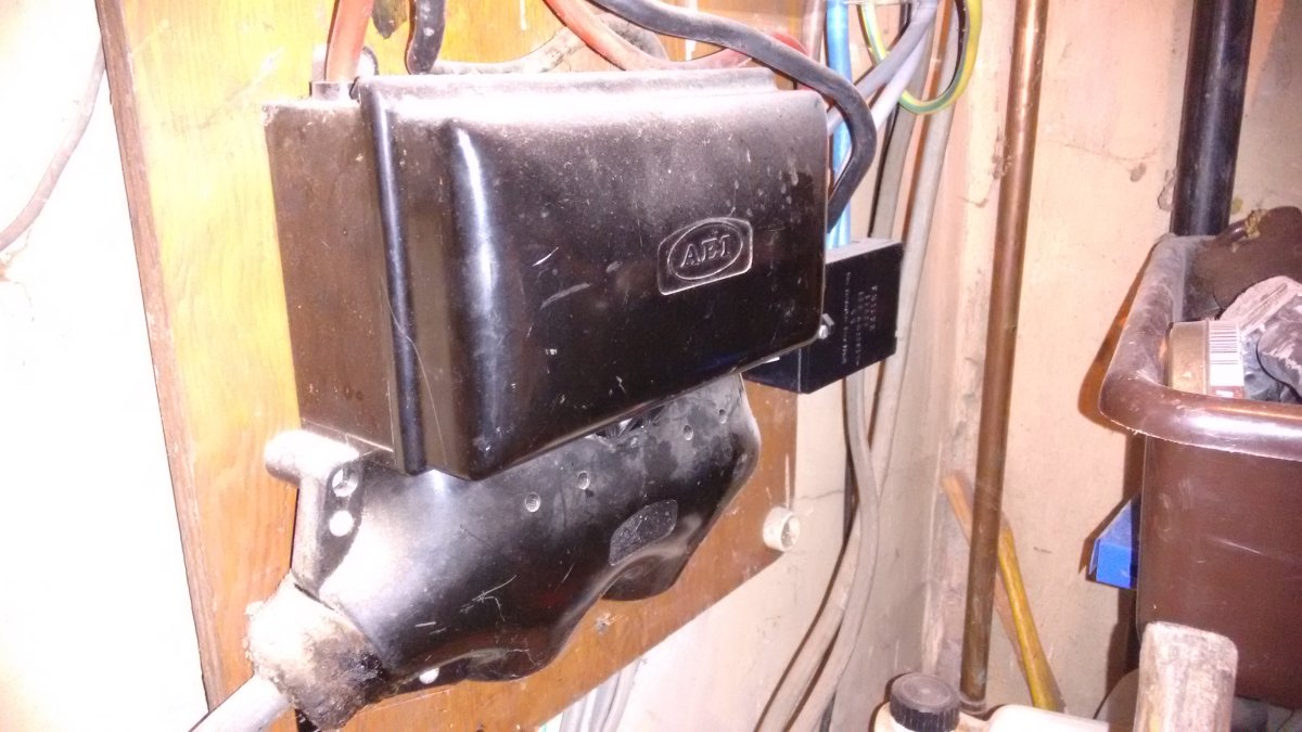

advise on what I need to do to this meter head?
6 Oct 2008
25
Berwickshire

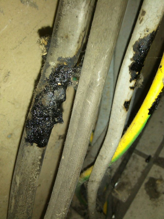

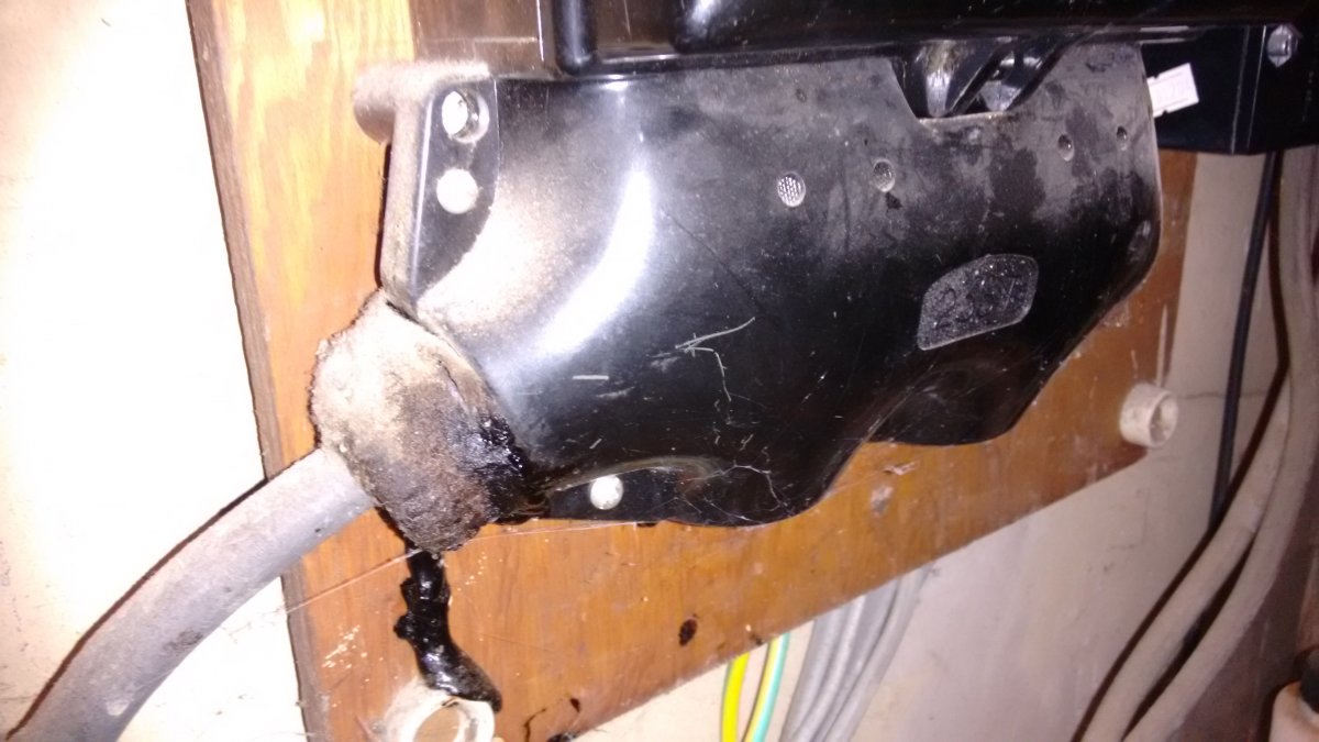

Hi there
I wondered what I should do with the meter head (at leaset i think its called the meter head could be wrong)
I have attached some photos of it it is very old looking and it appears to have some black substance leaking out of it or has had in the past. what ever has leaked looks like it has damaged one of the cables below.
Should I call an electrician out or should I contact my electric supplier. Many thanks for any advice it just doesnt look all that safe

The substance is cold so I will call the relevant number
The substance will be cold now it is no longer in contact with the source of heat inside the cut out (meter head). There may be a poor connection inside and it does need to be checked by the DNO. Informing your supplier will delay the check that is assuming the supplier does pass the report onto the DNO
The DNO is SSE. That's who I hope the OP will call, and not the company to who he pays his electricity bill.
Yes your DNO will replace it, we had the same issue although ours was a three phase head, they came out and replaced the lota couple of weeks later, all for no extra charge. They did take the whole morning though.
Lots of recent pushes to make the supplier the "single source of contact" have given us this mess.
I wouldn't trust the system, and no reason why you shouldn't call the DNO directly.
Hi all
Just following up that a operative from DNO came out to inspect the meter head and he didint think there was anything to worry about just explained the reason why this tar based solution leaks out and said that as long as it wasnt getting hot or starting to smell he saw no reason to do anything to it.
Thanks for all the responses
I'm surprised, so maybe the pitch isn't essential then.
Ours had problems with the IP rating as well, so maybe that was why they changed it not from the pitch.
