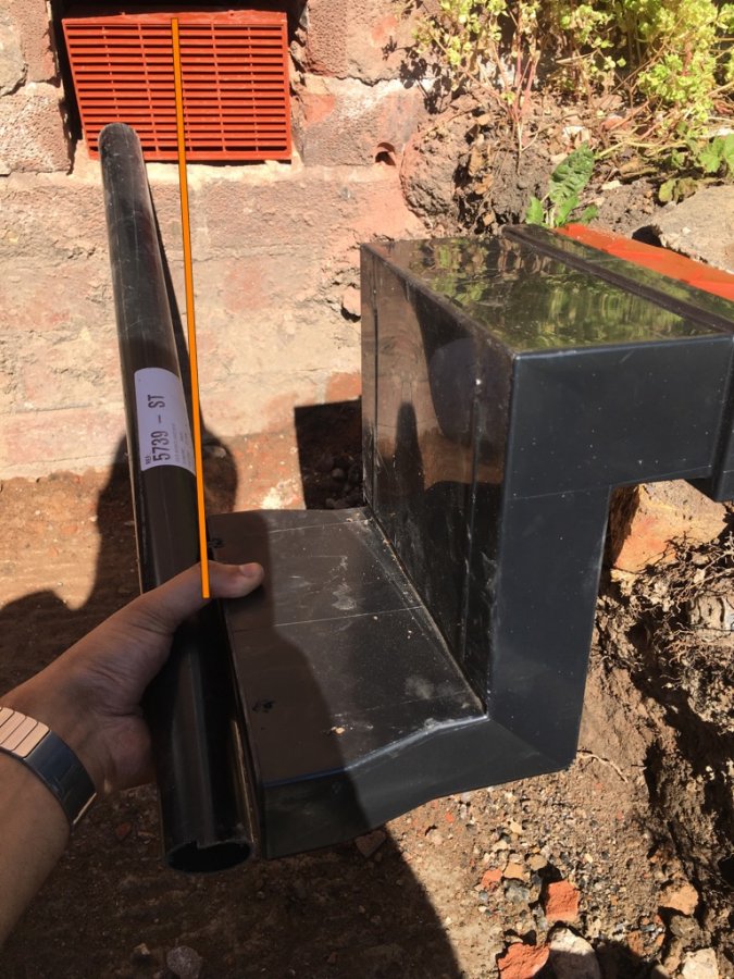

We are making a porch 2.5 by 1.5 meteres with a cavity wall.
Few questions.
We are not putting floor boards however I was reccomend a telescopic for ground ventilation. I always thought ground ventilation was required to stop floorboards rotting?
Is there typically any other types of vents I need to consider for something this size? Trick vents etc?
are you blocking vents to existing floors?
it's easy enough to connect them with some drain pipe to a brick vent.
Not quite sure what your plans are for the floor given your post though ?
Yes we are block half a existing vent. This was discussed in another post. We are replacing a ceramic vent with a plastic vent. As plastic vent has double the airflow I shouldn't lose any ventilation.
The question was bore about introducing a new vent for new porch. Do I need to do it? Given new porch as no floor boards.
Additionally is there any other ventilation I need to consider
Just to clarify the picture shows how half the original vent will be covered. So I removed it for a plastic one which will allow more air flow. The plastic part which will be covered should I make a hole in it and link a plastic pipe to it??
