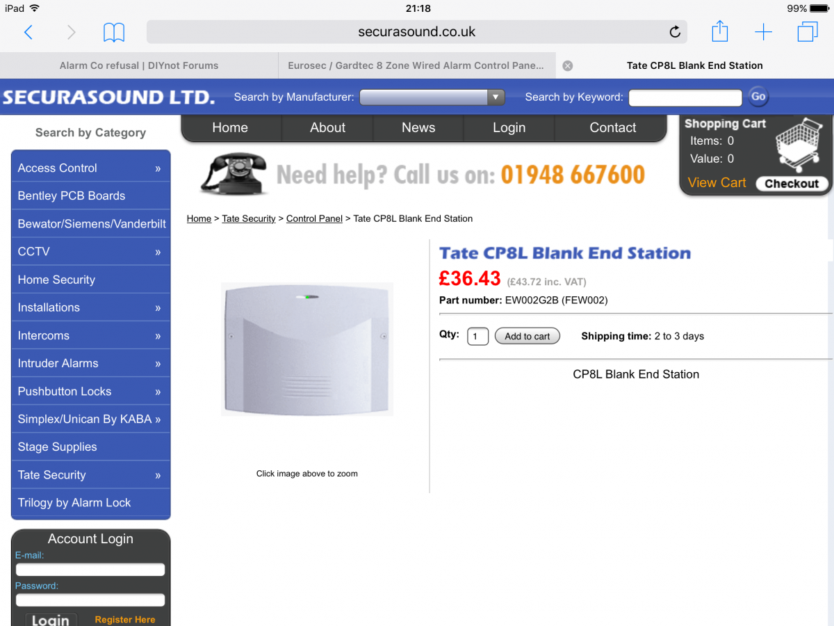

The panel PCB is useless if you have not got the engineer code.
Ask the alarm company to reset the engineer code for a reasonable fee.
Cheapest option if locked ,
