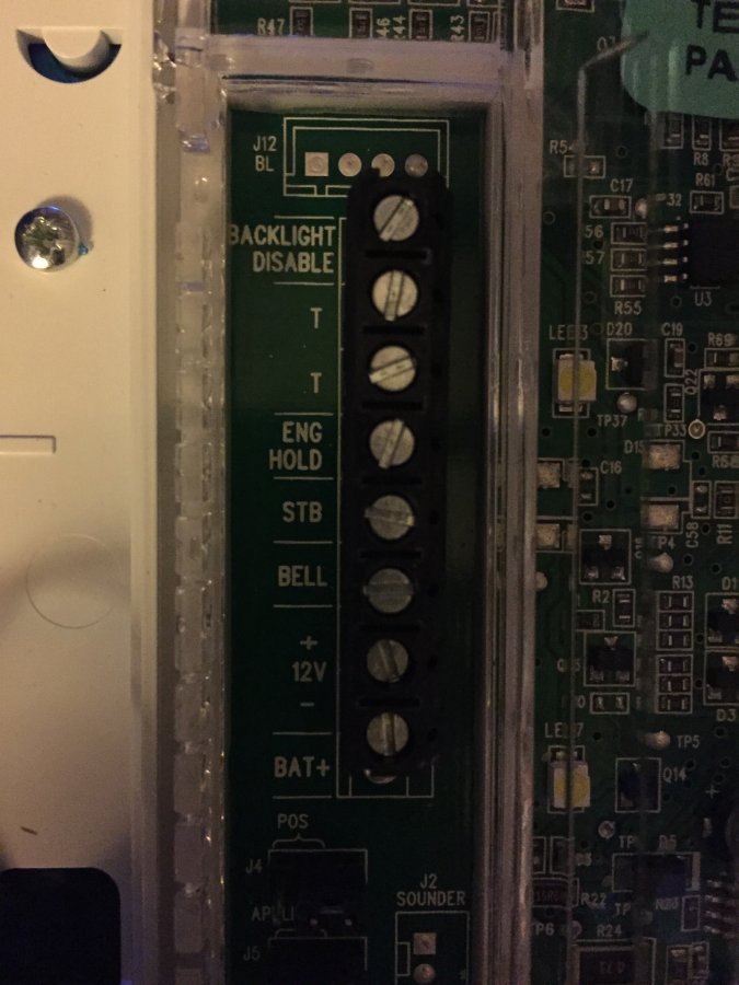

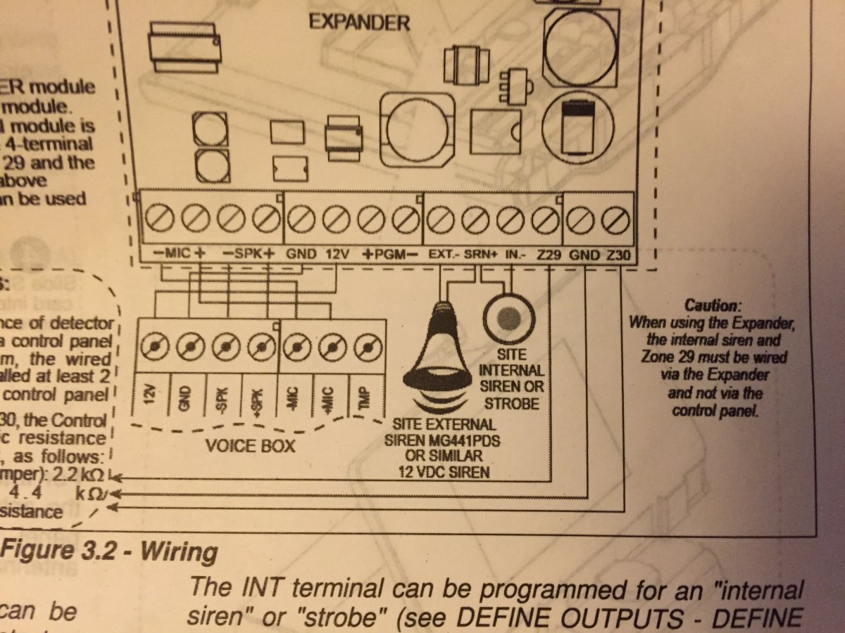

Hello everyone new to the forum and need a little help.
I have purchased a visonic complete wireless alarm system with the expander because I wanted the external sounder to be hard wired.
I purchased the deltabell plus sounder and I'm confused as to where the wires correspond in each the sounder and panel,has anyone had any experience in fitting these ?
Any help would be most grateful,the first photo is the bell box and the second is a picture in the manual of the expander module.
So far I've figured out (I think) that the sounder
Ext - 12-
Srn + 12v+
Z29 -T
GND - T
Where does the strobe and bell get wired to ??
At a guess you would use the GND and 12v to power your bell, ext for the bell trip , int for your strobe as per diagram ( it would have to be set in define outputs ) and tamper via ground and 29/30 with a 2.2k in line ...
