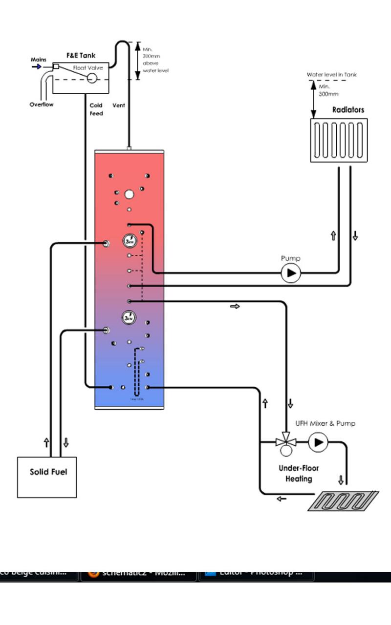

Hi, can anyone give me their opinion on the heating system I'm planning?
Solid fuel range cooker with a back boiler downstairs gravity feeding via 28mm pipe a 200 litre thermal store upstairs(i'll get a bigger one when I can afford it) leaving the possibility of adding a heat pump at some point. Underfloor heating downstairs but the manifold upstairs in the same cupboard as the store. 23m2 kitchen as one zone, 48m2 living room split over 2. (I read that pipe runs shouldn't be longer than 100metres and that 100metres will do 25m2). 4 pumped radiators upstairs. The house is in the process of being well insulated.
Is the heat store enough of a heat dump or should the bathroom radiator be gravity fed by t-ing into the 28mm as well?
Does this sound plausible?
Thanks.

Thanks for the replies. I intend to do all the work myself and would like input from anyone with experience of a similar setup.
The stove is a franco belge type 82 904. I cant find the output for it but a smaller one in that range does 7kw so I'm guessing this will do at least 10kw.
In new builds, the heat flow for ufh is about 60W/m2 but I'd expect about 80 W/m2 in our place. The ufh would be a bonus but getting heat into the rads would be the priority. The ufh pipes will be in place for if I add in a heat pump or oil boiler.
This is how I picture it working
( i hope the picture works) There would also be wood burner in the living room for extra heat. It would be a direct system so no heat exchanger in the tank. Unfortunately a UK pension won't stretch to paying a french heating engineer.

In my opinion your ideas of heat output per m2 are completely wrong.
Figures of W/m2 are being bandied aroud as if this were some kind of given rather than depending on pipe spacing which is not mentioned anywhere except implicitly where 25 m2 per circuit are spoken of.
AFAIK 100W/m2 is achievable with normal input temps ( 40-45 C) with pipe centres at 10 cm. This means one circuit will cover 10 m2 not 25 m2. You could have a 25 m2 circuit but with an output of 40 W/m2 approx.
This apart you must not forget the extra few metres you will need to get to and from the manifold .
Using my figs this would mean at least 7 circuits and I don't know if you can get such a big manifold so that might mean two.
Do you have a reasonabe amount of space in the cupboard for the manifold and pipes ? They are not small and you need space around it/them to install them and feed pipes in a straight line on to the connections.

1 I dont think i need 100w/m2 downstairs. The house will be quite well insulated, a wood burner in the living room to make it toasty and the cooker in the kitchen which is feeding the ufh giving heat out directly into the room. I'm working on 3 runs of 100m using 16mm pipe at 20cm.
2 Whats wrong with the overall idea of back boiler, heat store, rads and ufh.
Igotalake (can I call you igo?) I dont see any reason why it wouldn't work with a bit of tweaking.
