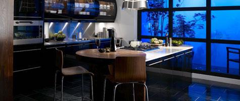

Or maybe a table at the end of the peninsula like this? if budget and space allows?
just thinking out loud.
Either way, good luck!
M.
That's the same as in this brochure.http://publishing.yudu.com/Freedom/Ag21o/TheKitchenDesigner20/resources/index.htm?referrerUrl=http%3A%2F%2Fuk.mg40.mail.yahoo.com%2Fdc%2Fblank.html%3Fbn%3D975.45%26.intl%3Duk
