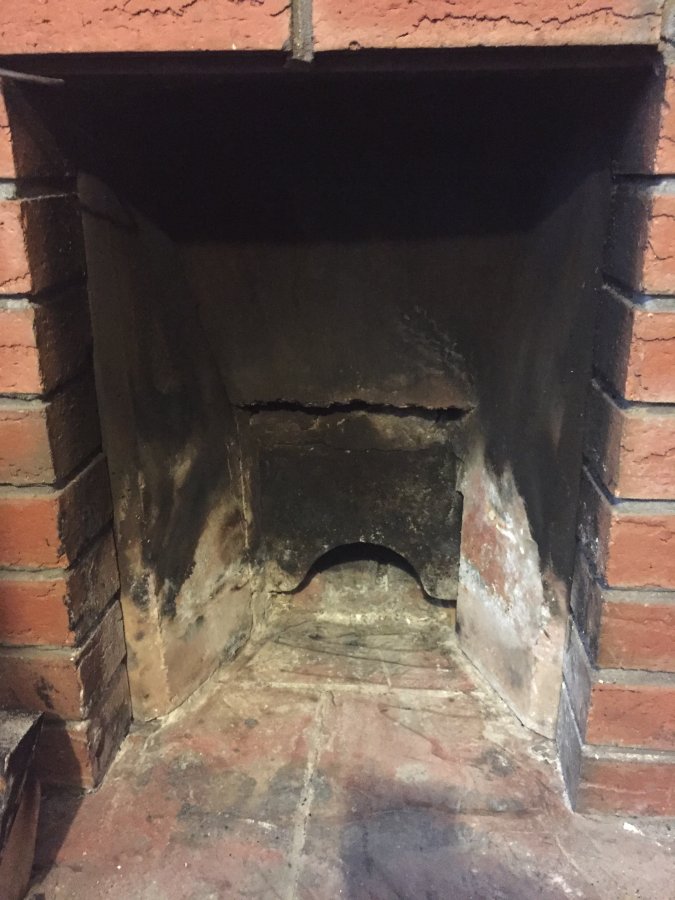

Ok managed to get it as clean as I'm going to get it without getting an actual scrubbing brush on it, I'll be another few days if I do that haha
But here's a photo of it empty. :)

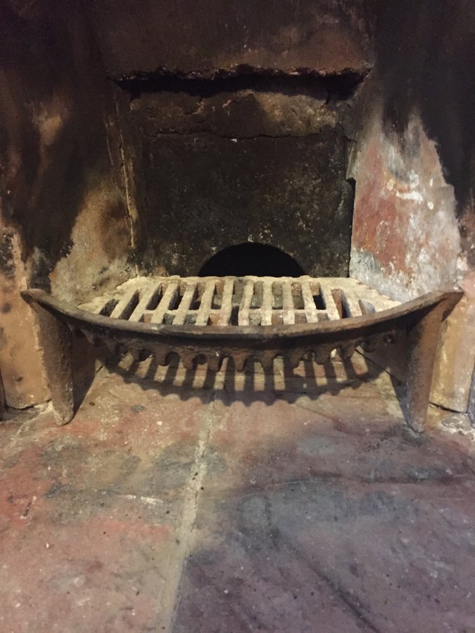

I'll post a picture of it with the grate too.
Many thanks again

That grate is too high.....the flames and hot gases need to be drawn through that arch in the back boiler. Through the arch, there should also be an unobstructed passage for the flue gases to head for the chimney, and its the damper position that allows this to happen.
I'm pretty confident with the grate lower, the void behind the boiler is clear and the dampers open, you'll get hot water right enough! With the damper closed, the fire will just lick up the front of the boiler - with the damper open, the flames should roar through that arch.

I agree mate. Boiler too low & what the hell is the slot at the top of the boiler???!! Is that the outlet or inlet of the flue way?? It looks like a Milner type fire back. Certainly will be farting at thunder for producing hot water.
I can't see if its actually a slot or just a shadow......if it is a slot I can't for the life of me see why, unless its for getting a soot rake in there :eek:
The installation doesn't look the best - maybe its just some pointing come adrift.
John :)

So I was right, other half is going to get grief now :sneaky: although I've just told him and he's adamant that we need a higher grate :rolleyes: as that's what they have at his parents, one that is above the arch. He is adamant that it then draws the flame and gases down. All I got was 'I know what I'm talking about'. :rolleyes: Unfortunately with him there is no telling him once he's got it in his head. I think the only thing I can do is go buy two grates, one really low one and one really high one and compare them and show him. I've found a low one, anyone know where I could get a super tall one from please?
Yes that's a slot, if you're meaning that line about half way up. Haven't got a clue what for.

A mentioned the fact that the old grate meant we had hot water and explained that the flame etc has to go through and up the arch. He still wasn't convinced.
Anyway whilst tidying up we found the old grate, he kind of said there it is if you want it. So tomorrow morning when the fire is cold I'm putting the old one back (y)

A bit of logic for your O.H .If the heat was to be drawn through the grate to go up the boiler it would soon burn out the metal bars. Just ask your local blacksmith for a demo;)
