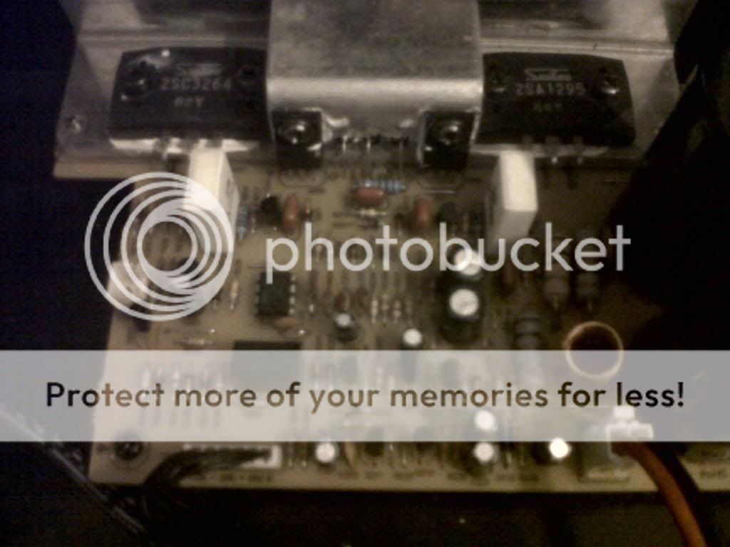

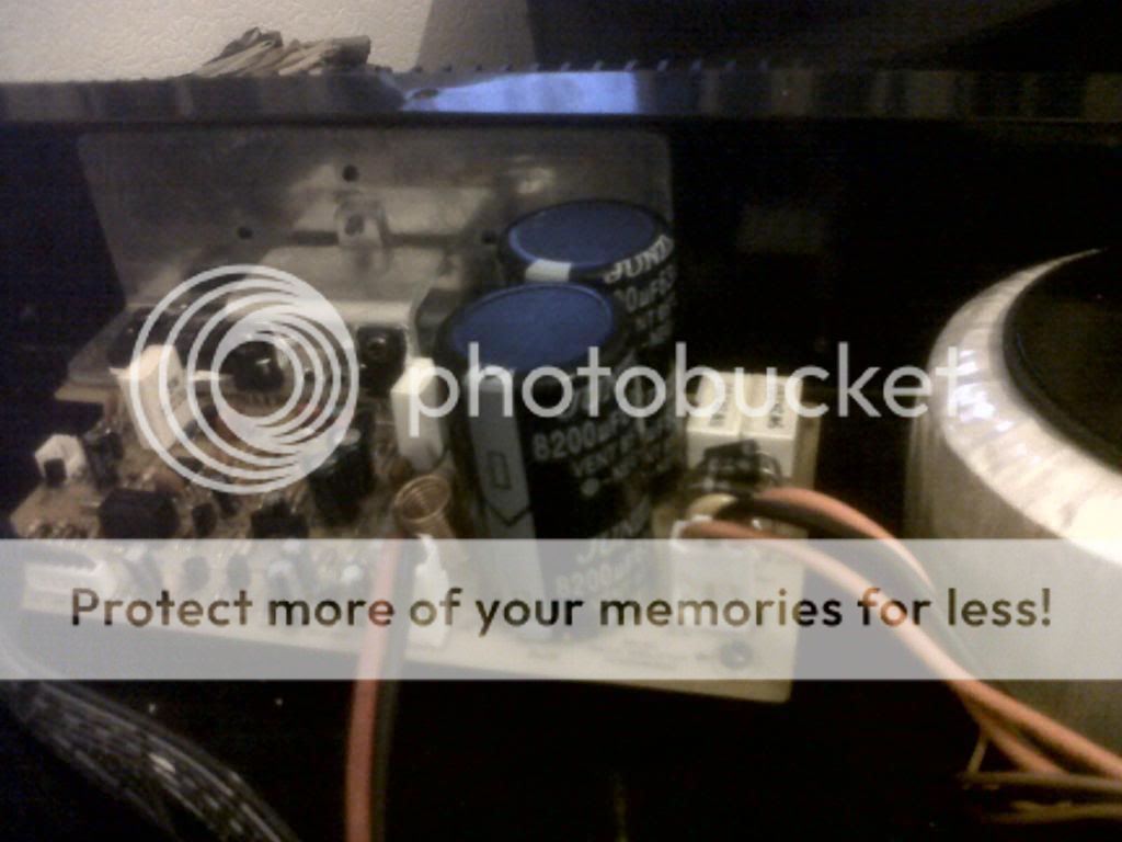

Here's a couple of pictures,
LED goes out straight away where as before it went out slowly.
A strong clue that says your filter caps (likely those big black 8200 uF units) have greatly diminished in value or maybe their solder joints have failed to a high resistance value. You need an oscilloscope to check power supply ripple but you may be able to check this with a true-RMS AC voltmeter. With no signal in you should have very low ripple, I'm guessing less than 5% of the voltage marked on those caps. The ripple is a sawtooth waveform so we'll need a formula to convert P-P values to RMS values.
Could also be a shorted power supply diode sucking the charge out of these caps. An in-circuit diode/capacitor checker would come in handy right about now, otherwise you need to start unsoldering components.
Luckily, it's a very basic transformer supply so fixing should be easy, provided that it hasn't damaged the amplifier. I recommend not powering it up again till you've replaced the faulty component.
If the hum is predominantly 50 Hz, one of the four rectifier diodes has failed. What is the number printed on them? Possibly 1N500x.
If the hum is predominantly 100 Hz, one of the large capacitors has failed. I would replace both with capacitors of the same physical size and rating. You need to know the value (8200uF) the voltage and the ripple-current rating. The latter will be impossible to determine other than from the manufacturer, so go for the highest you can find. It'll probably be Hobson's choice!
Let us know the voltage and dimensions if you need help in finding a replacement.
