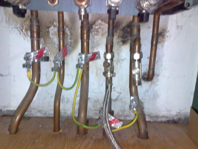

My boiler has been working fine recently, until tonight when the water wouldnt heat up.
I checked the pressure guage and its at 0 :cry:
so assumed that using the black tap method would raise the pressure as it used to in my old boiler...
But nothing happens...
what else is confusing is that the silver braided pipe isnt attached anywhere!! so i am now assuming its not even attached to the mains?
Can someone have a look and tell me what i've got to do...as kids all need showers and I need to know if its going to cost me an arm and a leg as Im totally skint at the mo.. :(
attach the end of the braded hose to the non return valve (next one along) then use a screwdriver to open the valve at the connected end of the hose. top up to 1.5bar the close valve and remove filling loop.
Screw the open end of the braided pipe to the check valve ( the silver fitting) on the right hand pipe and open the other end valve with a screwdriver. Fill the system to 1bar, then shut off the valve with a screwdriver so the slot is across the pipes ( as it is now). Hope that helps
Mike.
BRILLIANT!!!
Its now working yay no more smelly kids!!
Thank you both for your replys, I owe you some beers!
:D
