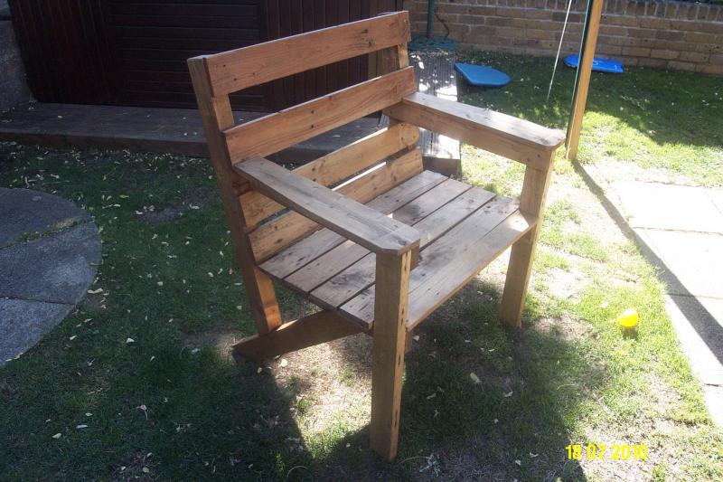

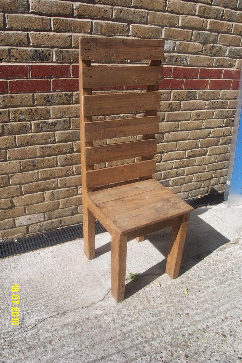

You gotta love Pallet wood for being so readily available and being easily turned into worderful things like those chairs... well done!
I've got about 200 planks to plane down and with money being tight that wonderful planer thicknesser is just a bit too out of the budget, so i went and bought a planer from homebase last night... should do the job nicely.
Time is of no issue, i've been building this thing for almost a year now already and its coming together nicely. I've already sanded the pallets that are already standing as the walls on the inside.. took a while but the drum sander was pretty effective for upright wood, just punched all the protruding nails beforehand.
All the planks are now sitting waiting to be planed, I can do that on the workbench before nailing back onto the wall.
the wood cladding will now be nailed over the gaps in the pallets creating a rippled effect along the wall - I am more than impressed with the beauty of how a good sanded up pallet looks... Thanks for all the advice though guys, this forum is such a valuable source for information and advice :)
Couple of pics....
