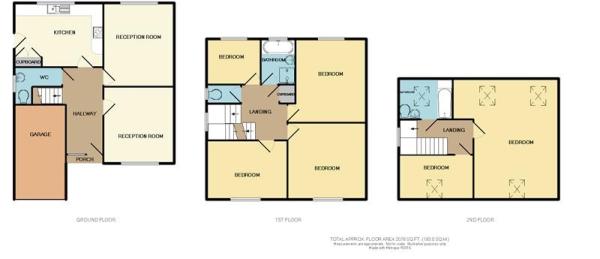

I have a very large semi detached - 6 bed and 3 bath about 15 rads.
reason for the valiant is boiler guy is advanced valiant hece the 7 year warantee.
I want to get a 300 L tank(unvented cylindeR).
1) what boiler size? 37kw boiler man reccomended but i believe its over skill. I think 30 kw max.
2) theres a new Green IQ valiant boiler - is this worth it? its only 27kw. will it be as easy as normal boilers to install.

The boiler rating depends on the heat loss of the property! Have you calculated that?

The house is 3 floors (due to a loft, 6 bed semi of 1962). Double glazing is 10 years old. It has a cavity wall (but looks about 50mm maybe) which has recently been filled with a grant. The outer of the house measures at 8.5m by 9. It has a loft which is insulated. Plan attached of house(the only change is addition of porch and converting the toilet 1st floor to a ensuite, and adding a toilet to main bathroom). First and ground have a height of 2.44 metres.
The pipe work has just been all changed to be optimised and their are 14 rads in the house. The rads are also being changed.

Without a heatloss, you're guessing for the right size boiler. As far as cylinders are concerned then there are many options particularly budget based. RM, Telford, Main basic budget cylinders, Oso, Joule, better quality cylinders, or the option is go for a manufacturer package -Vaillant System Boiler, Vaillant Aurostor Cylinder & Vaillant Controls - Or alternatively Worcester System Boiler, Worcester Greenstar Cylinder, Worcester Greenstar Filter & Worcester Control Package which come with 10 years manufacturer warranty.
