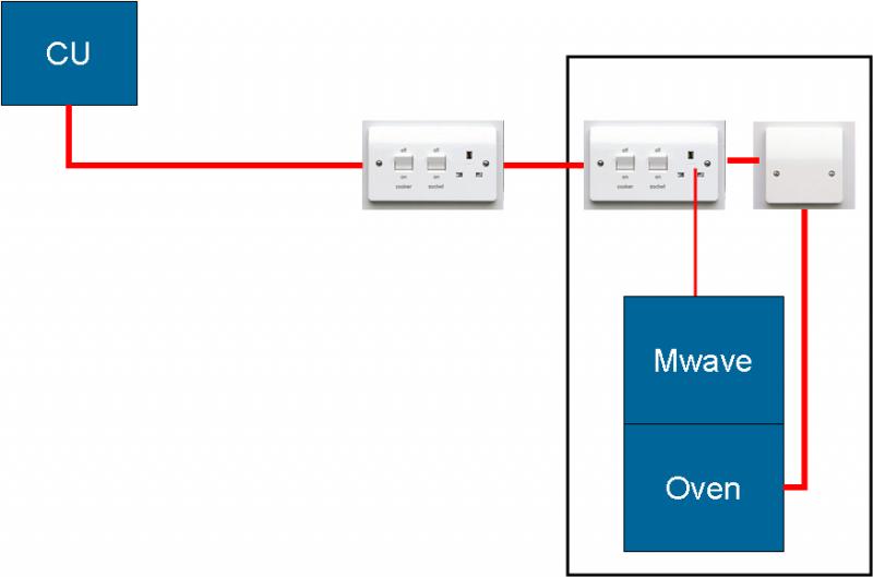

I want to swap a built-in double oven for a separate single oven (3.6KW) and combination microwave (3KW) both of which will be built into to same space and connected to my 30AMP cooker circuit.
The existing wiring is a 30AMP MCB radial circuit to 45AMP cooker switch/socket (MK) with buried 10mm T&E to back of oven housing.
Complexity arises due to new microwave requiring a 13 amp socket whereas single oven requires 6mm T&E connection. I have no easy way of getting a ring main spur to the back of the microwave.
Question:
Is it ok to add a second MK oven switch/socket (K5040WHI) behind the built-in cabinet to feed both devices from the existing 45 AMP switch?
All cable will be 10mm T&E (apart from the flex to the microwave) and I'll end up with two cooker switches in series with the load on the accessible one feeding the hidden second one into which both devices are connected?
The hidden one will always be left on - cooker and socket.
Creating a new spur off the kitchen ring with isloating switch for the microwave combination oven is difficult as it will require removing tiling.
I also don't like the idea of a normal 13AMP socket spur with 10mm cable.
I understand this is ok with regs provided all cable is same size.
Max load on the new circuit would be 16 AMP (single oven) + 12.5 (microwave) + 13 AMP for visible socket = 42 AMPs.
I'd probably use a K5045WHI for the 10mm buried cable outlet.
Is this ok or am I being stupid? Should I get an electrican to upgrade the MCB or leave it at 30AMP?

Thanks guys. To be clear, I'm ONLY interested in doing this properly and safely and will happily call in a Part P registered electrician to inspect and approve the work.
My question was more whether it was dangerous or in any way wrong to have two isolation swtiches - one after the other - one hidden, one visible? This is only because I don't see how I can easily get 10mm T&E into the back of an ordinary single socket.
Diagram might help explain what I'm proposing:
Appreciate your thoughts on this.
You'd have an accessible means of isolation. so that's OK.
It wouldn't be easy. It would probably go in, but equally probably would not be what the manufacturer specifies.

The microwave "appliance" in question is a Neff built-in combination microwave oven and is physically screwed into a kitchen unit. It is 3KW device and has an ordinary 13A plug. I don't want to have to expose the lead out the back, around the side of the unit and plug it into the visible socket on the cooker isolator - this would be very untidy. I'd prefer to have it plugged in behind, hidden away but still isolatable via the existing cooker isolation switch.
I agree with BAS - this is a cooking device, if I had bought a single combination double oven there would be no issue - the fact that I have chosen two separate devices (with total rating same as a double oven) should not mean that I have to create new spurs off the kitchen ring.
