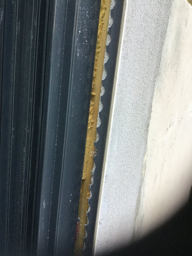

Hi My builders left the exterior frame of my byfolding doors unfinish as per the picture.
I have the white strips that go there in the gap but I am unsure how to attached them to it. Do not want o use just any product. Any advice?

Is there a system name or manufacturer that you could refer to?
Otherwise try in the window and door forum as there are some fitters there.

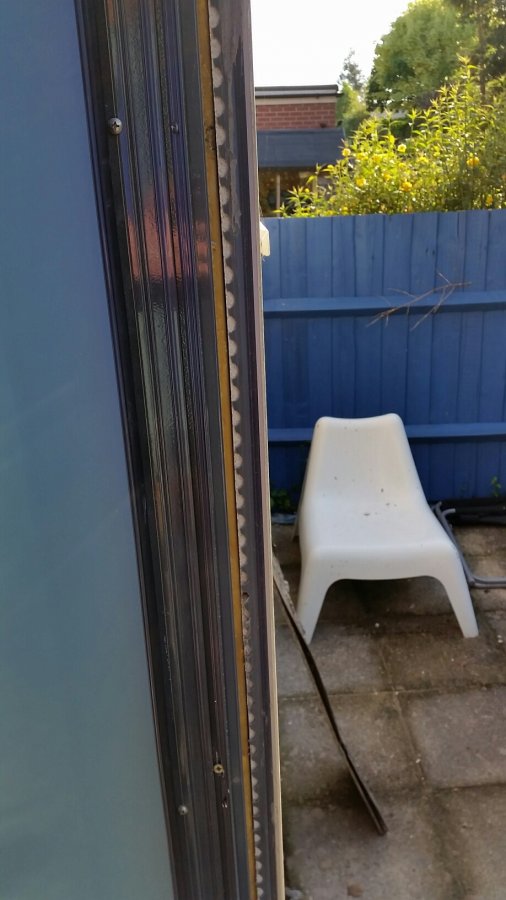

If the white strips are plastic trims usually used around pvc windows then we just use silicone but a photo of the strip would help just to make sure we're talking about the same thing as well as another photo from outside at 45° to the area the strip should fit
As above stick them on with LMN silicone but......
Personally I would get some anthracite grey trims from your local Eurocell branch for this. It will look better against your doors that white trim
