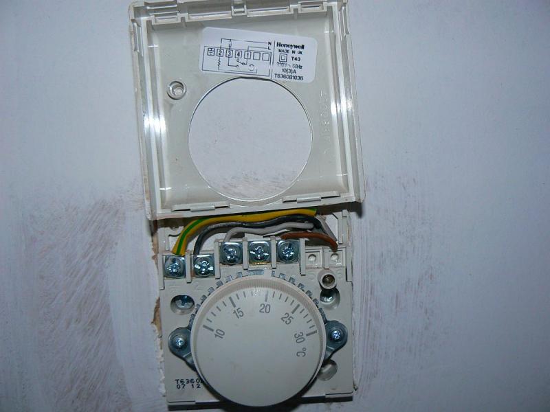

Hi guys

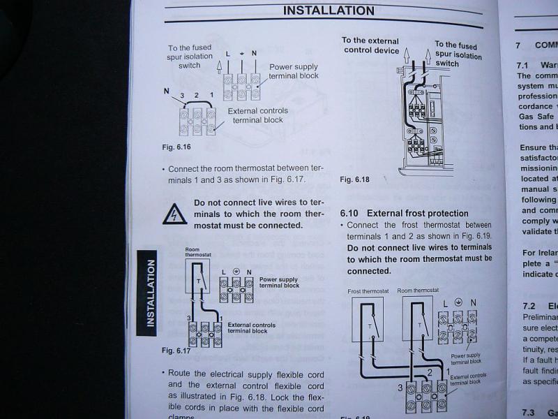

Im trying to connect my old room thermostat from previous boiler to my new boiler Biasi Riva Plus HE28 (M296.28SM/C) Im a bit confused coz in room thermostat are 4 wires (like on picture)
and manual says how to conect 2 wires

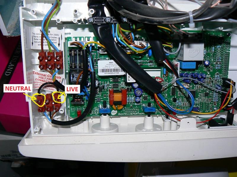

Should i remove that black loop and connect it like this
If yes what about the rest of wires???
Manual says two wire stat connections and the picture of the boiler says volt free. Better to fit a new two wire stat.

Yes but in this case wrongly wiring the connections will damage the PCB !

Sorry for misunderstanding. On picture 3 i marked Neutral and Live but i ment colours of wires from thermostat (neutral - black, live - brown). This thermostat isnt connected to mains. This 4 wires go straight from thermostat to the boiler but arent conneceted.
Im just wondering what is that grey wire. Anyone knows?
