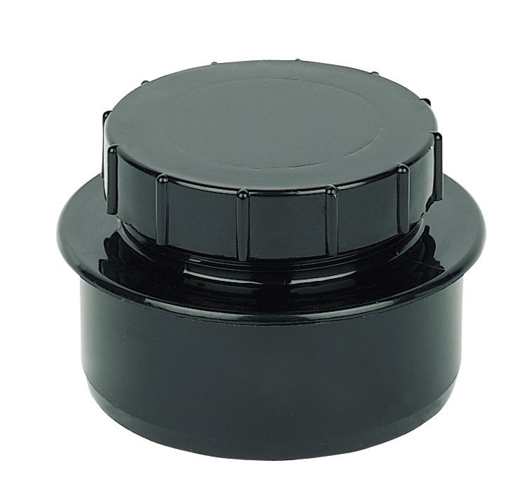

Your description of unscrewing the 'access thingy' suggests that you've got an access cap something like this

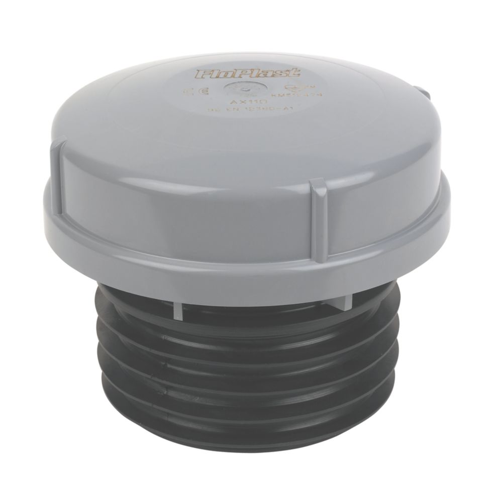

If you have an AAV it may look something like this
ae235
When you unscrew the 'thingy' is there a rubber diaphragm or do you look straight down the stack?
Either way, the likelihood is that you have a blockage.
Thanks newboy picture attached of access cap.
When i unscrew the access cap the toilet flushes with no problem, with the access cap on the water stays in the bowl and drains very slowly

you have a blockage/partial blockage - opening the cap allows the air to be released and the pan to empty.
The sewer/stack is filling up each time you discharge the pan.

When you remove the access cap you are relieving POSITIVE PRESSURE caused by a BLOCKAGE. By releasing the air the water can flow into the blocked pipework.
The AAV (if you have one) relieves negative pressure to prevent siphon-age from sanitary appliances.
The AAV does what it says on the tin, it is an Air Admittance Valve, it lets air IN. It shouldn't let air out as then sewer gases would also escape, and the house would stink.
You have a blockage further down the run. When you flush the WC the water cannot displace the air trapped in the pipework above the blockage, so the pan fills up. Removing the cap allows the air to escape, but the water is still building up behind the blockage. You need to look outside and find the inspection chamber, lift the lid and see what's going on.
