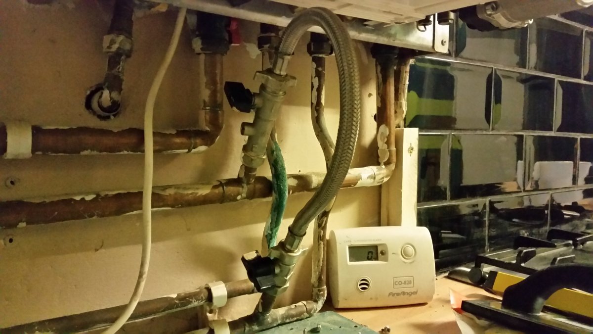

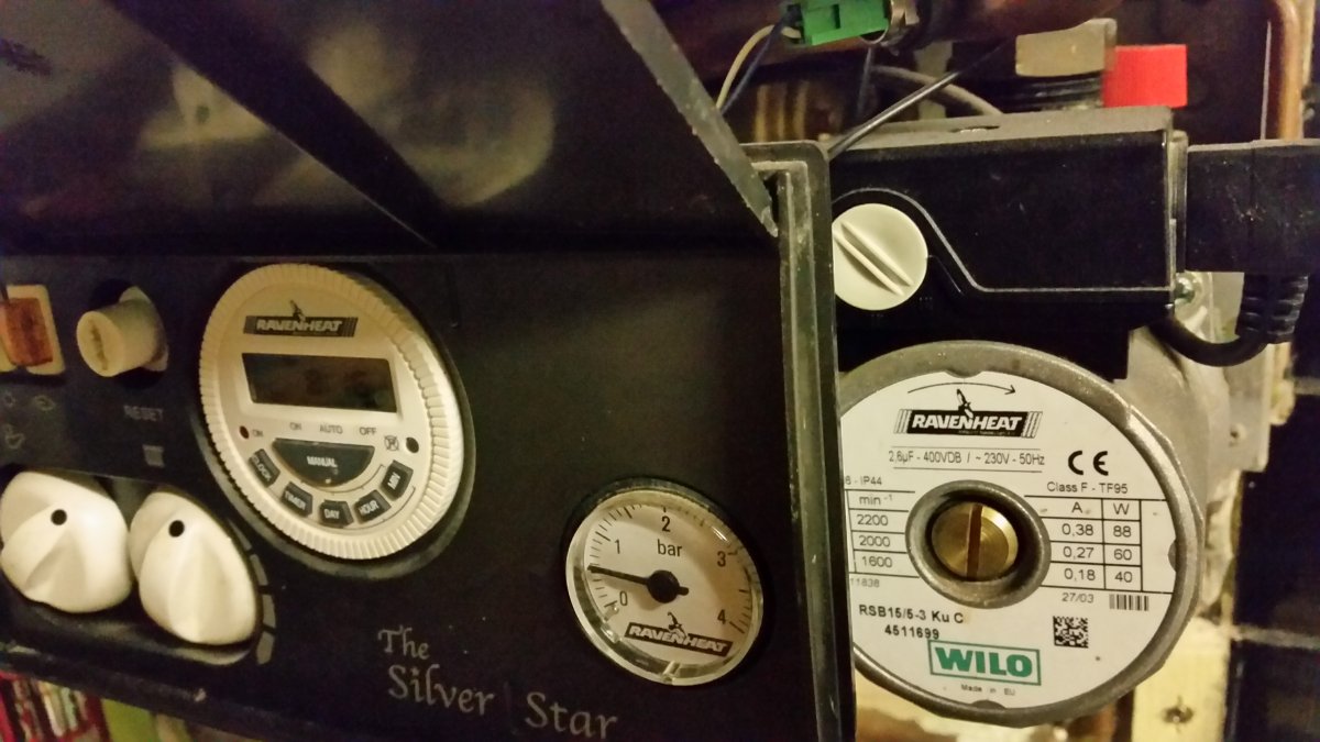

Hello All
I have a Ravenheat Silver star boiler and I know it is considered a poor boiler, I have had a lot of problems with pressure and airlocks within the system over the years, most winters in fact I have to go over the system but once working and in regular use it seems fine.
Now I have a problem where the boiler is losing pressure every hour or two and I see no visible leak although on the Flexi pipe filling loop the top handle spits a lot of water out every time i repressurise, could this be the issue, I can't see how as it only leaks when i'm adding pressure though it has gradually gone from dry to a drip to now too messy even with a cup under so regardless I'd appreciate help in replacing this (Will upload photos).
The other culprit could be the pressure release valve, we replaced that a few years ago and it was awkward, I believe we needed 3 wrenches and only had two as when we tightened two another part (of the pipe it sat on top of) would turn and so we took our time until we thought it was tight but I wasn't 100% happy but when we tested it worked fine and has done so until now, a similar loss of pressure was present before we replaced the valve so I guess I need to check this again?
I just figure replacing the flexi pipe is my first step, can i just replace the top part and reattach the pipe? It looks that way so I guess my only other questions are do any of you know what the part is and is that (top one is faulty) the hot or cold end, i'm guessing its hot which means I need to drain the system right?

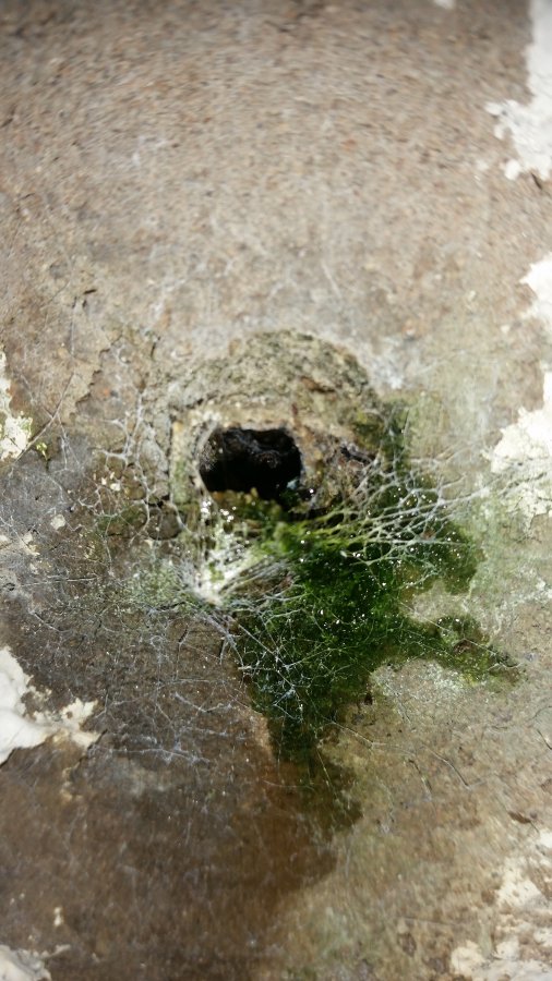

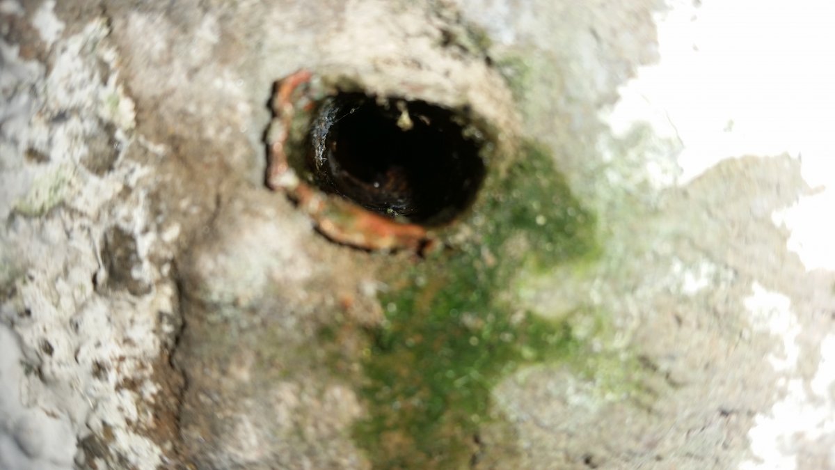

There should be a pipe going to the outside, is this dripping ? Also, when your heating is on does the pressure rise into the red section on your gauge ? And thirdly, do you never go to bed ?

If there are no visible signs of a leak anywhere apart from the filling loop as you turn it (this is common) and the pressure relief valve is discharging you will more than likely find you have a flat or burst expansion vessel in the boiler. This means that as the heating water gets hotter it expands more and if the expansion vessel is faulty the pressure will just build up and the pressure relief valve will just dump the water outside as a safety feature.

Hi Gigz,
1- there was a pipe until somebody stole it! now its just a hole in the wall but the snapped pipe edge is there so if anything you'd see a leak more clearly against the wall, it was a bit mucky but there appeared to only be a bit of condensation there so I guess it depends how much water your talking? the heating has been on a couple of hours, i'll post a couple of pics to see what you think.
2 - The pressure doesn't seem to rise when the heating is on though I remember there was a phase where i'd repressurise to around 2 1.5 to 2 bar and it would go up to 4 (max reading) I used to wonder why there was a delay in the pressure reading but I haven't seen this for a while?

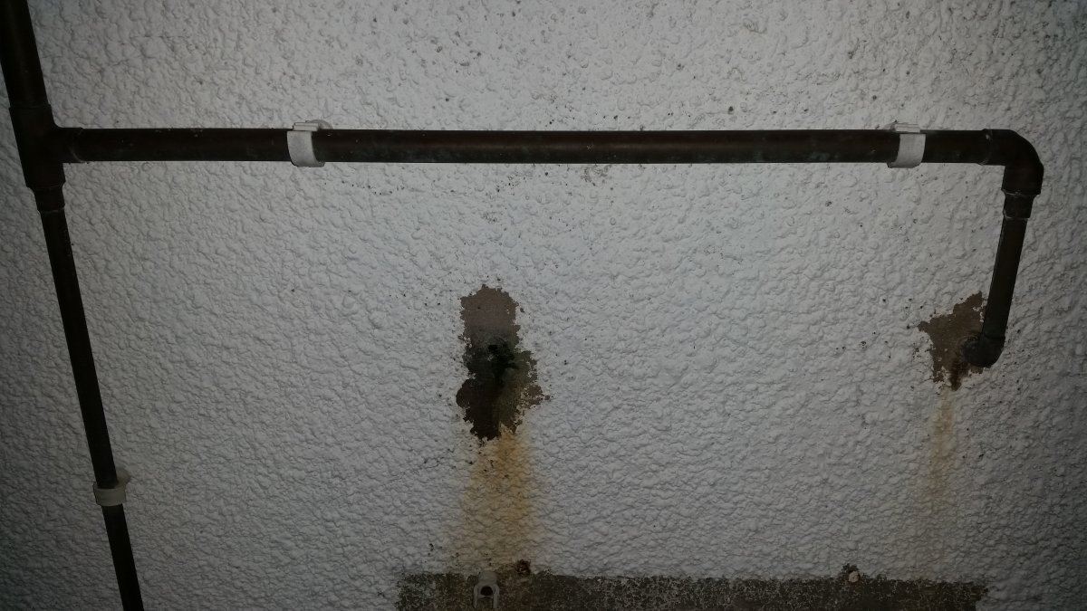

Found the leak, it's on the old rad in the utility room, the bottom corner has rusted and theres definitely some wet there so gonna get onto a mate now to see if he can replace that for me

Yeah, I should have seen that sooner but I was convinced it was on the boiler due to previous pressure problems, guess I learnt a lesson here though as I knew that rad was on it's way out.
