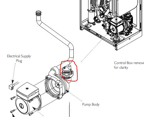

Ok so I successfully changed the pressure gauge, but now I have a new problem!!
There is now a leak from the automatic air vent, unbelievable. Please see pic of where it is coming out from.
It is leaking from the small cap where the air should escape from, it's a steady drip. It is dripping onto the side of the case and out of a screw hole.
Any ideas why water would be coming out of the vent? And how I can fix it?
