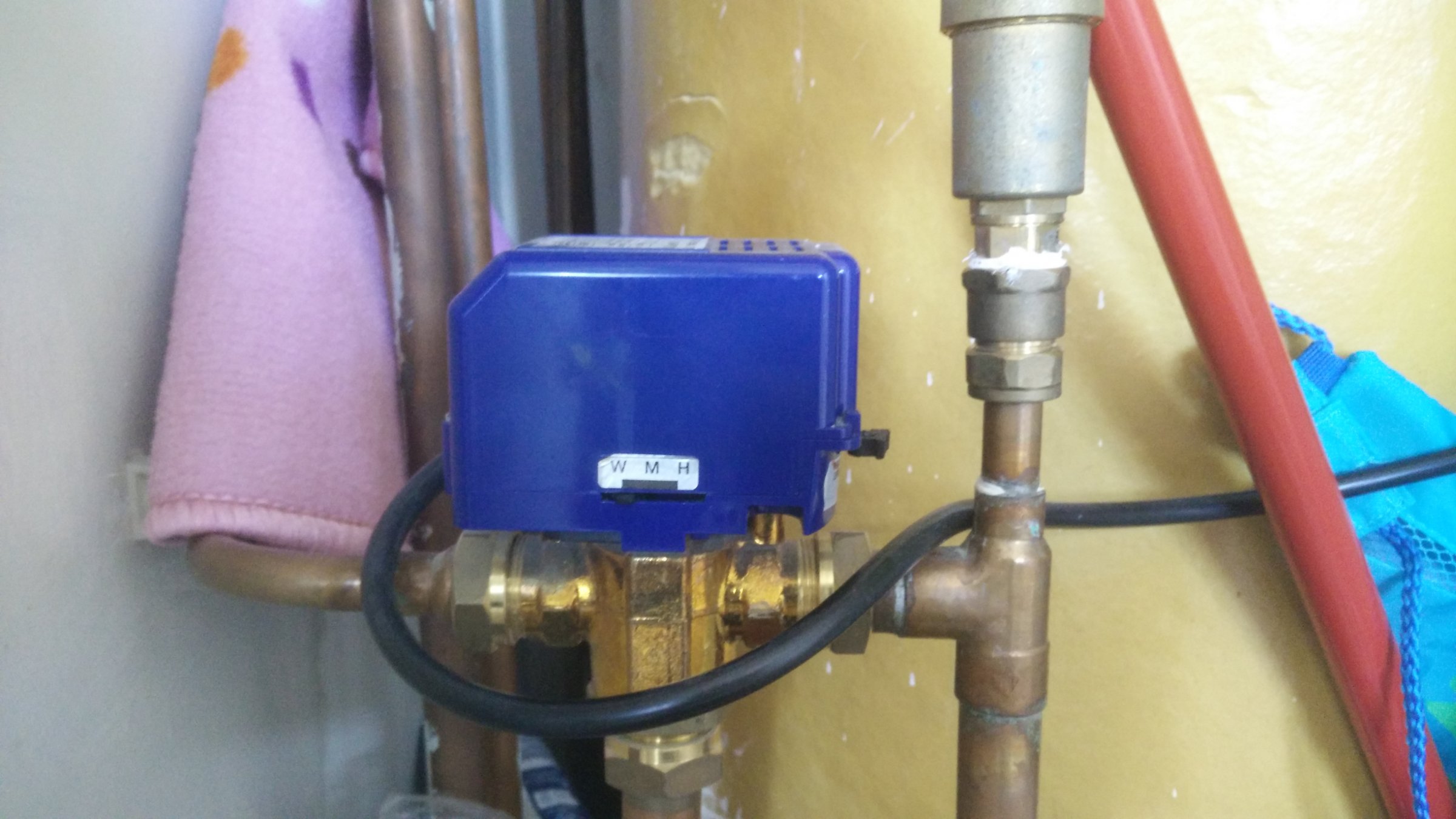

Hi,
Resurrecting an old thread, as I've got the same problem.
Basically, I want to know how to correctly remove the old wired thermostat.
Here's the wiring behind the thermostat:
There's 2 wires used, and the blue and earth as just dangling there.

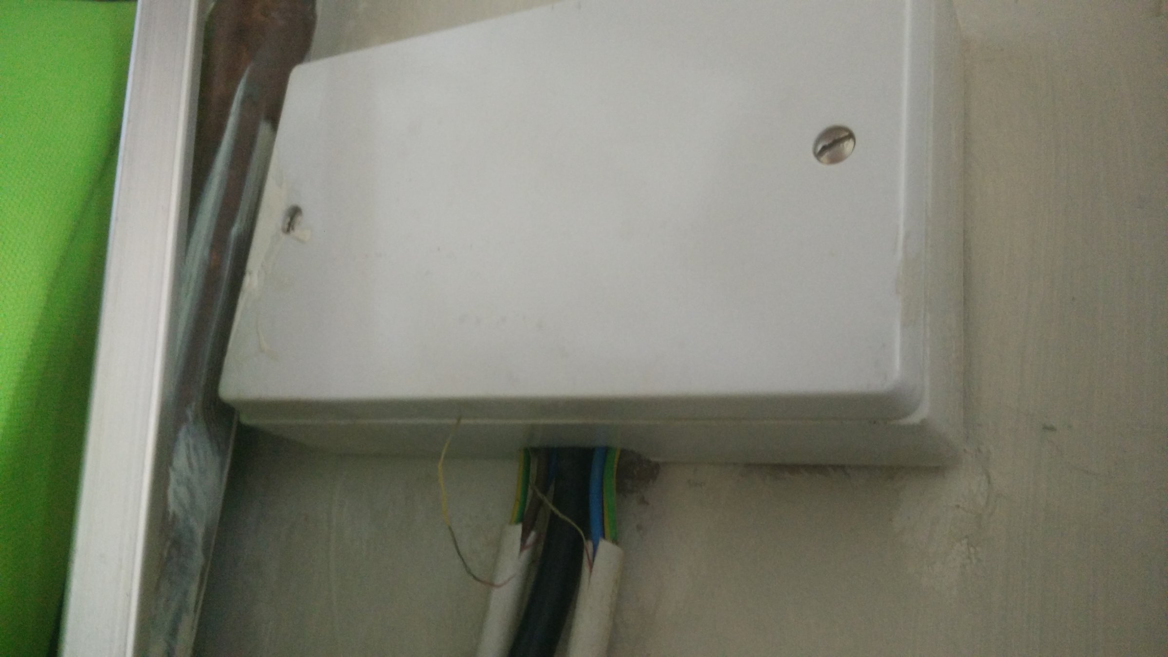

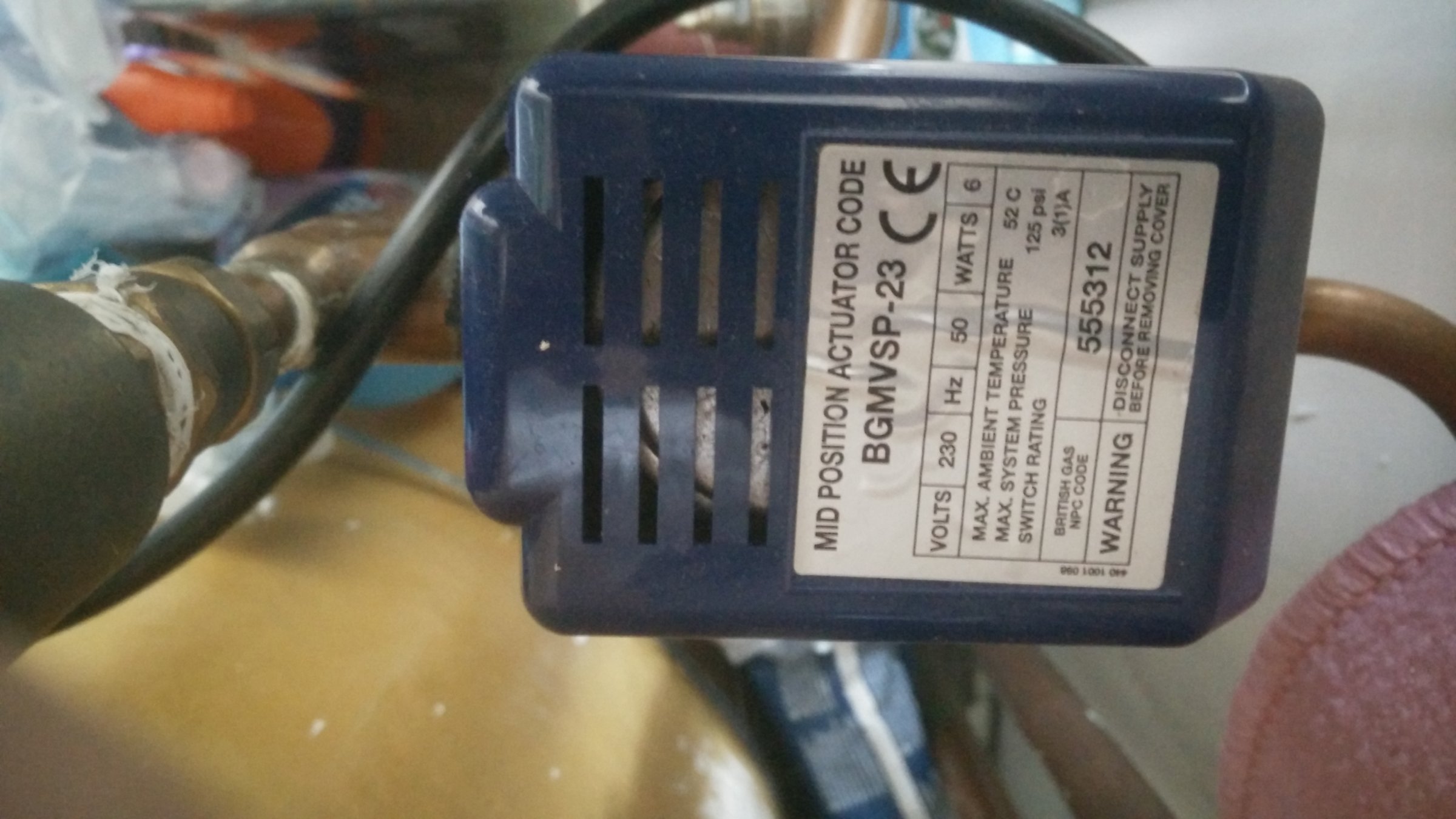

In the airing cupboard with the tank, is the following, which I believe is a 3-way valve:
And also in the airing cupboard, the black cable from the valve connects into this box:
(messy wiring underneath I know - it's not clamped within the box hence is just falling out)

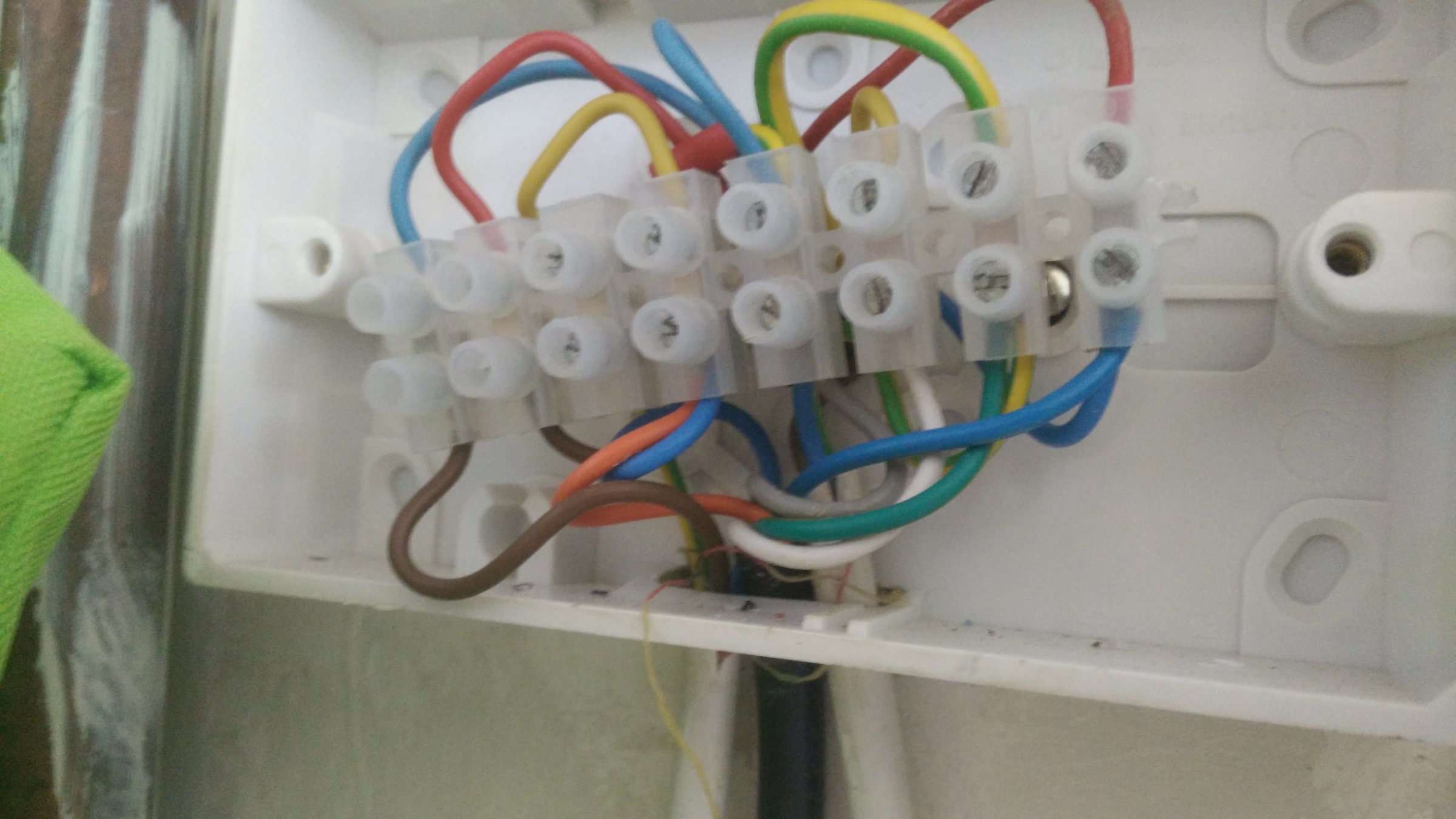

Within that controller box is:
So, am I correct in thinking these are the options I have:
option 1 - simply connect the 2 thermostat wires together, push it all back into the wall, and mount the new Hive wireless thermostat over the top.
This means I've got live cables in the wall still.
option 2 - somehow "disconnect" the thermostat completely, leaving the cables in the wall, but they would just be dead cables. I can then plaster over the old thermostat hole completely.
Option 1 - I can do, easy enough, but wont be as aesthetically pleasing, and has the risk of live cables in the wall.
Option 2 - sounds preferable, but I don't know how to do it :)
From the above post:
"You need to connect the White wire (central heating on) from the motorised head to your CH ON wire at the receiver / old prgrammer."
So, the white wire in the control box is joined up to another wire in the choc-box, and that then goes all the way down to the boiler control?
And I'd need to figure out which wire this is at the boiler controller end somehow (??), and wire it up to "CH ON"?
And the cable already in "CH ON" is currently wired up to the old thermostat, and that can just be disconnected?
Hope someone can help! :)
I've created a diagram of the wiring in the airing cupboard.
Can anyone help me work out how to correctly disable the wall thermostat?
Should I just disconnect all it's cables in the choc-block, and the move the white cable into the 8th choc-bloc position???

I removed the thermostat off the wall, connected the yellow and red wires together temporarily, and then tested various red and yellow wires in the junction box for a circuit - no joy. At that point, I gave up.
I recommend you try the same though. Do you have a multimeter?

The old thermostat can't simply be disconnected as this would leave the heating wiring 'open circuit' and it would not operate, the integrity of the circuit needs to be maintained. As not all thermostats are the same, or indeed wired the same, the specific instructions given to one poster may not apply to another. So, whilst the steps are the same, some working out will be required in each case.
1. Look at the wiring diagram for your make/mode of thermostat that you are removing. If you don't have the instructions for it, a diagram is usually printed inside the lid. This will show which are the two switching wires, and which is the neutral wire. (If there is a neutral present. Not all thermostats need or have one fitted)
2. Trace the thermostat cable back to its origin.
3. Take take a photo, or make a note of where the switching wires are connected at their origin.
4. Disconnect all of the wires going to the old thermostat and remove the cable and thermostat. All other wires to remain in place.
5. Insert a wire link between the terminals where the two switching wires have just been removed from, so that they are now electrically joined together.
