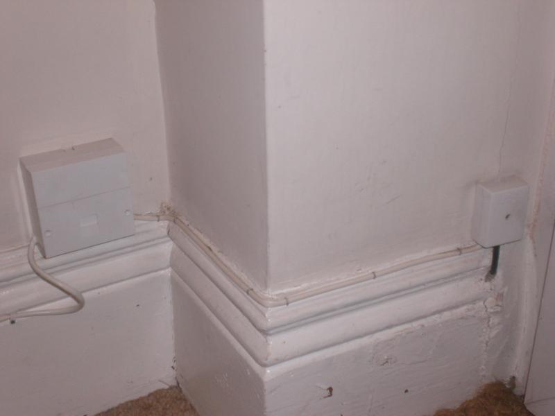

What is the internal phone wiring setup of the house like? it may be that something unconventional with your phone wiring is confusing the line checker.
Thanks for getting back to me.
The only wiring is as follows. The main box is right by the front door but that is unuseable due to there being no plug socket next to it.

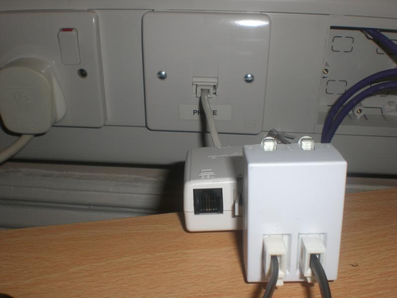

The phone/sky are setup as per the image attached.
Hope this helps.

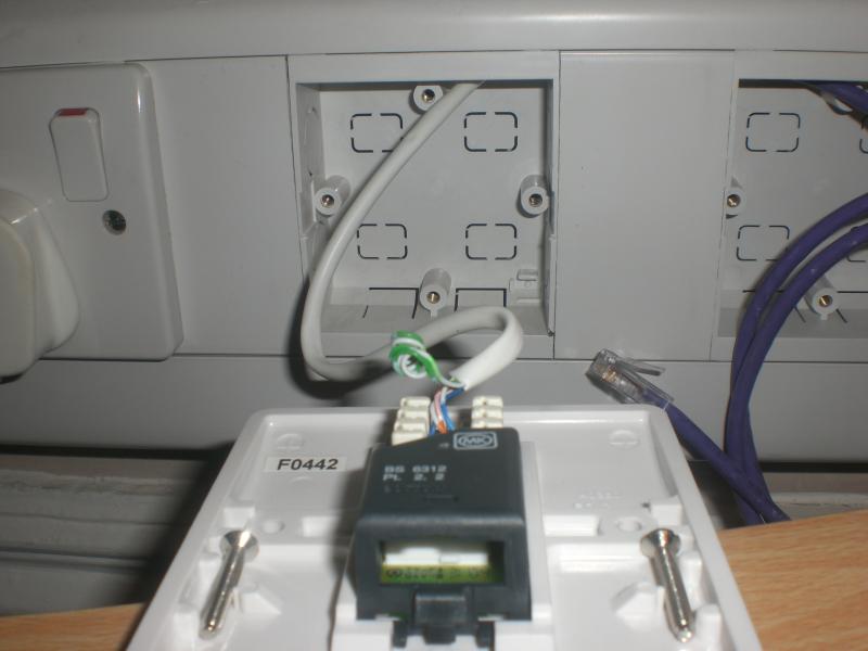

can you open up the socket in that trunking and check it is indeed an extension socket and not a second master.
No other phone sockets for other sky boxes, fax, phone, intruder alarm etc?
Everything in your pics is everything you have?
If so, something doesn't tally.
