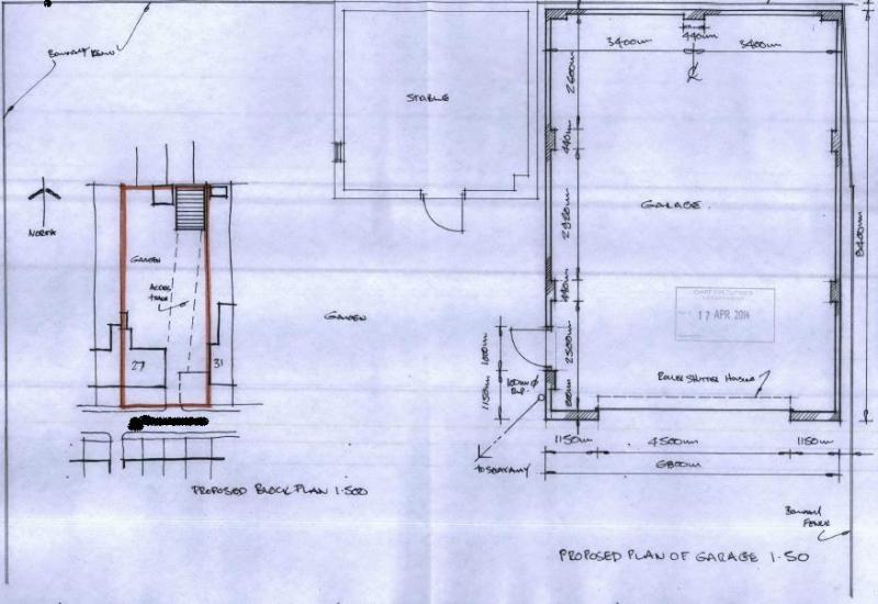

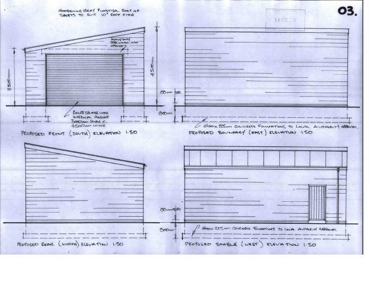

Hi,
I've just submitted a planning application to build a detached double garage in my garden.
Because the floor area exceeds 30m^2 i will need building control approval for this building.
What i'm wondering is if anyone happens to have any examples of what i need to send to building control?
For the planning application, i went on the local councils planning website and found other similar applications for double garages, and this showed me several useful examples of what was required, which was little more than a location plan, site plan and some elevation drawings.
However the building control part of the site doesnt disclose any of the application details, so i cant actually see what info i need to submit. I've picked up bits and bobs but i would really like to see a completed application pack to get an idea of whats required.
The provisional plan i've got for the building is a solid concrete floor with trench fill foundations, a few courses of brick or block then a timber frame for the walls from 6x2's filled with insulation. Externally i plan to attach metal lath and have it rendered to match the house, internally probably OSB then plasterboard. Roof is apex construction likely with trusses, but i want the "attic truss" style so i can use the loft area for storage.
Cheers
Kev

I've just been through this for my garage build and a full plans building regs application.
They wanted drawings of the concrete slab along with all calculations as we couldn't use trench fill foundations due to the proximity of some lleylandi trees. Calculations for lintels, truss design and calculations, spec of roofing felt, DPC and calculations for soak away.
Hope that helps a bit.

If you go for a simple construction Building Control won't want much in the way of drawings (if you're lucky). Timber frame is not a simple construction, concrete block is. I had some drawings done for planning and used those.
My garage (just getting into the roof) needed PP, then a stroll to building control- they told me how deep and how wide they wanted the foundations so did that. Roof- if I used manufactured trusses then no worries, if I went for joists they wanted calcs (I wanted joists for storage headroom so got the supplier to do the sums). Guttering- heavy clay round here so they told me to run a pipe from the garage to the house drainage 25metre trench- boo, But gets me a loo and a sink= hurrah! Lintels- again I used manufactured ones (concrete for personnel door, steel for roller shutter door)- they cost a bit more than random RSJs but they come with all the calcs done.
Roof detailing- just been speaking to them about that, restraint straps as the Approved Documents (though they want non-ferrous screws for the straps and if I trim them make sure I paint the ends with Galvafroid or similar, frame anchors rather than skew nailing from rafters to wallplate (easier to see and easier to fit for that matter) and cover flash over the corners.
You can do it on a building notice rather than full plans. Basically you just let them know what the project is and they visit at various points to check stuff. Of course if what you have done is wrong it'll need putting right, whereas with full plans as long as you follow the plan all will be well. They may ask for calcs and structural details but I think that would be unlikely for a garage if you use standard building practices. Are you putting in electrics? These will need approval, too, as would drains if applicable.

I know they're fugly but you have you thought about one of these steel-framed buildings- one idea I had on my build was to get a steel frame portal building and roof put up and then fill the sides in with whatever I liked (only wind loading to worry about rather than structural loads). With hindsight I'd explore that route in more detail- long span timber gets very expensive!
And Building Notice is the way I went- with it being a simple structure the guy who did the drawings just followed the Approved Documents for foundations, buttresses etc. and Building Control have been v helpful with my questions as the build has gone on (mostly phrased like 'Part x says this has to be done but the design won't allow that, would y work instead or is there another better way of doing it?' ). Our lot love being asked for advice.....
