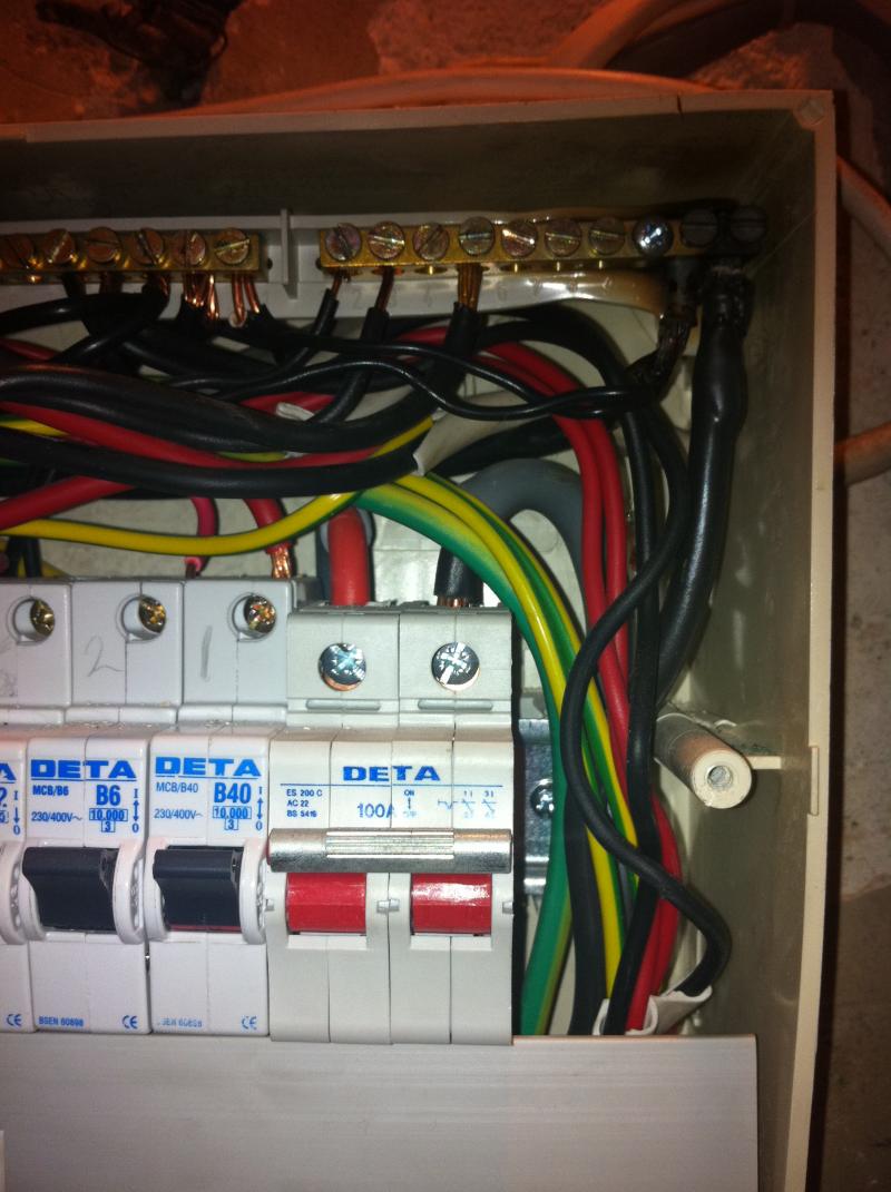

Dear All,
Just went into kicthen and could smell a sort of burning / bleach / ozone smell, hard to describe. Traced to undertsairs cupboard where consumer unit is located. When i put my hand on top of the cover it was very warm on the rhs so i carefully removed the cover.
Two cables have signs of overheating and the plastic mounting is slightly melted, please see photo.
This circuit includes the kitchen where i had both the dishwasher and kettle on at the same time when i noticed the smell, i have obviously switched everything off on this circuit and informed wife not to witch back on.

You need to get someone now.
Until then don't use any heavy load appliances.
Cheers guys, just been on checkatrade and called nearest sparks, answerphone so will give it 5 and try another. Bugger. Any west london / surrey sparks here?
Prob just a loose screw, judging by the poor quality of what I can see.
Yes first time cover has been off, it does not exactly look like a work of art! Sparkie coming in morning, sent picture and we had a chat on the phone, have thrown the fuses that are affected and CU is now cool and smell has gone.

Sparks arrived this afternoon, loose connection, cable replaced as was cream crackered. Checked all the other connections and were fine though he was deeply unimpressed with the state of the box and said it reeked of DIY.
Am going to get a PIR and new CU as current one only has single RCD and has several random holes in it.
