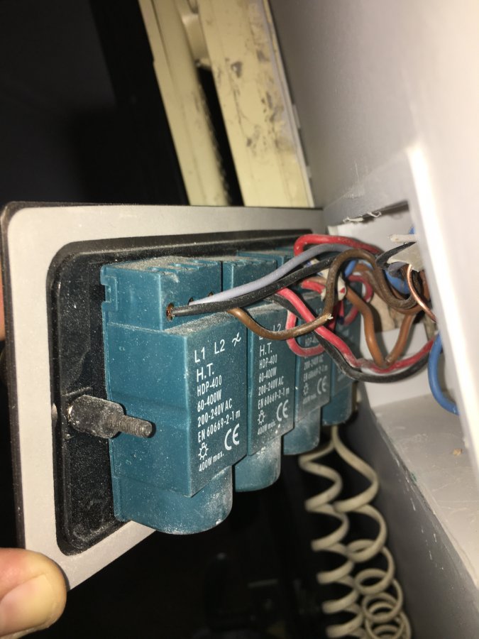

Hi,
I have recently (or rather, my electrician has) installed some buster & punch dimmers, link here: https://busterandpunch.com/products/4g-dimmer-all-finishes
For one of the 4-gang ones, I have it controlling 5 x 50 watt bulbs in halogen lights like these (http://www.nationallighting.co.uk/I...hts/12V-Halogen-Downlights/BOX-AR111/pid/2429), one 3-bulb fitting and one 2-bulb fitting. The other gangs control some various halogens too, but not as heavy a load.
The dimmer gives a pretty loud buzzing noise and I've called the supplier of the dimmer who says that a lot of people change the "module" at the back of the dimmer to get rid of the noise. This is what the back of the dimmer looks like, and I would like to know (attached image)
a) what exactly is this "module" called and where can I find it?
b) will I find a better one that doesn't give away the noise I am currently experiencing
Any comments on that these dimmers are expensive for the performance you get are not helpful - I like the way they look and will keep them :)
Any help with this would be appreciated

The buzzing is almost always create by a small coil in the dimmer module. The purpose of the coil is to reduce electrical interference. If the windings on the coil are loose then they vibrate and this creates the buzzing noise.
The module is called a two way dimmer module. Tye number is HDP-400 and the manufacturer / importer is Denmans,
The one dimmer module on this item from Wickes may be the same as the modules used in your 4 gang plate.
http://www.wickes.co.uk/Push-Dimmer-1-Gang-2-Way-White-60-400VA/p/195127
@bernardgreen thank you for that. So are you suggesting that the HDP-400 supplied by Denmans normally doesn't give the noise and I should try to track those down to replace my current ones?
@iggifier Sorry I don't understand, what do you suggest I do?
I haven't enough experience of that dimmer to pass comment. Good quality dimmers would have the coil winding coated with resin or other means to prevent the coil vibrating.
@Iggifer Thank you I have bought a couple of these now and will try to see if it makes a difference

Do I see a nick on the insulation of the brown wire and an unsleeved earth ? Are you sure he's an electrician?
