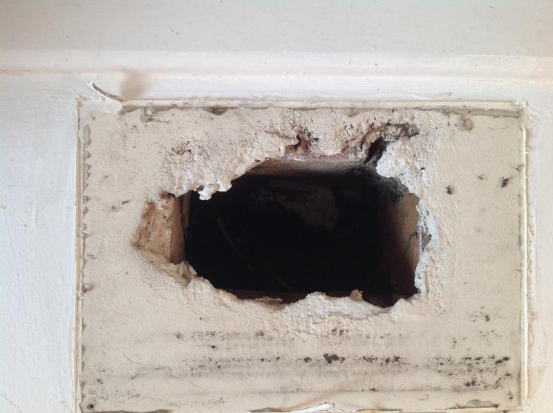

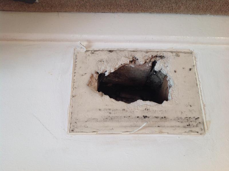

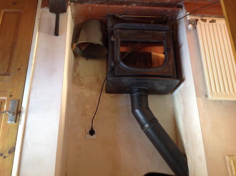

I have recently moved into a 1950s house that already has a woodburner in the kitchen (think it was fitted to replace a range or old style boiler), however I would love one in the living room.
There was a plastic vent fitted in the wall the opposite side of where the woodburner in fitted in the kitchen. It's back to back to the wall where I want one fitting.
Taking the vent off as you can hopefully see has revealed a hole with loads of ash and sticks in so think there is obviously a chimney going off it.
Do people think with some building work that a woodburner could be fitted in this space?
Who would be best to approach? A stove fitting company or a builder? Would they be able to advise me as to the possibility?
Cheers in advance
Rob
Sorry the photos are upside down. :oops:
I'm sure anything is possible Rob, but your wood burner needs to be surrounded completely with brick, including the sides and hearth.
If this can be provided, and a chimney lined, you are in with a chance!
John :)
John :)
Cheers for the response john.
There is loads of twigs and ash in the hole so I think there is definitely a chimney behind it. When you say chimney lined is that the metal tube you can put down?
The hole has bricks either side and at the back. Would it be a chase of smashing a load out to make a hole big enough and putting lintels or steels in for support as needed.
Would a burner fitter be able to do the whole thing or would I need a builder to do all the work?
Cheers for the help
