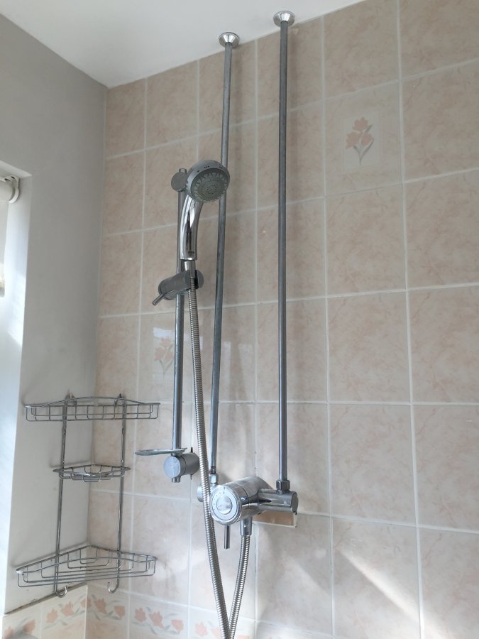

Hi all,
I am buying a house in a weeks time and will be refitting the bathroom on a budget.
The pipes from this shower to the ceiling are ugly. Can I sink pipes into the wall, and somehow bring them back out just above the shower? Or is it possible to alter the shower so that the pipes enter via the back?
I think it's a Mira, but can't totally tell from the photo.

You can Tim.....if you plan to retile. What's behind that wall......is it a stud wall, by any chance?
Its usually possible to swing the inlets back over so they enter through the wall but you'll need something to surround the pipes where they are seen.

Thanks John,
I will be removing the tiles and replacing with aqua panels.
Can you see on this unit how they could be swung? It looks solid to me.
I'm sure I can come up with a way to hide a visible bit!

It looks like a Mira Elements valve, if it is the inlets can be altered so it can be top, bottom or rear feed.
The H & C inlets rotate and are "locked" in place by a grub screw (Allen key) located adjacent to the compression fitting.
Found this, it may help identify the valve.
http://www.mirashowers.co.uk/onlinecatalog/pdf/1143423_w2_a_mira_element_slt.pdf
Excellent, many thanks!
So I think all I need to buy is a pair of suitable covers to conceal the pipes? Plastic ones for Central Heating 15m pipes would do I expect? Ill see if I can locate some Mira ones online though.

It was changed to a pressurised system a few years back I am told, so may be the case. It is an older house though, 1959 vintage, so I reckon it may have just never had a shower, and to avoid a load of work they just surface fitted the whole lot? The patch behind is a mystery, unless you are correct and there was an older unit, but judging by the age of everything else I am a bit sceptical!

Spare part numbers are shown towards the back of the PDF that I linked to. Looks like the covers come as a pack with the compression nuts.
Part ref. 1656.117 Inlet Connector Pack

Spot on, found it through showerspares.com . The schematic also shows 1656.164 - Multitool (https://www.showerspares.com/search/mira_multi-tool_1656.164/) , do you think one of these will be necessary?
Thanks again, your help has been invaluable!
