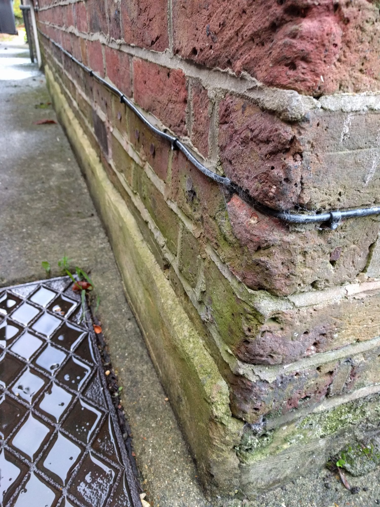

I am an amateur, and looking for some advice about what I think was a DIY 'improvement' by a previous owner. When I moved in there was damp registered on one wall of a single room - only very recently have I realised that on the external side of that wall, a concrete render has been applied from ground level up by about 200mm, and so bridges the DPC. I now know that this is most certainly the cause of the damp in that room (although please say if I'm wrong!).
It is just an 8ft section of the external wall - I'm wondering what the repercussions of me chiseling off the top 60mm of the render would be, and whether this would be a satisfactory solution to the damp rising?
From reading, I suspect that the render was used to cover up frozen brick damage - I'm not hugely bothered by the aesthetics of them, but I know they can cause other problems. Is this a reason not to remove the render, am I ok to try it and find out, and if there are frozen bricks behind how quickly must I react to replace/fix them?

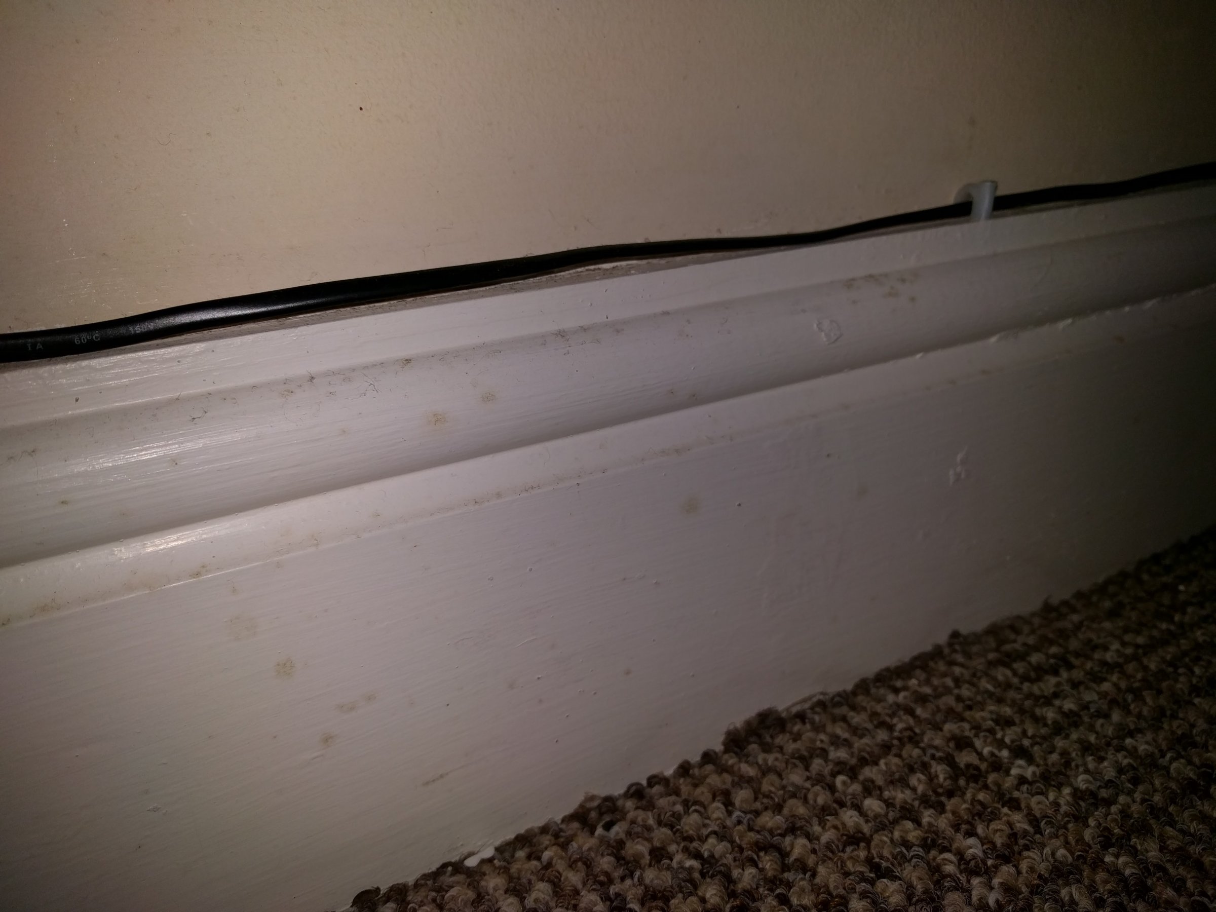

Hi Roy, thanks for the quick reply. See attached some photos and a few answers to your questions - thanks for your help!
- The room in which the damp is has had a dehumidifier running since I moved in. the photo of the skirting board is the wall shown with the low level render outside - no other walls in the same room show the same evidence of damp.
- I've lived in the house for 5 years. I'm not aware of any damp elsewhere in the house. After I moved in this room had the lower 1m of plaster removed internally and some chemical treatment injected into the brickwork before replaster and decorating, so that photo is about 5 years of damp's worth. I'm aware that I should have researched reasons for the damp before attempting a fix... first time buyer, building amateur, lesson learnt.

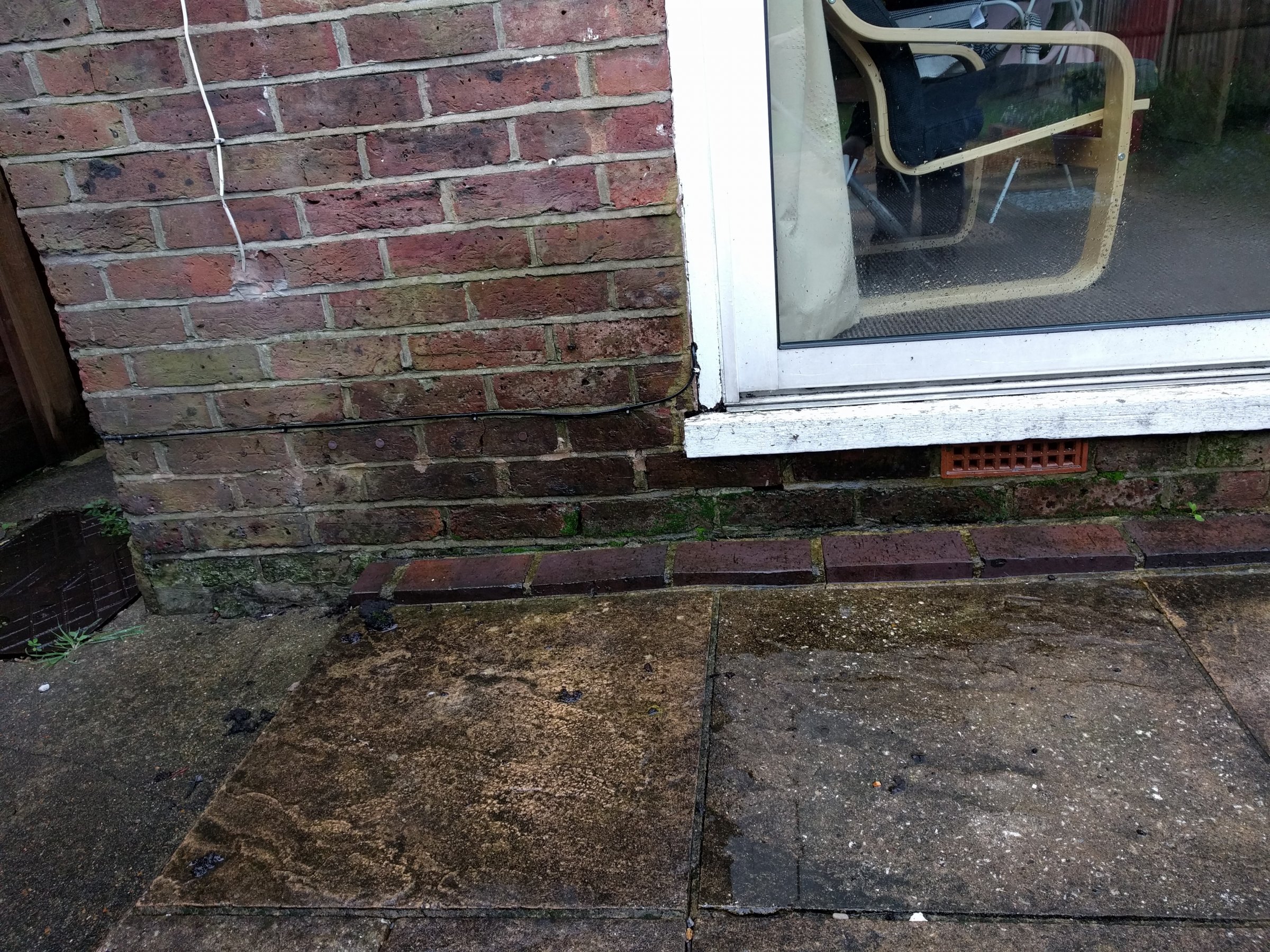

- I think the floor indoors is higher than the DPC (see airbrick position) - apologies for the photos, it was raining when I took them so sorry if that's confused anything. I'm aware that the paving in the back garden has been laid on top of the original 'ground' outside, so if removing the bricks nearest the wall is something that needs doing that's not a problem; but I'm reasonably happy that the concrete path against the wall with the rendered section is original, or at least at original height.

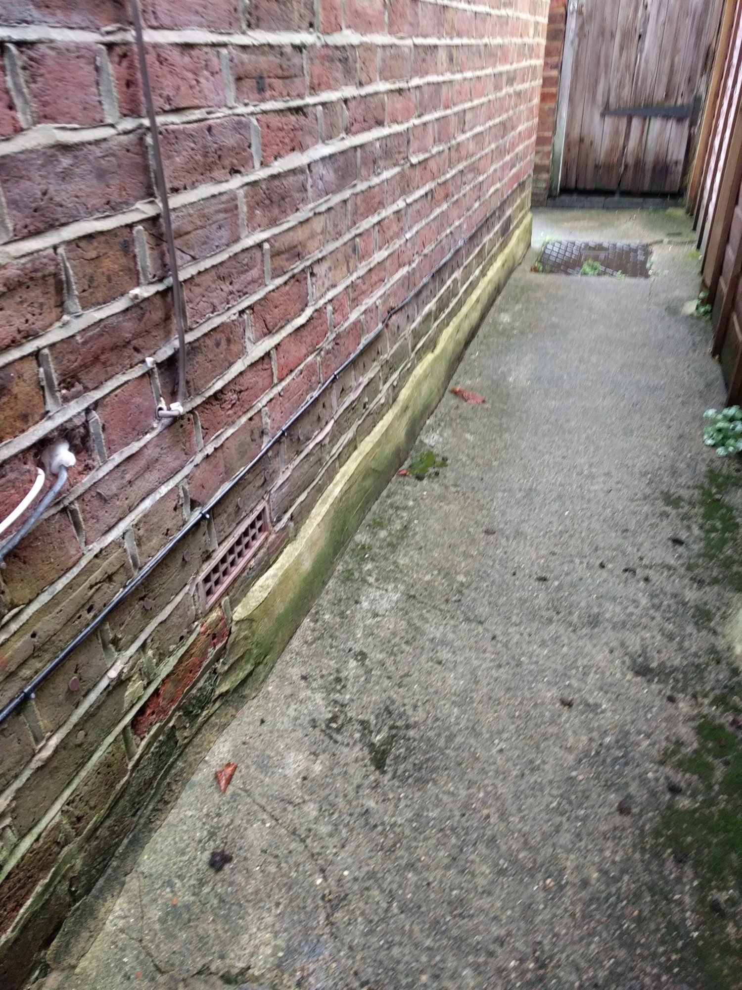

The low level sand & cement plinth needs removing completely from wherever round the house.
You need more air bricks - 10 x 6 plastic a/b's.
The skirting shows spotting - it could be from damp penetration.

I dont think that the ground level is too high but then I cant see your DPC (where is it?) to really judge.
Perhaps the bricks should be removed? The air brick below the door is new.

Replacing bricks here & there is no big problem or big hurry.

- Thanks for confirming what I thought about the sand/cement plinth; I'm confident (based on other stuff around the house) that this was a DIY cosmetic addition by a previous owner, so I shall remove it. Thanks for confirming that if there's frozen/damaged bricks underneath it is not too urgent that I replace them (although I will ASAP) - i.e. it is better to remove the plinth/render than leave the bricks covered.
- I also struggle to see the DPC myself (will have a closer look tonight), but I believe that it is at the layer of mortar just covered by the sand/cement plinth. I think this means that the path down the side of the house (where the plinth is shown) is probably a bit higher than ideal but definitely below the DPC. However now I'm looking at it more closely the bricks/paving at the back of the house are definitely too high. If I remove the bricks, should I just leave a gap between the paving and the wall (I'd fill in some of it so it wasn't a trip hazard, but make sure it wasn't touching the wall any more)?

I think by the look off the bricks that most of the faces of the bricks have eroded over time and without the faces it has made the bricks quite porous. Maybe worth getting some prices for having the house rendered or dashed.(lf there are any other houses that have been dashed )Dash will disperse water better than flat render. Have a look around your area and see what other people have done .Even knock on their doors and ask if they have had any problems with damp.Might give you a few ideas....
