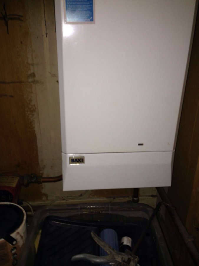

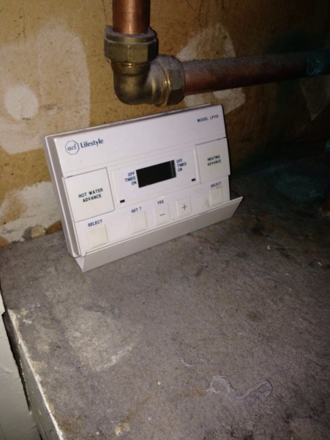

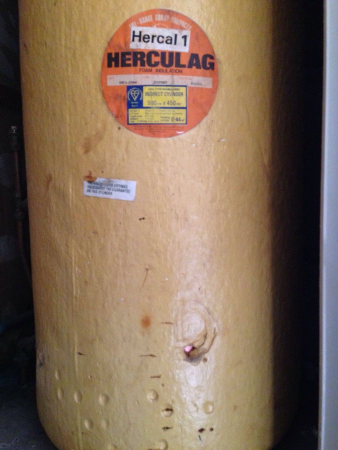

Hi all, thanks for all the replies. My wife was down at the house today I asked her to take a few pictures, sorry they aren't great but they might help clarify the setup.
We already knew what setup you have, although your pictures have confirmed it. Standard boiler and vented cylinder setup a seen all across the country
