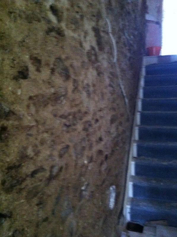

Unfortunately it is a rubble stone wall, not nicely placed granite. So a cover up with some sort of render to create a smooth finish is essential.
Here is a pic of the internal wall, the external wall will be of similar construction.
When I say a lime slurry, I effectively mean a thick lime wash, which will show the contours of the stone/rubble, however cover it thickly in something that can breathe.
Nothing with cement in will breathe at all. Same as adding cement to a lime mix, it doesn't allow it to breathe.
By cementing the outside, then covering the inside in gypsum plaster the wall has no way to breathe so any moisture will find its own way out creating other problems and weakening the wall.
Its a good way of masking a problem so you don't have to see it or think about it for a number of years.

If you can remember Who told to that you could 'seal' the inside with a gypsum plaster, disregard this .
Points you list are generally sensible, but only you will have to decide what you can pay.
Gypsum is perfect for drawing out moisture, which is why it should never be used in damp areas! it is a cosmetic application, and will not seal anything up.The wall will 'breathe' alright, then furr up with salts and degrade over time
