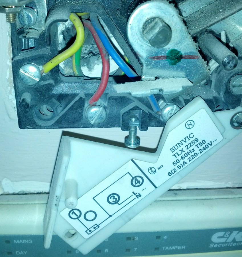

My old thermostat is a mechanical one and looks like this:

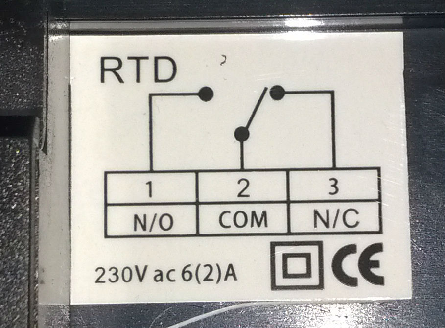

I'm replacing it with a digital one, here is the wiring diagram on it:
From what I reckon, the old one has:
1 = permanent live
3 = switched live
4 = neutral
Am I correct in thinking that on the new one it's:
1 = permanent live
2 = switched live
3 = neutral
Original has a neutral which is not required with new one which can be used for heating or cooling so either N/O (normally open) or N/C (normally closed) is used depending on if the device heats or cools. With mine I know no battery and there is no heat so the heat must be N/O when it wants heat they must close but it is rather a silly marking CH and AC would be far better.
Red number 2 and yellow number 3 on yer new stat.
Blue not needed so make the end safe and tuck in box.
I've done that and it seems to be working in the opposite direction. When it's set to a low temp, the fire icon is off but the heating comes on. When I set it to a high temp, the fire icon comes on but the heating is off.
Looks like it's working in cooling mode?
Maybe I should use the blue wire, or connect the yellow one to 1 instead of 3?
