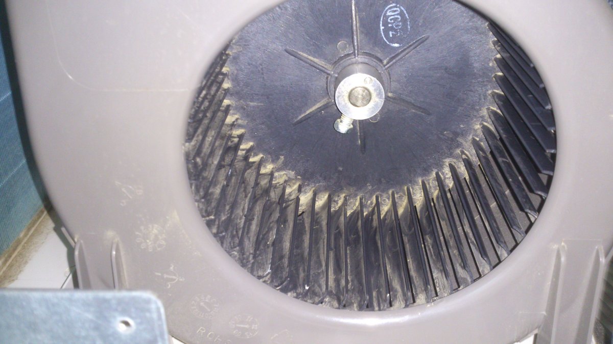

Lat year I bought a used portable A/C unit but realised when I got it home that it had been used in a building environment and had taken in a lot of concrete dust. I opened the unit up and cleaned a lot of the conrete dust from anywhere I could access, but it is very difficult to remove it from the fan blades. Hence when I used the unit after cleaning it continued to generate a smell and when I opened it again this year I found there was a fine layer of dust on the inside of the plastic unit - although not half as bad as it was the last time.

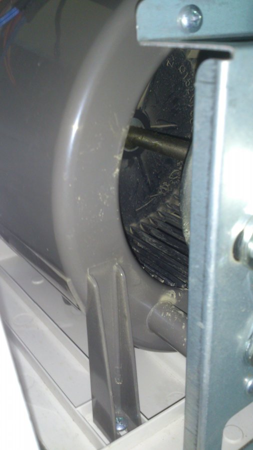

Anyway, I have attached a couple of photos. On one side I can get good access to the fan, but on the other the motor is in the way which gives me a tiny amount of access - maybe an inch on either side of the motor.
Does anyone know what would most effectively clean this off the fan blades?
I have seen recommendation for isopropyl alcohol 99%, but there are also specialised concrete cleaning fluids that claim to dissolve concrete like "belle clean". I have the added joy that I don't want to use any acid that might harm the fan, and I need to make sure I don't damage the motor or the shaft that is goes through one side of the fan and is bolted to the other side in the photo.
Also, if anyone knows what kind of cleaning brush works well that would help. Are the flexible radiator brushes any good?

It's a good idea. The thing is I am not going to hike the unit there as I have no car. If I start to take it apart to get to the fan blades I have the trouble of dismantling and detaching the motor, the shaft, the plastic casing and the screws that attach the unit to the body. I could probably manage it, but it would be a nightmare. I managed to change the bearings on a washing machine a few years back, but these big jobs don't come naturally to me.
you can probably get it off with a soft paintbrush, warm water and WUL, and a small garden sprayer to rinse it away. You need to position and tilt it so the dirty water will run out of the machine and not into moving or electrical parts.

Thanks for the suggestions. Washing up liquid didn't have much of an effect when I tried it a few days ago. I can try compressed air, but I suspect it will be the same. The dirt that is there seems to be ingrained enough that it won't shift even with rigorous brushing, but when the fan is running at full speed some of it seems to get released - enough to cause a fine layer of dust on the inside of the machine - and probably in the air it blows out as well.

I am now thinking about removing the entire motor and plastic housing that the fan blades are kept in. I think it is possible - my main concern is the retaining bolt you see in the first photo that goes into the side of the shaft. I wonder if that has to be tightened to some exact torque setting?
Just tighten that screw enough so that it bites on the motor shaft.....it isn't critical.

It really needs the blade off and dropping in a bucket of brick acid to clean [won't harm plastic blade].
In situ then a small dremel type tool with a mini wire brush may remove.[vacuum away dust] I would not use air as I cannot see it having any effect on dried cement and if it did you might be blowing it into the machine causing more problems.

I can't see any purpose in using solvents. It isn't grease, it's dust. I have got builders dust off heaps of things by sponging or scrubbing with warm water and WUL. If the material is plastic it will not be adhering very firmly.
Just an update on this for anyone who needs to clean concrete dust off of plastic. I found warm water and washing up liquid really got rid of it quite easily - I had used old toothbrushes and a "spout cleaner" from Robert Dyas for the harder to reach parts. I had first of all tried white vinegar and although it removed a small amount of the residue it was ineffective overall and a lot of hard work. Thank God I didn't buy or try to use any harsh chemicals.
I don't know how to attach images on this forum now, but the fan unit was clean to the naked eye. A camera flash still brought up a few marks, but there was no longer any dust flying off the unit.
