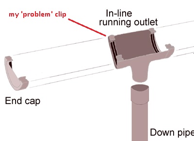

Hi. Rainwater was leaking from the gutter so I removed the joint, cleaned it out, checked the seal then went to reassemble it. Is there a knack to clipping it back together? I just cannot get the last clip in. This pic I found online is exactly the gutter style I have.
I should say that I THINK the clip in question was undone to start with (wish I'd taken a closer look before I took it off). Maybe the builder had the same problem 22 years ago...
Any tips gratefully accepted.
Back of the gutter in first then use the "tab" at the front to spread the clip, some can be right b******s to get in.
If you have any silicone spray lubricate it with that if not a smear of fairy liquid (other brands of liquids are available;)) should help, avoid things like Vaseline or oils as they may affect the seal.
Fingers in the gutter and thumbs against the clip usually works, please do not fall of the ladder if you need two hands! I don't want to hear you are in flat out in bed and wanting to know how to fix the telly to the ceiling in another post!:):)
If you are still struggling after that advice then you can take out the rubber seal and cut half inch of it and try again.

The fairy liquid was a good idea but, unfortunately, job not yet done. Whichever clip I force in, the opposite one pops out. But I don't think it could ever work – the open end of the short bit of gutter is clearly too big to fit. Perhaps it became warped, expanded or was badly cut from day one?
I've left it with the rear clip unfitted and will await the next downpour. Hopefully, the cleaning out of the gunge will have had some benefit. Otherwise, maybe I could try shaving a bit of the gutter off. Or buy a new endsection.

Are you sure the gutter is being pushed behind the rear clip properly.
Kind of roll the gutter into the back first, making sure its seated behind the clip.
I've found the problem! I took a close look at the rubber seal and it was obvious (from looking down the barrel of it, if you see what I mean) that it had 'given'. The result was that it wasn't sitting as flush in the groove as it should be. The other end wasn't too bad so I cut a couple of inches off and pushed the remainder firmly in. The gutter is now reassembled although the final 'click' wasn't as satisfying as the others. But it's in and I await the next downpour...
