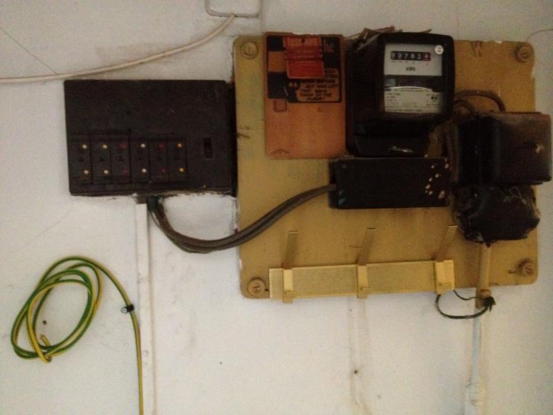

Good morning all,
My gas pipe isn't bonded to the consumer unit so I've run the cable from the gas pipe upto the consumer unit internally, but I'm just looking for some advice on the final connection.
If I remove the fuses and unscrew the face plate of my consumer unit will I find a nice main earthing terminal or do I need some sort of additional adaptor?
Thanks in advance
there will be an earth bar but it may be difficult to connect modern larger earth cables to it. What size is your new bonding cable?
I think 10mm will fit in the earth bar of an old wylex, pretty sure 16mm won't.

Thanks again Pugwash, yes I've read some horror stories about these CU and hence my nervous approach to taking off the cover. Do you have a picture of what I'll expect to see when I open it? (just so I can perpare myself and don't have to open it twice!).

If in doubt, don't even take the lid off. Many of those old wylexs have an exposed bus bar, even the incoming tails can have exposed parts at the terminals.
Also, i think you might have difficulty getting a 10mm into the earth bar. I don't think the terminal holes are big enough for 10mm.
Where i have added bonding in a situation like yours, I tend to use a earth block and take the earth conductor and the bonding conductors directly to that. Then take the largest size g/y single (probably 6mm) from the earth bar in the board to the new earth block.
Is you water service bonded?
Can't quite tell, but is that a pipe clamp fitted to the incoming service sheath? If so, give your DNO a call. They should come out to modify/improve it.

I'm amazed your bothered about gas bonding on the instalation. I would have thought there were other things to worry about.
So don't risk your life for the sake of some bonding.
Also make sure you leave plenty of slack on that earth cable, so it can go into a new CU one day.
I've put 10mm into the line and neutral in those boards before, so I'm sure you'll be OK.
Just turn it off at the main switch and be careful. Treat everything as live.
I would never advise a diyer to go opening an old wylex.
Even with the main switch off there is a big live lump of brass 3mm away from a large neutral lump. It is just too easy for things to go very wrong.
Why not turn off the main switch, cut the main earth and terminate both ends into a new earth block along with the new bonding cable.

I'd agree with not bothering if we didn't need a gas safety inspection as foster carers and it was an advisor last year and therefore a requirement this year!

Thanks both and I agree, I'll open the cover and assess the situation, any idea how much I should expect to pay if I have to get a sparky in?
