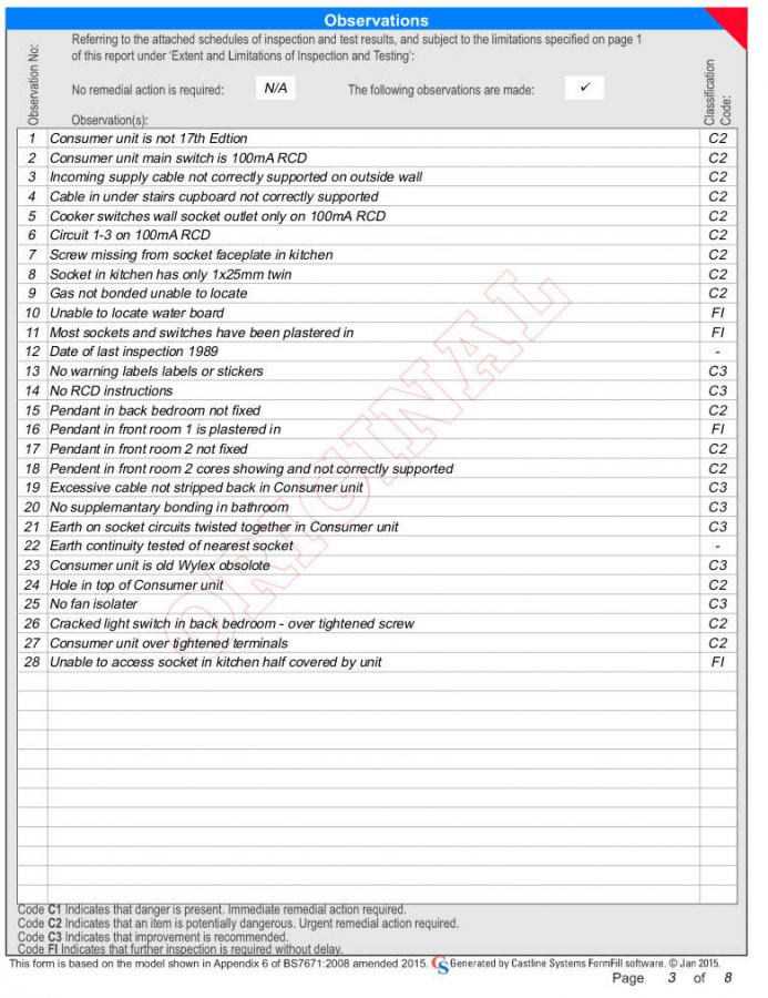

I have just had an Eicr done as I'm letting out the house.
The electrician has stated the following points as c2. My consumer unit apparently is an old Wylex one.
- consumer unit not 17th edition.
- consumer unit main switch is 100ma
- cooker switches wall socket outlet only on 100ma
- circuit 1-3 on 100ma rcd
Do I really need to get a new consumer unit? Will the old consumer have a high risk to catch fire easily?

If those are actually listed as Observations on the Report then it leaves a lot to be desired as it should only mention specific non-compliances with Regulations. (There is no such thing as a "17th Edition consumer unit" for example - there are merely Requirements in the 17th Edition with which an installation should comply.)

See attached image of report listing issues and consumer unit.
Report summary was "Original wiring is in good condition however upgrade works are required and other remedial works."

What is the "water board"?
The incoming supply cable is the DNO's responsibility.
What does "socket in kitchen has only 1 x 25mm twin" mean?
Could he possibly mean 2.5mm²? Are not sockets allowed to be fed via one 2.5mm² cable?
What does "earth continuity tested of nearest socket" mean? There is no code for that.
It is a very sloppy report. Stop your payment and demand a proper report.
Also lack of supplementary bonding where there is no additional protection by a 30mA RCD is a bit more serious than "C3".
Very, very poor Report. Earths (sic) - I presume he means cpcs - twisted together in the distribution board may be a crap practice but you would struggle to find a prohibition.

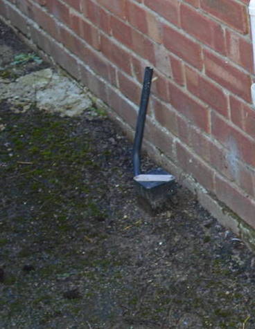

There is also an earth rod on the outside of the wall behind the consumer unit. See picture, what is it? and what is it there for? The earth wire is attached to the consumer unit, so should I still do the gas / water bonding?
Thanks.

The electrician was Part P and in there for an hour.
As an aside, Part P is a Building Regulation, not an electrical qualification.
And there is no guarantee that the guy had any skills, experience or qualifications relevant to carrying out inspections.
I have paid 95 plus VAT.
Ah - peanuts and monkeys, monkeys and peanuts.....
I found the electrician online via his professional looking website
Anybody can get one of those. You could, for a few £'00 and some photos stolen from other sites on the internet. (Yes, people do).
For £114 you have to decide if it's worth your time and effort to take the guy to court to try and get it back, or just chalk it up to experience and a reminder that there is more than a grain of truth in the old saying "good work isn't cheap and cheap work isn't good".
