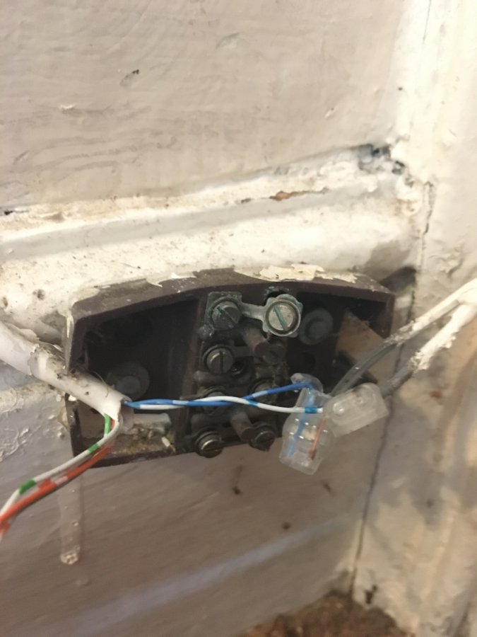

I apologise for the double post, I wanted to add some photos for reference here. Thanks again for any help.

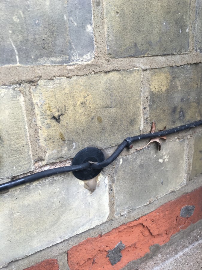

Outside the house, black wire going out of shot to the left is as follows in the next picture.
This is the entry point into the back of the NTL socket, the wire going out to the left enters near the front door to the next picture.
Wire enters house into this box, wire goes through wall and into the "BT" box.

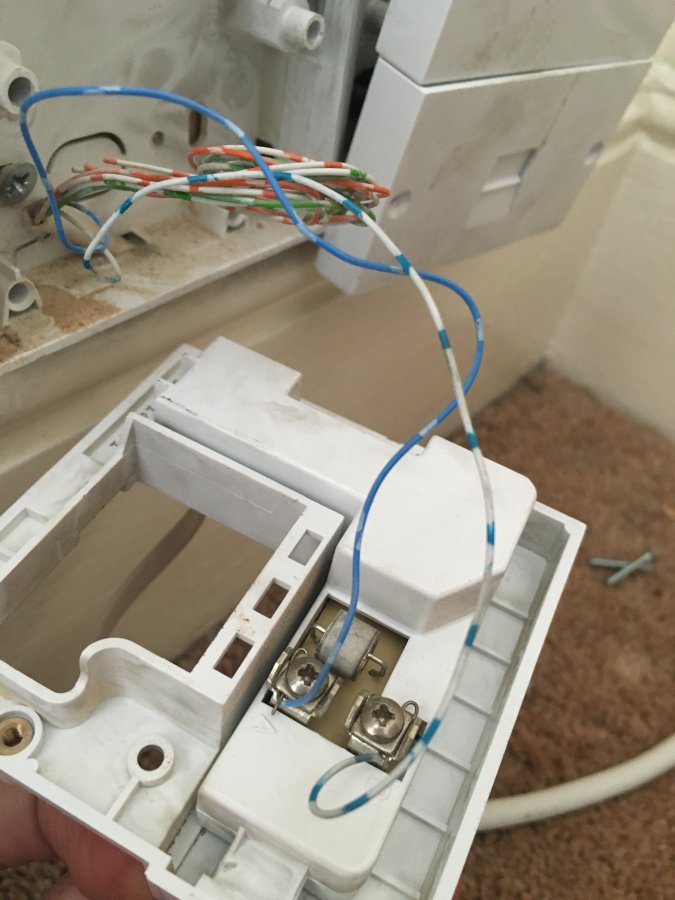

The wire that enters the wall goes into the bottom of this BT box and is connected as follows. The telephone line works perfectly from the test socket and main connection here.

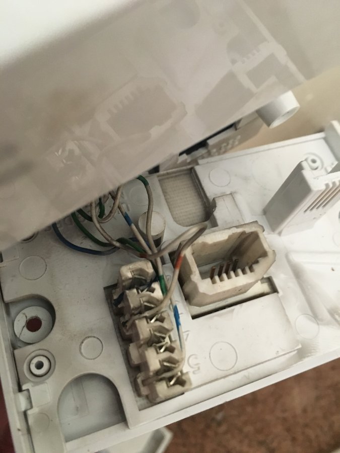

The following to pictures are from the NTL box and the wiring setup within, the phone line doesn't work at all in this socket or the test socket here.
Long and short of it ... You shouldn't have two master sockets on ONE service , looks like you have had BT and NTL ( cable ) at some point , more than likely that old twin core BT cable ( grey ) is the issue

You've got a mixture of NTL and BT sockets by the look of it, and potentially (hopefully not) the result of someone bodging the two together!
Best bet is to get a cheapo corded phone, plug it into each socket one by one, and whenever you get a dial tone, dial 17070. The TalkTalk line will read your number to you. Not sure what the NTL line will do - maybe nothing.
Once you've worked out which sockets are TalkTalk, you need to find the master, of which there should only be one. It'll be one of the ones with the split faceplate, and when you unplug the faceplate (with the wiring attached to the back), all other TalkTalk sockets in the house should stop working (edit - check that this is the case).
If you try your phone and router from the socket that's exposed behind the faceplate (known as the test socket, see http://www.exbtengineers.com/wp-content/uploads/2011/06/BT-Master-Socket-Test-300x275.jpg), and you still don't get internet, but do get the TalkTalk dial tone (dial 17070 to confirm), then you won't be subject to any charges as you've proved the fault to be at the demarcation point.
