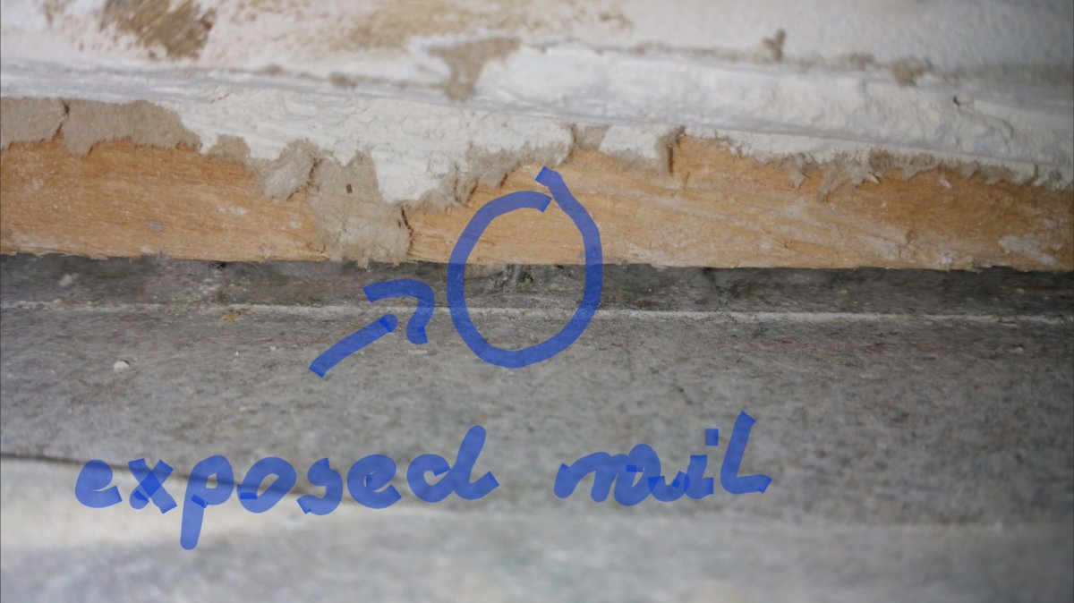

I read lots of threads about squeaky chipboard floor on this forum and today (encouraged by most suggestions) had a go at fixing it.

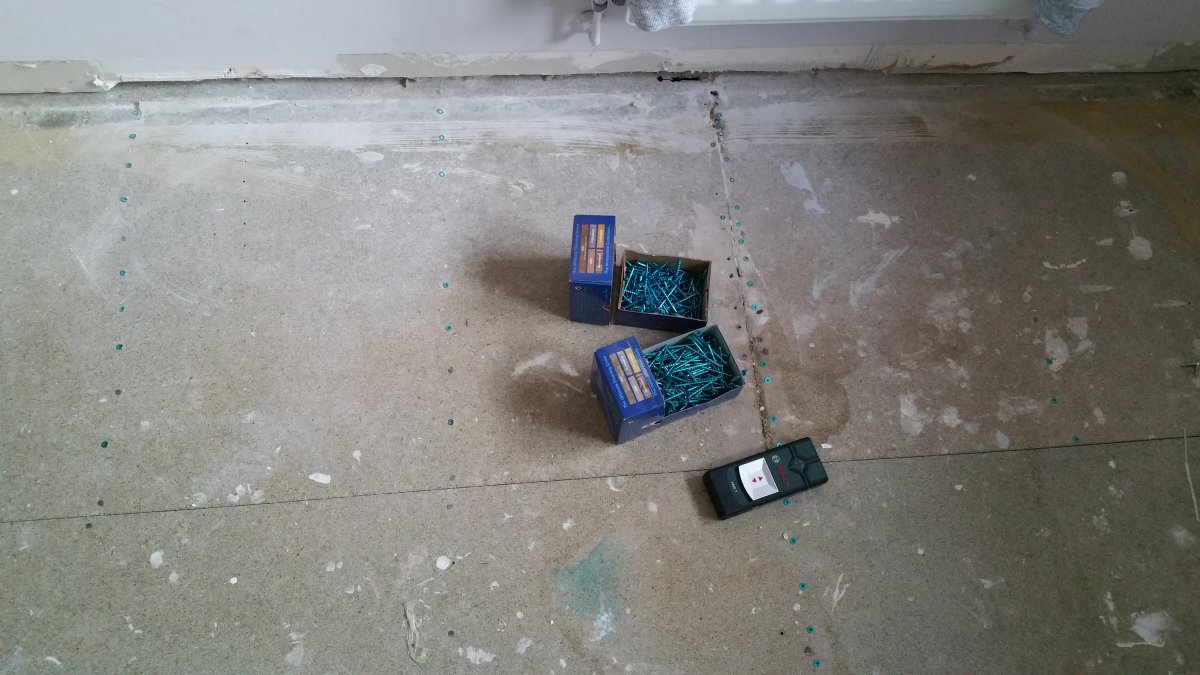

1. I bought floor - tite screws and put a lot! of them where the most noise comes from - although I saw the floor being pulled as I go , this didn't fix anything.

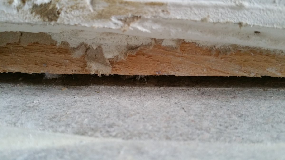

2. Took the skirting board off as the noise was coming from underneath the stud wall ( both bedrooms) and to my surprise I noticed that the whole stud frame is just hanging above the floor, there is a big gap ( 7-10mm) and in the place where it should be fixed to the floor - the nails are visible. Those nails make the nastiest squeak I've ever heard
My question is of course how to fix it , what should be done first?
Nasty squeaks have been there for years but enough is enough ☺.
I would really appreciate any ideas or suggestions. This forum has been a great help and learning curve for me so thank you in advance.

The images you have provided are very good and give a clear indication of causation, a part pulled nail will squawk something rotten!
As I see it the Plasterboard partition and associated timber frame are acting in a monocoque fashion, that is the Plasterboard and framing, the framing being fixed to the other walls and ceiling are suspending the bottom runner of the partition and stopping it from also moving downwards, following the deformation of the floor.

1. The problem is on the first floor.
2. Yes, the gap is the biggest (widest) in the centre of the room but it runs from one end to another, whole length of the wall.
3. Do I know what is underneath? If you mean the gap - there is nothing in between timber frame and t&g flooring apart from nails. However there is a radiator with one copper pipe and two grey wires running underneath. 4. The property has been built in 1997 and has original gas boiler still fitted. Hopefully due to be replaced in couple months. So to answer your question , no I don't re-charge my combi boiler.

To remove the squeak from the nails fixing the base plate in the partition to the first floor, I suggest you simply cut the nails? how? use a hack saw, but protect your hand with a very thick glove because your knuckles will scrape over the floor, Eclipse made at one time a hacksaw blade holder, even a junior hacksaw may work? if all else fails, use a thin cold chisel and knock the crap out of the nail [you will note the highly professional description of the latter?]

As for a fix, you can cut appropriately thicknesed timber about 50. mm wide by whatever thickness is needed and hammer the bits into the gap between the partition and the floor.
Hope the above will stop the squeaky problem??
