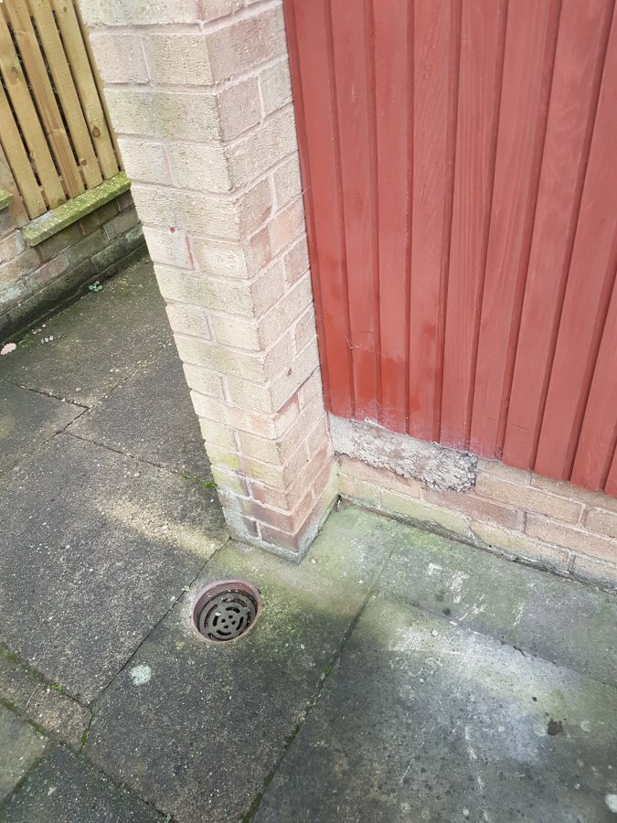

Hi All,
I'm hoping I can get some advice please.
We recently bought a bungalow (40 years old) and found that a corner bedroom had damp in the corner and going along the gable end wall. Low down and nothing above 6 inches except for the corner of the plaster that seems damp but that could be the decorators caulk I used and the emulsion has dried a different colour?

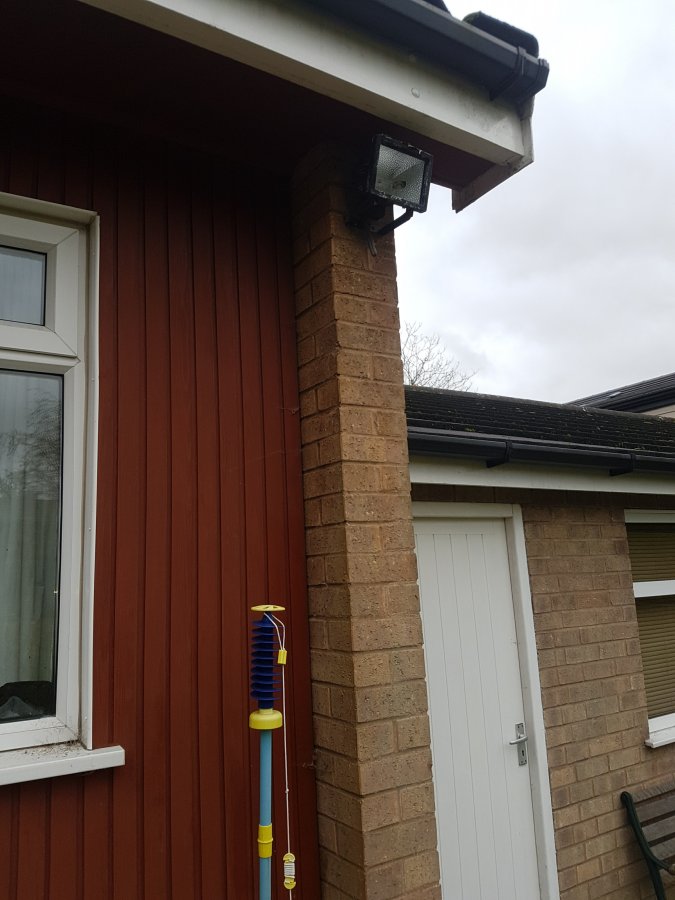

I had a look outside and the drainpipe on the corner was draining into a soak away, when I put my hand down it was full of fine roots and backed up. When I put a hose pipe in it over flowed within a few seconds.

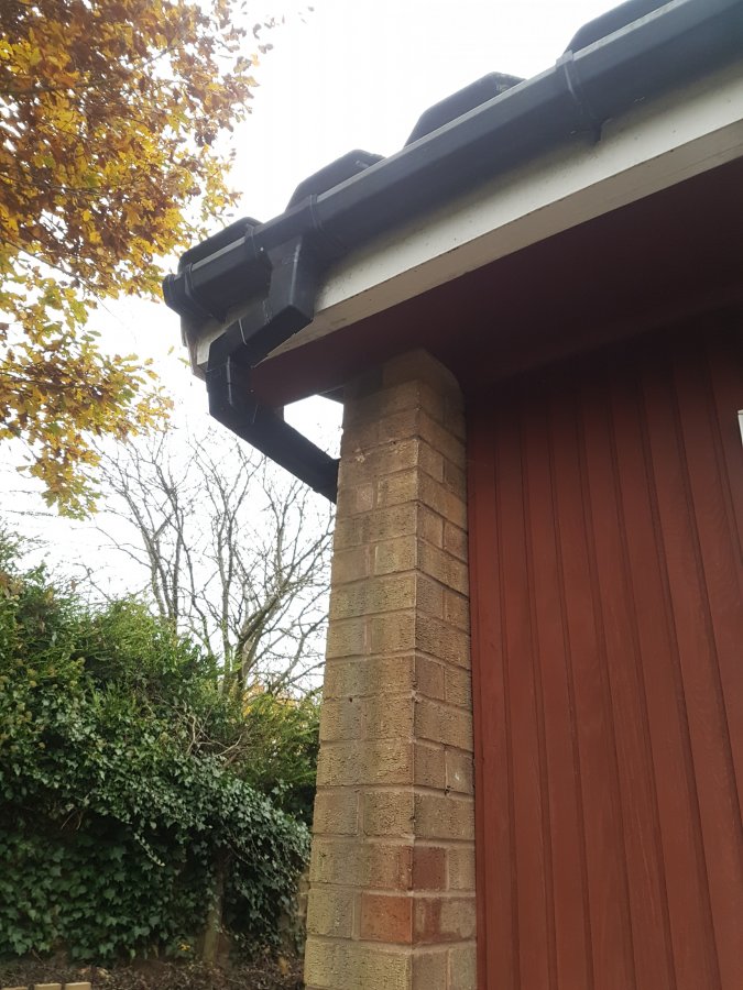

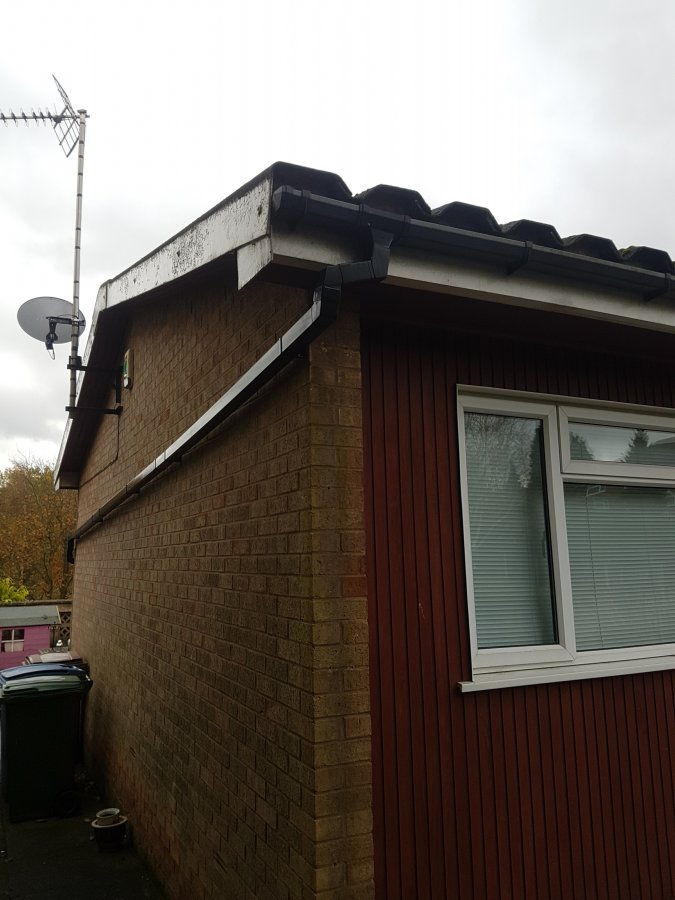

Rather than find the soak away and re-dig it I diverted the drain pipe down the gable wall to the other end of the gable and it to the other drain pipe. that one drains in to the main drain so drains fine.
I thought this would resolve the problem for us.
But, I have found that the lower wall and floor are damp again now the weather has turned cold and damp.
Lifting the carpet/underlay the floor is wet. I think its a concrete floor but hard to tell as its painted in bitumen type stuff. (maybe to try and stop this issue in the past? and it seems all the floors are painted in this stuff)
Along the lower part of the wall is cold/damp with mold on skirting's. Also noticed the other bedroom on that gable wall is wet through on the walls behind wardrobe and bed but seems better since pulling out slightly and getting more heat in the room.
So is the problem still the soak away that's filled? if so shouldn't the damp proofing stop the water getting inside?
Is it the floor membrane that's failed?
Is it the wall damp proof that's failed?
Is it a leak from above and running down inside the gable wall and then soaking the wall?

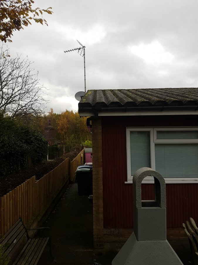

We do need to replace the roof next year as its an asbestos factory type of roof covering so needs to go, but it still looks to be in good condition and no visible cracks etc.

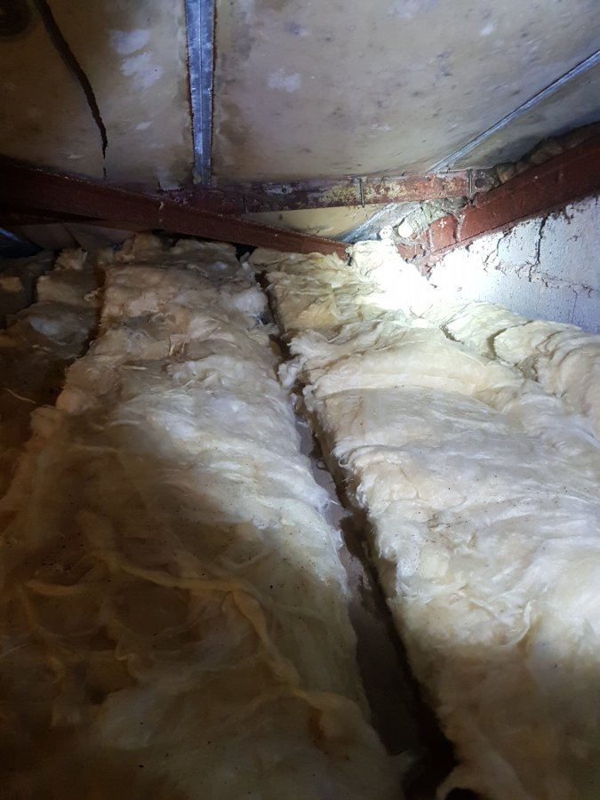

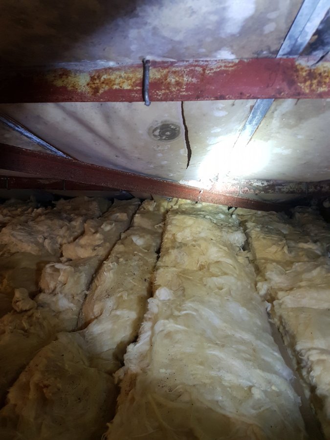

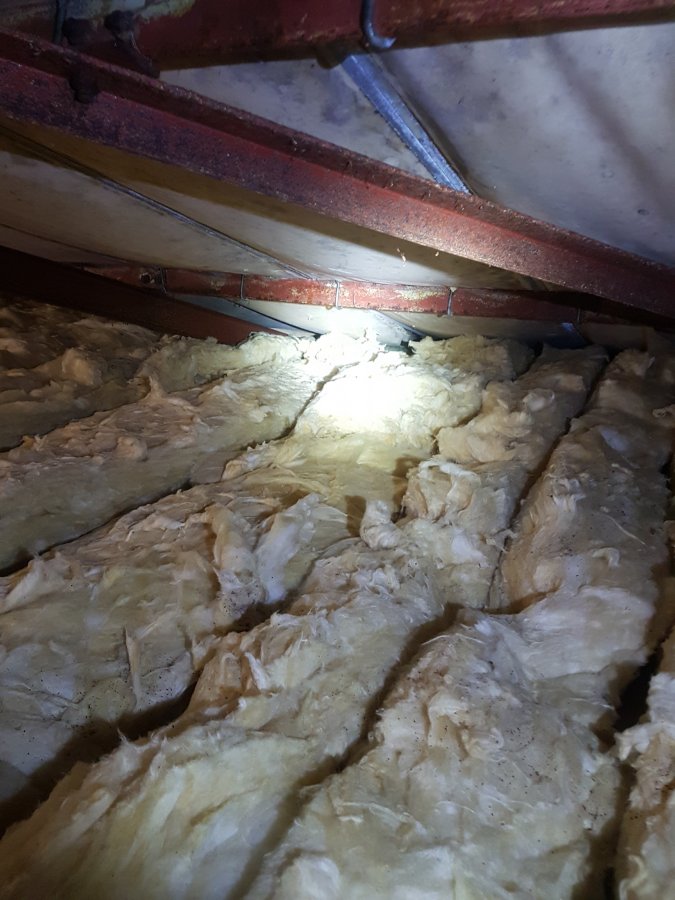

I have also been in the roof and the asbestos sheet has ceiling tiles on the underside so you cant see the asbestos sheet.
There are a few areas where the tiles are bowing and a couple cracked which looks to be damp from somewhere, be it a leak or condensation I don't know. The roof sheets don't show any signs of damage/cracks from outside though.

Ref your roof difficulties whether its "a leak or condensation" you say you "dont know" - & without photos neither do we.

20161115_112642.jpg 20161115_112657.jpg 20161115_112625.jpg20161115_112631.jpg20161115_112553.jpg20161115_112603.jpg20161115_112610.jpg20161113_185818.jpg20161113_185828.jpg20161113_185832.jpg

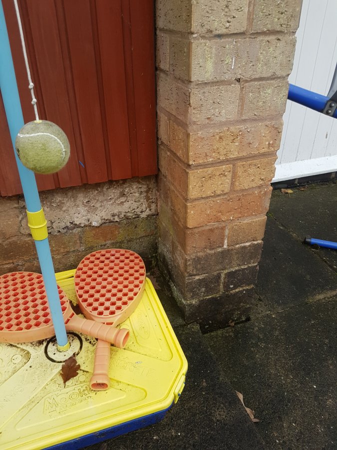

First 4 pictures show the corner which has the worst damp at floor level, Mainly along the floor on the gable wall and slight on back wall getting less away from corner.

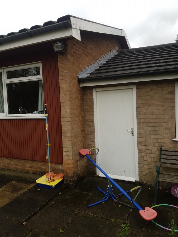

The next 3 show other corner which has a slight problem but not as bad.
The last 3 are from roof space looking at corner worst affected.
The garden does slope slightly further up the garden yes which I guess puts more water in to the soak away? but is still lower than the floor level in the bungalow. As you will see in the pictures its raised and floors are on top of a dwarf wall. Above this wall is cladding over a steel frame. front and back of bungalow are cladding over steel frame and both gables are brick, along with the dwarf wall.
I can see a DPM in the gable wall in places which seems to be around internal floor level.
I have no idea if floors have been painted in bitumen to stop issues but do wonder why? As you can see its a strange type of construction with steel frame, wood clad and light weight sheet roof. At least the garage has been done in brick and tile construction! We may as well go and live in that!
