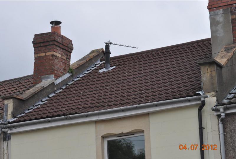

When I moved in there was water staining and damp on both chimney stacks - as seen in this image of the rear chimney stack.
I had some remedial work done to re-seat the leadwork around both chimney stacks and this seems to have largely resolved this issue. One of the roofing companies, however, mentioned that there were signs of damp on the parapet walls and proposed to hack off all the render, re-do the leadwork, apply new render and replace all the coping stones. I decided not to proceed at the time.
12 months on, the damp in the parapet wall seems to be working its way down and is emerging in the front bedroom. There is a damp patch high up the party wall, right in the corner (probably underneath the horizontal coping stone).
I'd appreciate any views on:
- Whether coping stones themselves need to be replaced;
- Whether damp could be penetrating cracks in the render on the parapet wall, and working its way down;
- Whether chimney stack and parapet wall render looks damp, or just a rich mix and whether this is an issue.

There is some vegetation growing where the parapet from the apex reaches the left hand chimney stack in picture 1. The pointing and brickwork on the hindmost part of the left front stack is very badly eroded. I would say that it needs a thorough overhaul, together with any of the adjacent coping stones and flashings.

BUT... the chimneystack on your side of the roof has been removed back to the party wall just below the tiles, it seems. It is often a problem when half a chimney is removed, and the other side belonging to the neighbour remains.
The old brickwork can harbour combustion products from years of use, such as nitrates and sulphates, which have permeated the brickwork, and create an easy route for moisture to enter the party wall, causing the sort of problem you have. The neighbour may have no problem, due to through ventilation of the flue from the rooms below. On the other hand they may have a problem they are not aware of.
You may need to prevent water ingress via your neighbour's stack, but your neighbour may not want to pay for this, or even allow you to do the necessary work at your own expense.
A good roofer will give you recommendations and a price, but you will need to involve your neighbour for the any of the party wall works to go ahead which involve their property.
Of course, notifying your neighbour may involve them in unexpected expense which may cause resentment, and even lead to a dispute, so tread carefully.

The left neighbour's front stack is obviously water damaged, and showing signs of efflorescence.
The same neighbour's rear stack chimney pot is dangerously leaning - according to the pic.

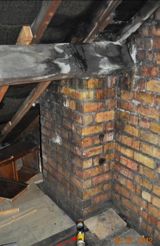

Your rear loft pic shows amateur rafter repairs, and active leaks in the roofing and at the chimney breast.
Do you have, or have you had, chimney breasts on the left party wall?
Flashing is lacking on your stacks where the render meets the coping stones. Plus the render should have been bell cast and stopped short of touching the coping stones.
Presumably the render was a remedial application rather than a possible stack(s) re-build.
Its hard to comment on the copings and parapet render - the pics need detail. Flat coping's are always suspect. Are the flags throated?
Your front fascia appears to be "rotting". The rear gutter union is dipping and will hold water/debris.
The front elevation render has stonework(?) grid pattern beds grinning through.
Looking at the interior picture the water ingress is more than likely due to the back of the chimney where the vegetations growing.
The loft interior pic is of "the rear chimney stack" (sic).
In other words, the left hand stack in pic 3.
Awrite yanky! The vegetations not good though is it. And efflorecense is nout to do with water damage.
The immediate water ingress issue is in the front bedroom on the right hand party wall, some distance from the chimney stacks - hence the suggested diagnosis of an issue with the coping stones or render on the parapet wall.

Well ree, its just aswell im not paid to spell isnt it. By the look of it the vegetation is growing out a non exististent piece of lead where the coping stones meets the back of the chimney. Which isnt technically a back gutter now is it? And effloresence is water and salts read up on google it isnt as you say guaranteed water damage! As for smoking the vegetation I suggest you start! Maybe chill you out a bit! :rolleyes:

You dont know if the back gutter lead is present or absent, neither can you see if the coping stones stop short of the stack or butt up to it. If they would fix a front lead apron why would they leave out the back gutter?
Given that vegetation on the back gutter would be a possible source for water entry - a possibility.
The facts are that we can clearly see water stains and efflorescence higher up on the stack, these must be derived from water damage in the stack - a certainty.
