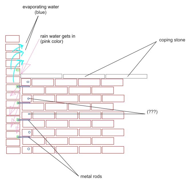

The darker brickwork above the external boundary wall seems to indicate water running vertically down the wall - which could be saturating the brickwork and tracking across where the wall meets the main house
Could also be to do with the junction of the wall with the main house
A drill hole is not likely the be the cause
You can get some water proofer for the brickwork but it may need more than that, what is the small wall is it the party wall
go with roofers mastic around coping stone and corner where walls joints together, next spray (using ordinary plant sprayer) patch of both walls- 1.5m each way from the center of damage spot- with thompson one coat wall seal- this will solve your problem.
Hole in the brick had nothing to do with damp on your wall- I am sure

I have an idea:
boundary wall has been added some time after your building was ready, so to join the wall with the building bricklayer had to use a type of locks to prevent from falling it down- they drill a hole on the ready wall and when laying additional one they inserting metal rods into them which goes between new bricks (otherwise they can dig out brick from existing wall and insert brick from fresh wall)
Coping stone never let the water seep trough- only joints can do, in this case looks like connection between 2 walls isn't sealed properly so water gets in and next trough the locks into the main wall (see the picture)
even your gutter is leaking and you will do repairs as I have advised in my previous replay/post – this will do the work
My only concerns is- where are from those extra holes on garden wall (with wall plugs?) ? first thought- maybe fixing from the garden trellis? (but too many for that)
wall seal is clear, goes into the bricks as a water, is dry in appx 2h, is not visible till rainy weather- untreated wall will get wet (change the colour to darker) but treated part will remain dry
let me know if that's make any sense for you
