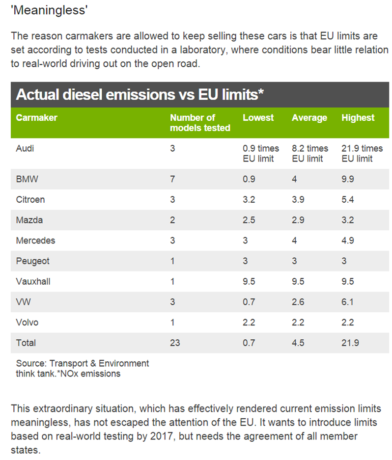

More from http://www.bbc.com/news/business-33254803

Yes, it's driving the car manufacturers nuts at present. The problem with the current test is that it was set up to be easily repeatable in a lab. Every vehicle does the same drive cycle. That means the low-powered vehicles like a Fiat Panda, would be nearly foot-to-the-floor on the acceleration parts of the drive cycle in order to follow it, whereas a Ferrari could do most of it at tickover or very tiny throttle openings. Obviously, human nature being what it is, nobody buys a Ferrari to drive it like a Panda! Over the years, manufacturers have got very good at "optimising" their vehicles to do well in the official test. Outside that envelope, they can be much worse, as those figures show. The downside of "real world" testing is the lack of repeatability and the big variability in results that you naturally get. For example, cars tested in the French Alps will be driving at higher altitude than most labs - and driving up steeper slopes. Cars tested near big cities will also be subject to hue variations, depending on whether they run into standing traffic or not. In order to pretty much guarantee that ANY vehicle taken at random could meet the emissions requirements at ANY time under ANY conditions, we're likely to see massive increases in AdBlue reservoir sizes on diesels and added emissions control equipment on petrols. I agree something is necessary to improve air quality, but I'm not sure this is the right way to go about it.
