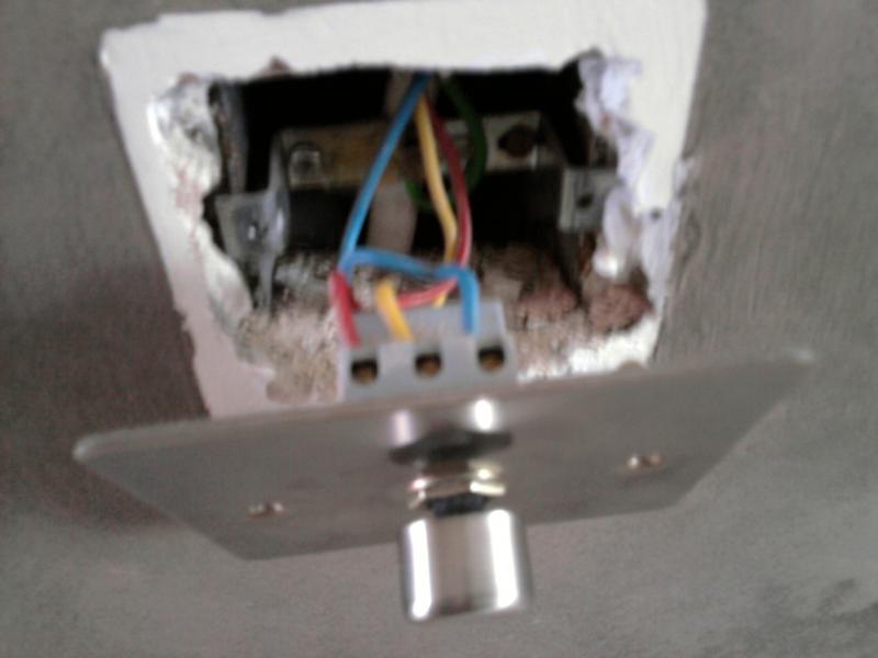

I have a hallway light that has stopped working. It works off of 2 switches, a single dimmer downstairs and a double dimmer upstairs (with the other switch controlling the landing light)
I removed the single dimmer switch downstairs and replaced it with another dimmer switch from the bedroom and all worked fine, so I assumed it was the dimmer switch and have bought a new one. The markings are slightly different but I wired it up as the previous switch:
Old single dimmer switch:
Red - squiggle with an arrow through
Yellow - L2
Blue - L1
Upstairs double dimmer:
Yellow - L2
Blue - L1

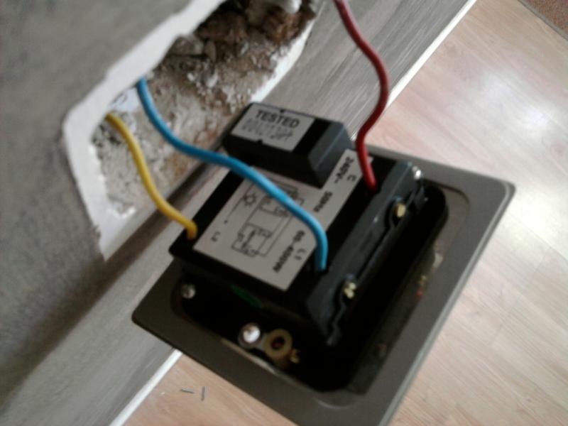

New single dimmer switch:
Red - C
Yellow - L2
Blue L1
But when I put the power back on it didn't work, have I done something wrong? Is there another problem?

Ah!!!! Just had a 'fiddle' (with the lights!) maybe I had the dimmer all the way down upstairs when i turned the power on... MAYBE! Anyway the light comes on now but it's really flickering when you dim it.
I usually leave the dimmer turned up full upstairs and just use the downstairs dimmer to dim the light but as I say it's just flickering now. Only when you turn it up full and then back a little will it light constantly without flickering (looks like on full output), ideas?
OK so to check the one that I thought was broken I wired it in upstairs in the bedroom and it didn't work which confirms it's broken.
Wired the new dimmer into the bedroom and it works fine with no flickering (single switch in room)
Just for the hell of it I wired the dimmer from the bedroom into the downstairs hallway and it works fine with no flickering...
So how's that then?
Leading edge switching, trailing edge switching etc etc etc. There's that many variables that it is impossible to say.
Fact is, as Securespark said above, you are not meant to have two normal dimmers controlling the same light. If it works it is a fluke.
It is possible to have master-slave setups which are meant for two way switching.

Personally speaking I wouldn't let dimmers go anywhere near the stairs/landing area - but if you insist then if you have a single gang 2 way switch then replace it with a single gang 2 way dimmer.
