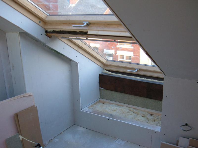

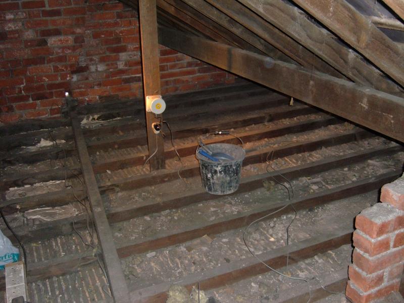

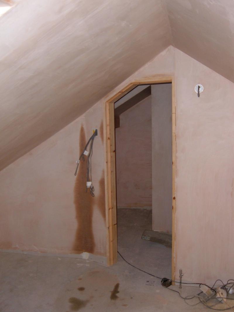

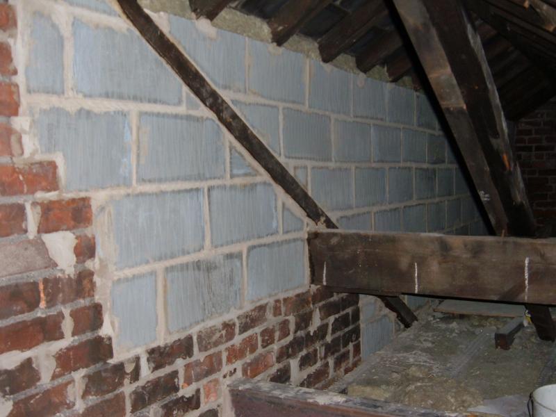

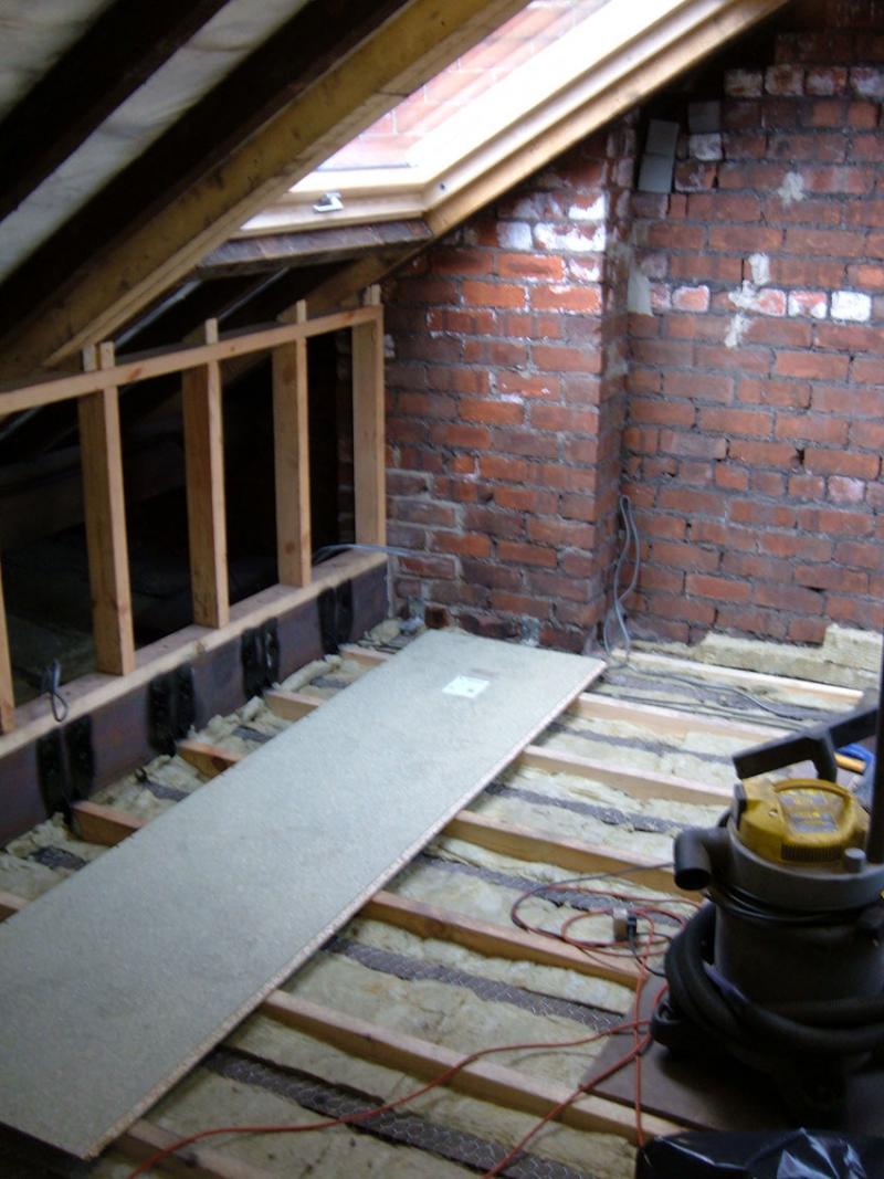

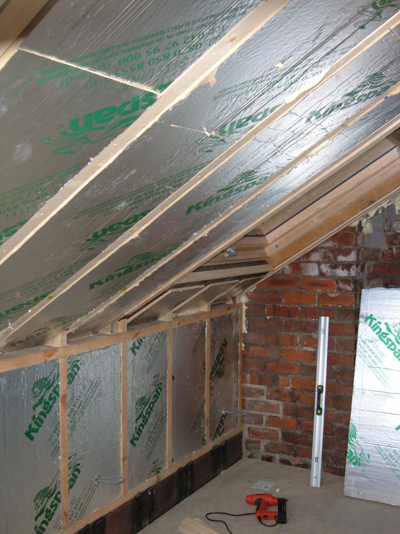

Its taken some doing but I've nearly finished. From planing through to almost completion all DIY. Apart from Velux fitting and steels, done with the re-roof, plaster skim and Electrics for certificate.
I've just got the banisters to fit before final BC inspection
Some pictures at various stages, I've covered the build in detail on my blog http://roomuptop.blogspot.com/

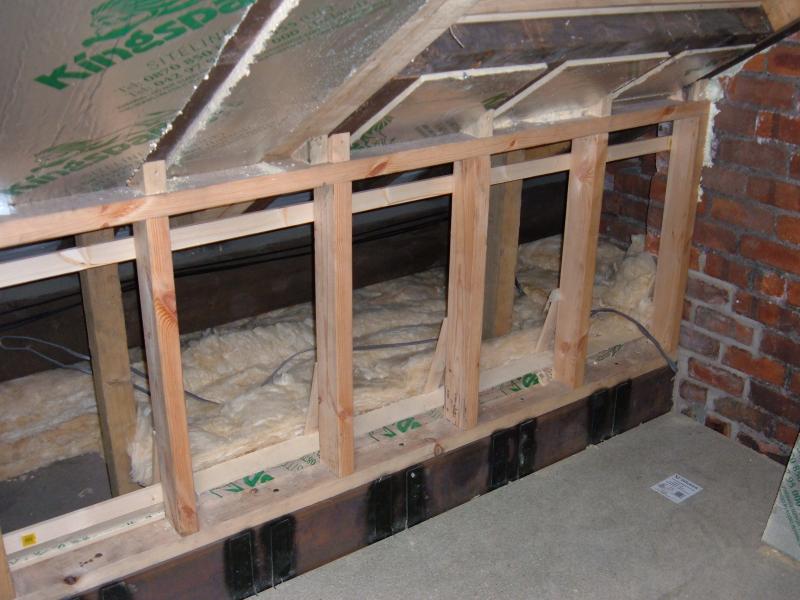

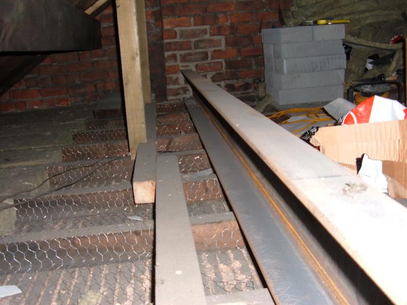

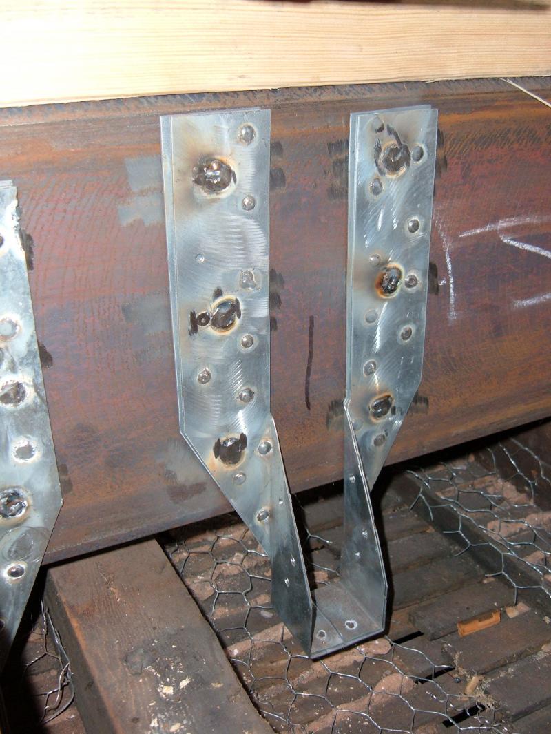

Interesting with the steelwork - I never thought of having the steels above the joists they support. But with the joist hangers its a good solution for this application. Nice.
Hi Steve,
I needed to gain as much head height as I could, the joists are only 100mm. The hanger I doubled up welded together then welded to the beam. Unconventional but effective.

Yes , first inspection. The span is only about 2m on to supporting wall in the middle, SE calcs say its OK, BC SE agreed, inspector poked his nose up saw I was working to plan and gave the OK.

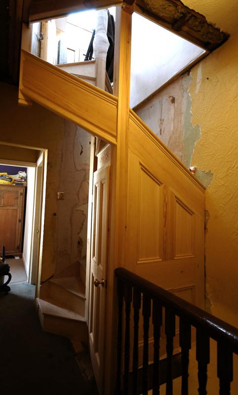

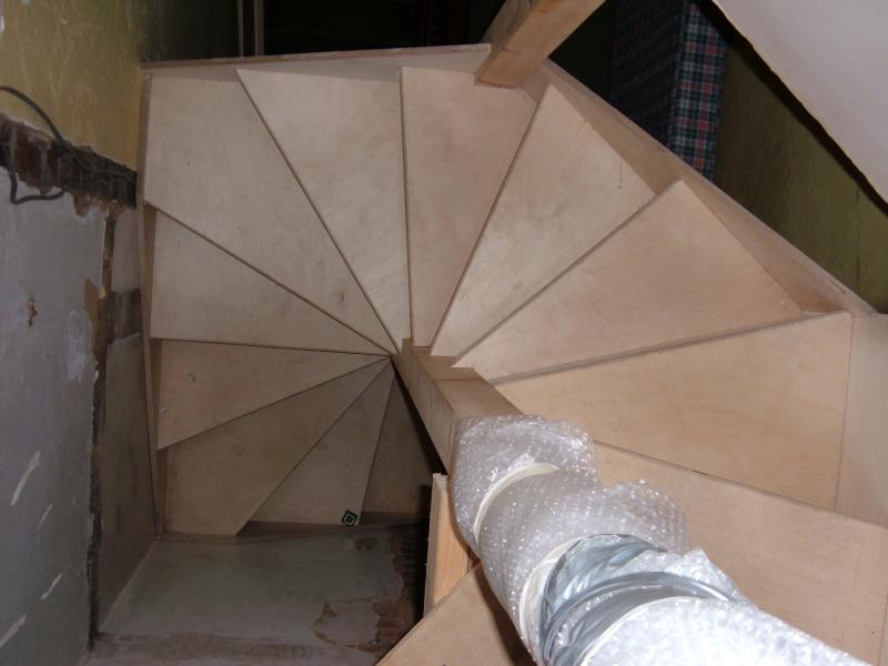

Agbagb - i'm currently about 3/4 of the way into a DIY loft coversion - we're just starting to plasterboard out the two rooms in the loft. We've also had to move the existing staircase and rear external door to comply with fire escape regs so there is only one room in the house that has escaped a re-design of some description! Its been a long hard slog and i've only really had weekends and the odd week-day night to get on with it. Hoping to get one room in the loft finished before Christmas! Is that you 'turning' the newel for the stairs - they look great!

Hi Andrew,
Yes that's me turning newel.
